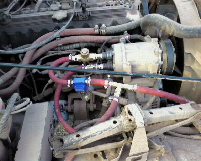

how well does this type of oiler work? and how often will i have to fill it up?
any answers to this... i have the same type of oiler.. my pic ^^^^^

post #173 of 297 Old 01-26-2010, 09:48 PM
mine seemed to work well... filled it about once every maybe hour or so of actual time on the compressor.. i dont know hard to be exact just check it every so often..
