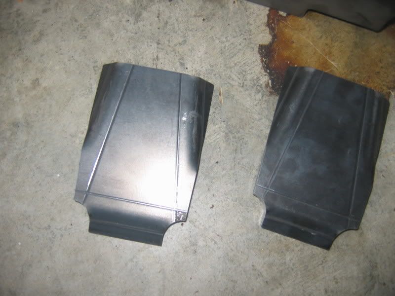

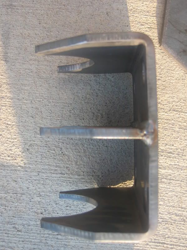

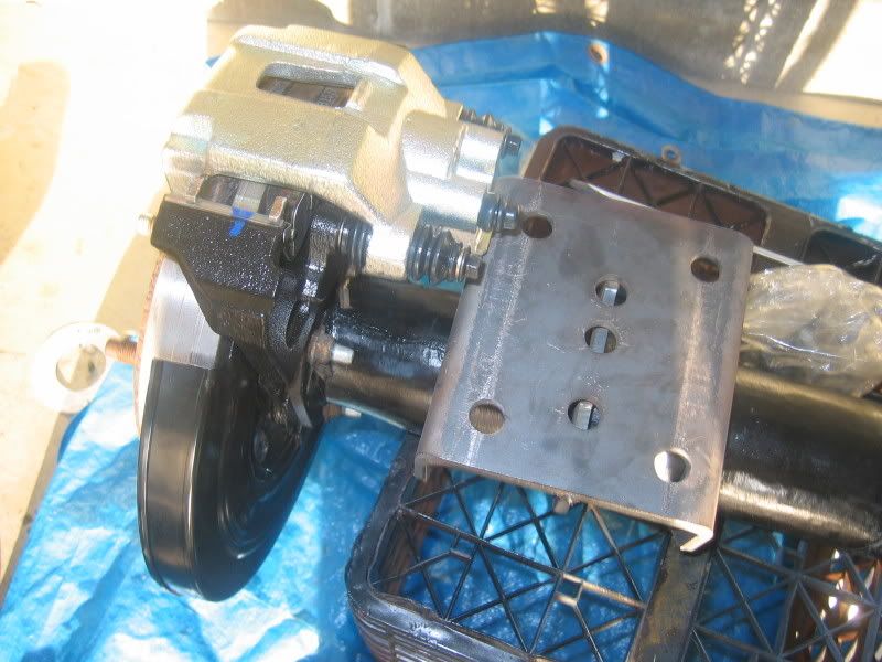

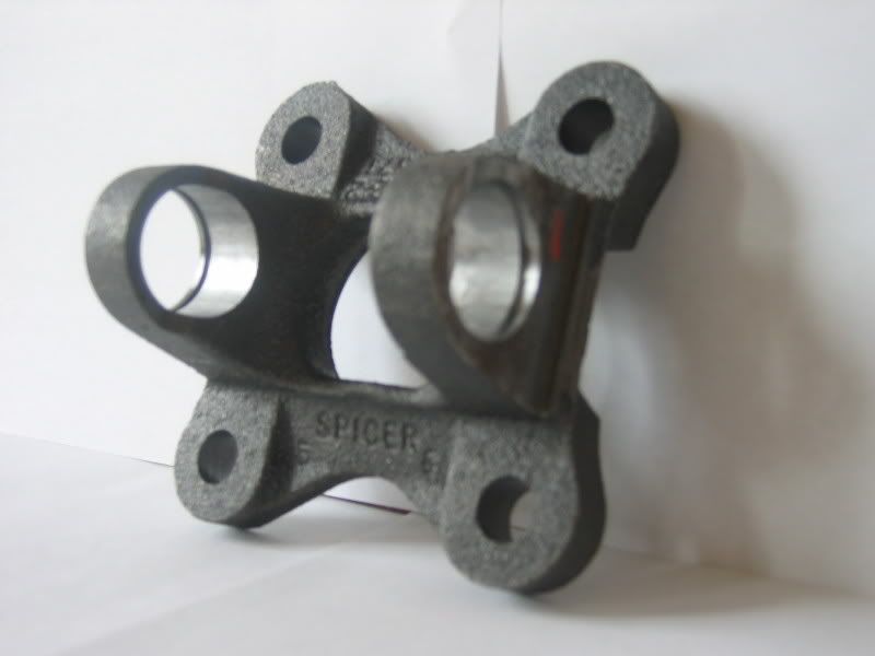

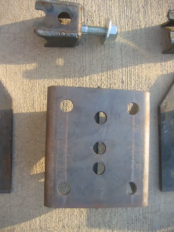

a couple of updates on what ive done
first, i got the disc brakes, backing plates, and calipers all on
then i received the MORE Flange Adapter for the 1310 Ujoints on the CV Driveshaft
i ordered the UBEs (1" variety) and they came in today, and at first glance, they are mighty beefy (1/4" thick and welded strongly
they came with weld on shock mounts as well (high clearance)
the top plate of the UBE acts like a bumpstop which i did not know, and seems like a very well designed product
pics
top plate (bumpstop)
little brother holding it up, showing how big they are
shock mount
and how the axle looks now (ube's not welded as of now, just sitting on the tubes to show the size)
updates to come as stuff comes in

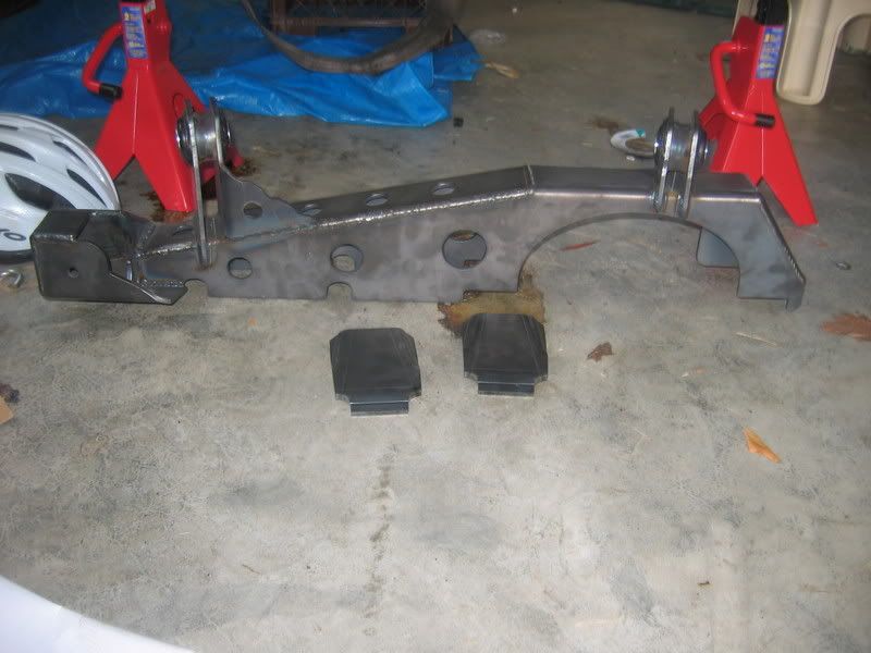

Old 10-01-2007, 04:19 PM   #71
bmyohn
Youngin'
bmyohn's Avatar
2001 XJ Cherokee
Location: Bloomington, Indiana
Posts: 4,694

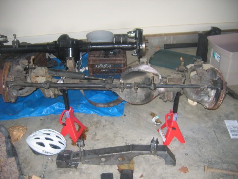

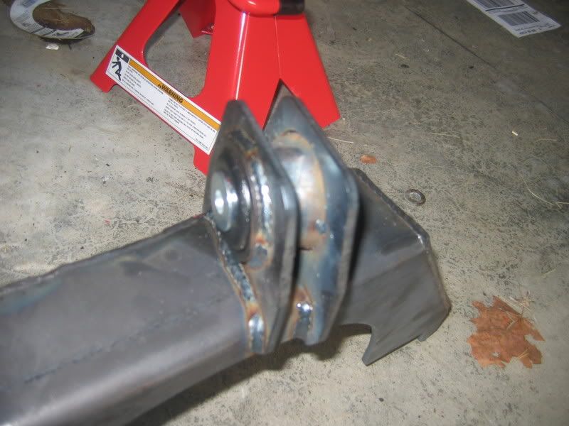

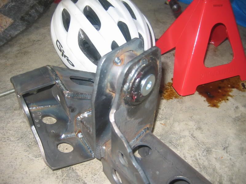

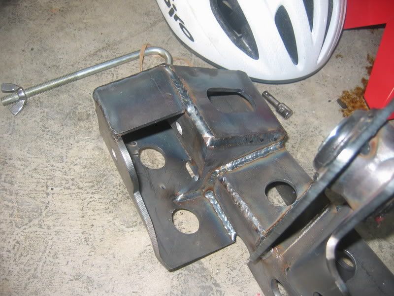

just some updates
JKS Miniskids
HP D30 out of a 95
TnT Customs D30 Truss with Raised UCA mounts and Trac Bar mounts

Old 10-01-2007, 04:29 PM   #72
balloo93
Little Red Menace
balloo93's Avatar
1993 XJ Cherokee
Join Date: Aug 2002
Location: Austin, TX
Posts: 21,013
Looks real good man. You have a trac bar for the front yet? I've heard if you aren't running a short enough one you will need it recut and tapped with the raised mount.

Old 10-01-2007, 04:32 PM   #73
bmyohn
Youngin'
bmyohn's Avatar
2001 XJ Cherokee
Posts: 4,694
im gonna be running a custom made trac bar by TnT when i order there kit
so im asumming that they have a way to calculate what type i need
Jason told me that i need a straight trac bar and that they will make it the correct way when i order it

Old 10-01-2007, 04:37 PM   #74
balloo93
Little Red Menace
balloo93's Avatar
1993 XJ Cherokee
Join Date: Aug 2002
Posts: 21,013
Sounds good.
I bought the same JKS skids, just didn't have time to get them welded up. I REALLY wish I did as the brackets to a few hits this past weekend.

Old 10-01-2007, 04:44 PM   #75
bmyohn
Youngin'
bmyohn's Avatar
2001 XJ Cherokee
Posts: 4,694
yeah, i know what u mean, i didnt realize how vulnerable those LCA mounts are until i took a look at the HP D30 that i have in the garage, for 25 bucks, they are definetly worth it
