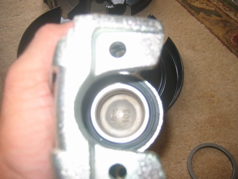

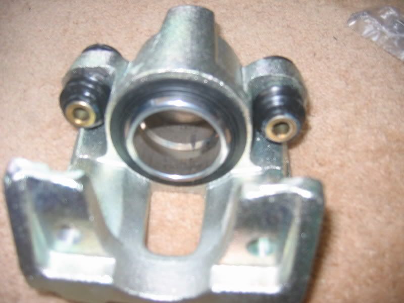

i picked up a set of Ford Racing Disc Brake (like the link Timo gave me)
there were no instructions that came with it, so i was wondering if you guys could point me in the right direction
here are the calipers, they have a hole in the center of them, i have never looked at a set of calipers before

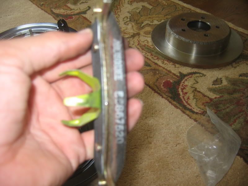

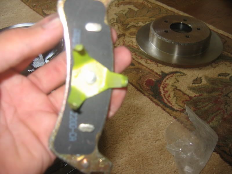

there are different brake pads, on set has a metal clip across the back of it, and the other has a green claw type thing, what do i do with those

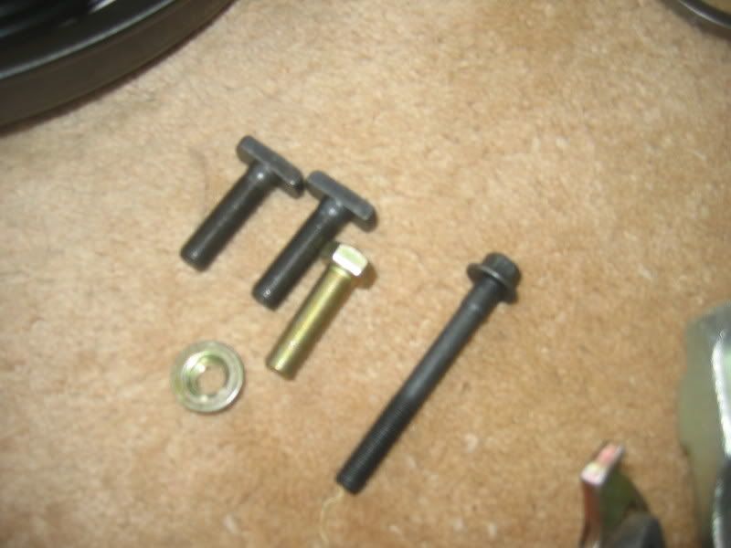

there are also assorted bolts, weird ones, they have rectangular tops, there are two different lengths of those kinds, and there are also gold bolts that have a hex head and matching nuts
there are also silver spacer-type things that fit inside the backing plate center hole, but im not sure what they do
can anyone help me out??
