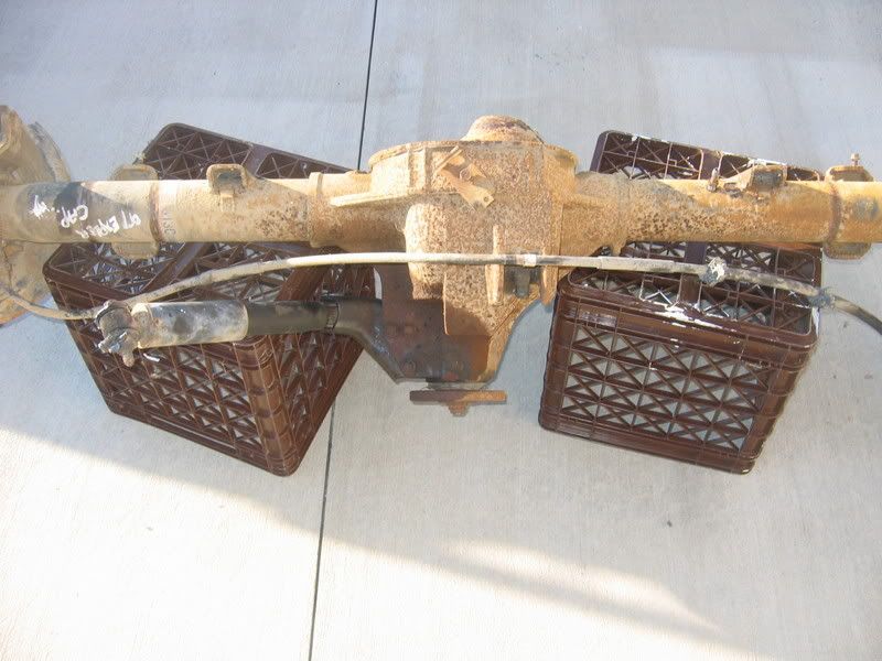

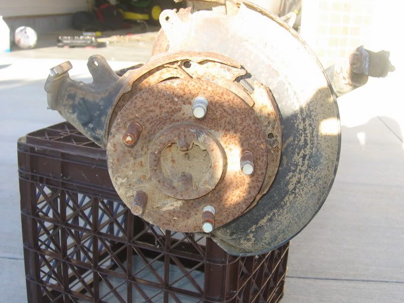

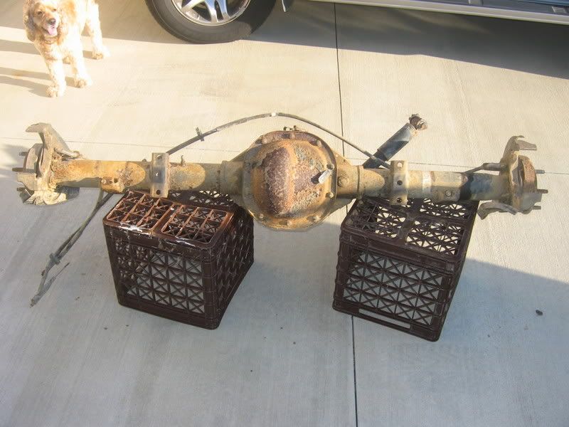

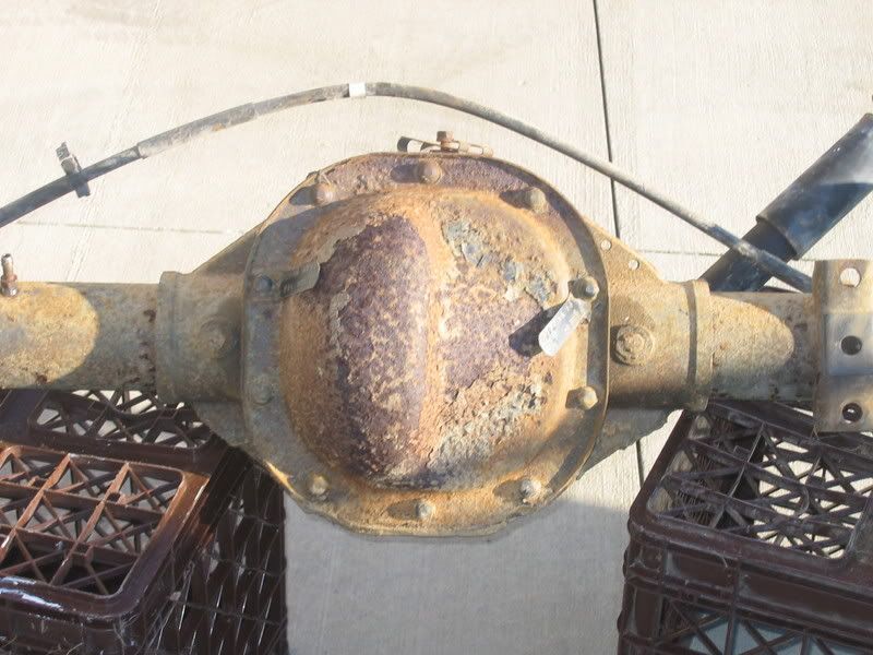

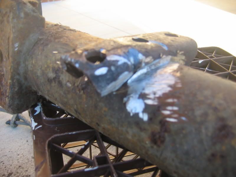

here are some pics of the axle i picked up today for $106 (the first place i went to wanted the same axle (little better shape) for $850..lol)
my axle
pumpkin
bent backing plate
my attempt at grinding off the bracket for the sway bar
any tips on grinding off these brackets??

I used a 4 1/2" angle grinder with a cut-off wheel. Worked like butta. Be careful not to get into the tube. If you do, (and you will) just fill it in with a bead from the welder.

okay, so if i do cut through the tube, its not too big of a deal, i can fill it with a bead from the welder
ill try that tomorrow, i have whatever wheels the grinder came with, im not sure if they are cut-off wheels or not, ill have to check on that
do i just cut down the weld or do i cut the bracket somehow??

what should i do about the backing plates that are bent??

Yes and no. Why using longer soft line and a weird location for the hard line split-block, if you can use stock Jeep location with stock Jeep parts?
JY axle.. there's a good chance especially the softlines are not in good condition. Hardlines (copper braketube) doesn't cost a fortune; if you're spending money on locker, gears etc., adding another 10-15$ for the hardlines isn't gonna get you bankcrupt.
Like I wrote, get a breather hose/split block mounting screw from a D35, it's a direct fit. Get a longer soft line (ie. YJ) to go with your future lift. Get copper tube and cut/bend new hardlines and flare them. A shop can do the flares if you don't have equipment. Shouldn't cost much at all.
Hale
You won't cut into the tubes if you cut the brackets carefully. 4½" grinder with a cut-off wheel is a perfect size. 40-grit grinding disc comes in handy too.
Do it this way:
1. Start by cutting the top or middle sections (however you wanna call 'em) off from the brackets.
2. After that, it is much easier to cut the sides of the brakets because you can see on both sides where you're cutting. And you have much less to cut too. So it's more accurate.
3. Don't try cutting the brackets off to the tube with the cut-off disc. Leave some metal on the tubes (1/16th-1/8th inch).
4. Take a 40-grit grinding/sanding wheel and grind the rest of the metal off the tubes.
5. End result should be that you have smooth-as-baby-butt axle tubes shining on bare metal, without any nicks or cuts on the tubes.
It does take a bit longer this way, but you won't need to worry about cuts on the tubes this way. And as weird as it sounds, I promise you won't go through as many cutting discs
