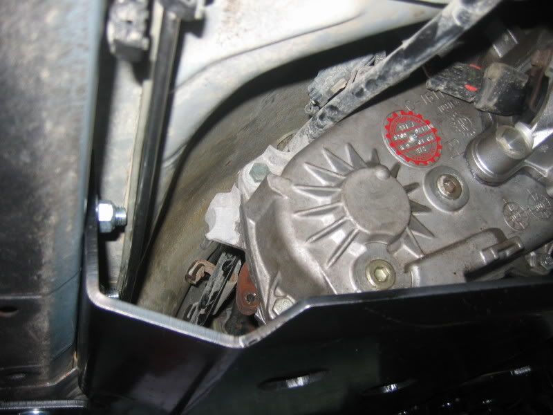

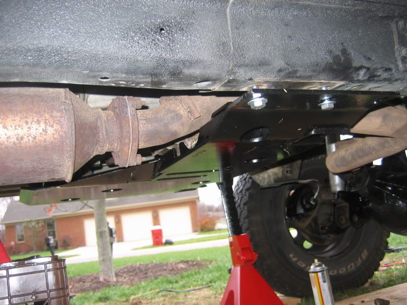

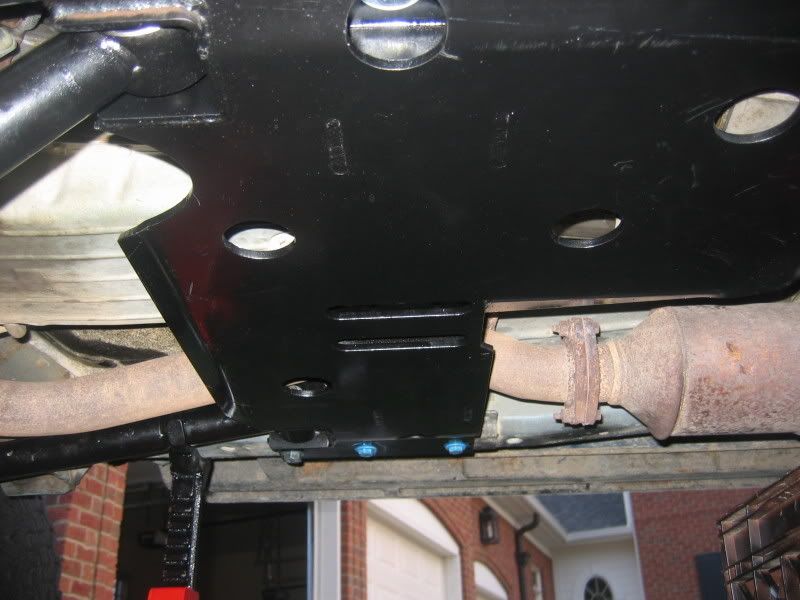

i got the belly pan bolted up, but it started to sleet/snow so i stopped for the day (plus its almost turkey time)
i have to mark where to drill next, but this is as far as i have gotten for the day
tucks up really nicely against the 231
That belly pan sure is sweet, makes me want to get long arms right now! That sucks about the snow, I was welding up some rock sliders in a short sleeve shirt today. Keep up the good work man.
thanks, ill try to get it done tomorrow if the weather cooperates
this belly pan is probably 60lbs, it definetly takes two people to hold it up and line everything up correctly, so if u dont have a person willing to work in the cold, it doesnt work so well...lol

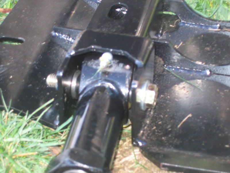

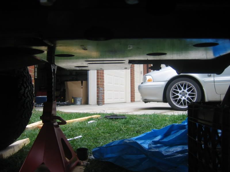

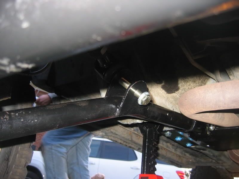

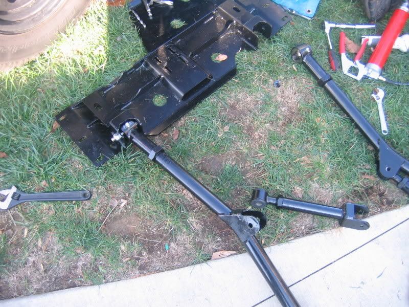

im almost there...i hope
here is what i got done today
(the passenger side went much better then the driver side)
i just need to get all four of the tranny bolts in, get the UCAs mounted and the driver side LCA (lost the nut so i had to go to the store and get another one), i have to bleed the brakes, get the trac bar on, and do the rear shackles

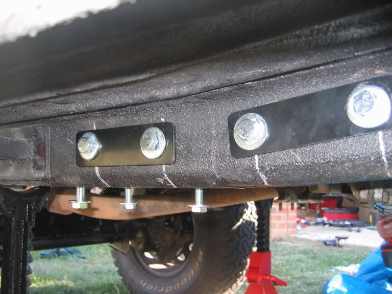

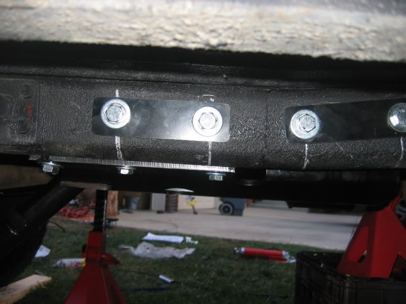

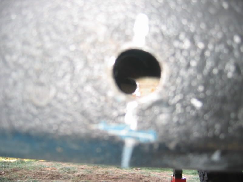

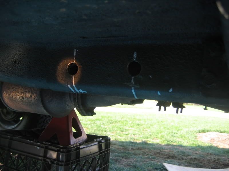

a lesson i learned drilling all the holes, was start from the outside and mark the centers of the holes u need to drill, i started with a 1/4" and worked my way up to 13/16". Then i used a 3/4" hole saw to cut the interior supports. From the inside we used the smallest bit we could find to start the hole (kept the bit from walking as much as possible). we then worked our way up to the 1/2" that TnT reccomends. We did this on the passenger side, the driver side we did first and it didnt turn out as well, it took some drilling and filing to get the bolts to slide through.
so thats my biggest tip for installing this thing, also take ur time and dont rush!!!
