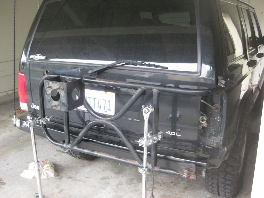

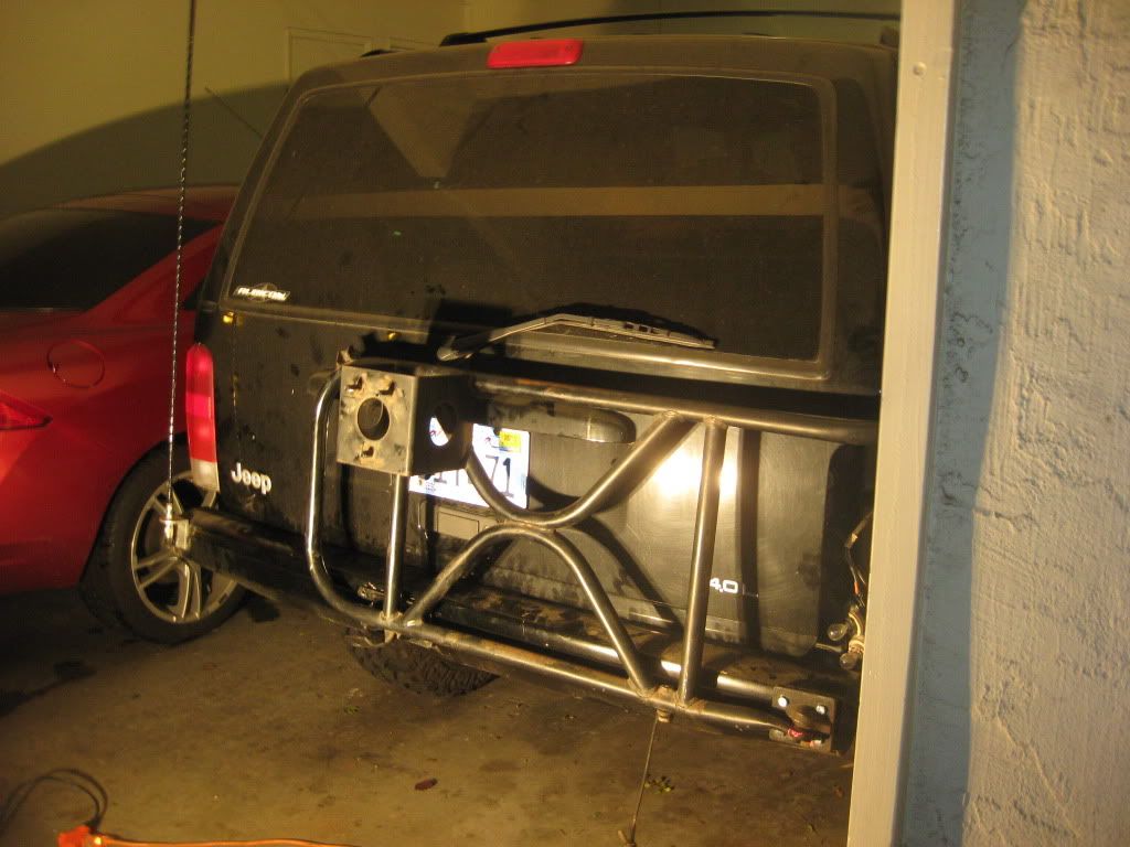

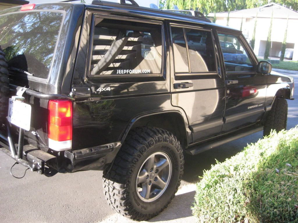

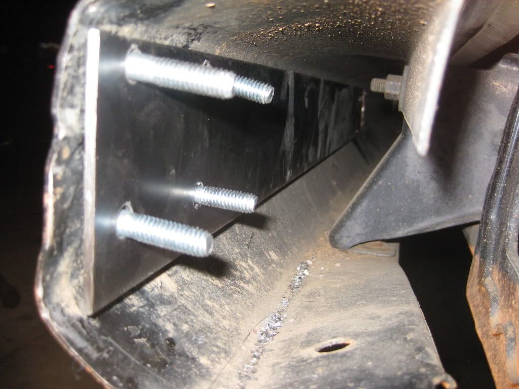

Made progress on the tire carrier. It's the old AMC style from 84-91, picked it up from pick N pull for $17 or so. I didn't have a drill with me at the junkyard so I wasn't able to get the internal bracing for the rear quarter panel and bumper. I made my own out of some 3/16" flat stock. I may do more later, depending on how this does. Still gotta paint it and trim down one of the braces because I cut it too long.
Here's my method for positioning the carrier where I wanted it before any holes had been drilled. Didn't have an extra set of hands, but I do have plenty of cymbal stands with clamps being that I'm a drummer. Worked pretty well.
in position
template for the bumper latch cutout
kids, this is what happens when you don't use protection!:banghead:
here is the brace for the bumper. It goes from the passenger side lower hinge across to the middle and catches the right two bolts for the latch bracket. About 30" long and 2" wide, 3/16" thick. It connects the 4 bolts for the lower right hinge to the right 2 bolts for the latch bracket.
The left 2 bolts for the latch bracket have their own backing plate made out of the same flat stock (2"x5"). I may extend this to the left end of the bumper and bolt through where I have my CB antenna mount. I need more metal to do that, though.
Sorry I don't have better pictures. I was focused on what I was doing, and it was getting late.
mocked up
Will be done tomorrow.

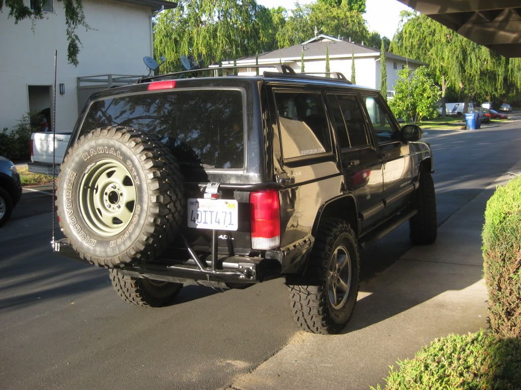

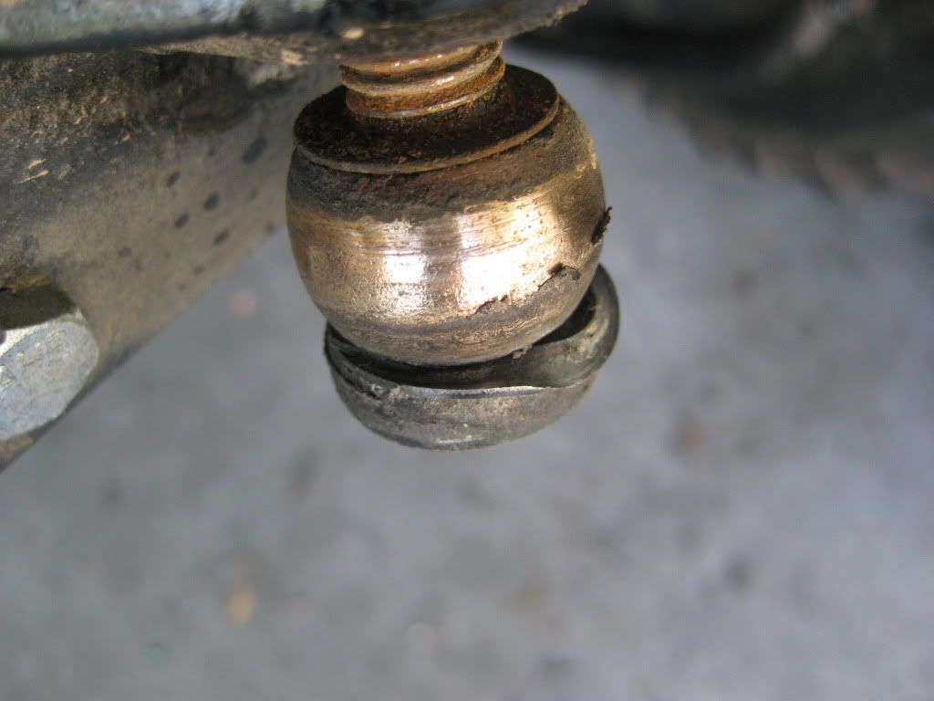

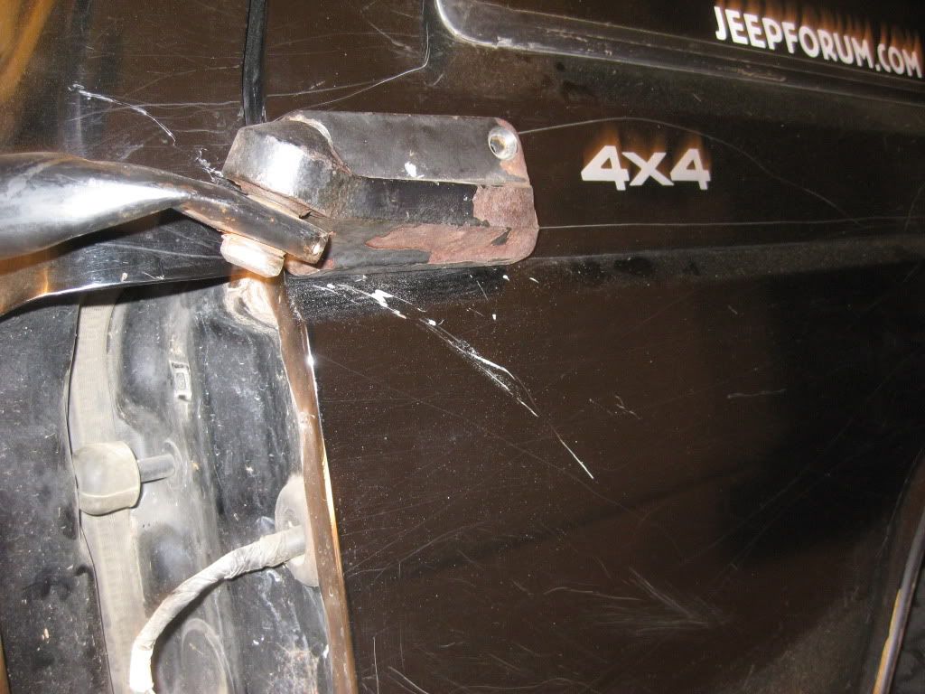

Posts: 1,181
Tire Carrier Done
Time for some updates. I did finally get my tire carrier finished and working, but not before a good amount of expletives. Took it wheeling after the install, and had no problems at all. I watched it carefully in the rearview mirror to see if it moved, and there wasn't really any play so I was pleased.
Fast forward to the trip home... I hadn't located the stop-cable in the right hole in the bumper, and while reconnecting my sway bar, the tire carrier swung all the way around towards the passenger front corner and caved in the quarter panel. :
As I was trying to close it, the ball-hinges gave out and the whole damn thing fell off onto the side of the road. I was very tempted to leave it there. : :
Turns out the hinges were worn, and someone had put some flimsy washers under them to hold the carrier arm on. When I was feeling less angry, I replaced them with some larger, stronger washers and pushed out the dent. Also had to grind at the bumper latch a bit to get it to open and close smoothly, but now I'm glad to say that it is fully functional and not a PITA to get in to the trunk at all.
on and fixed:

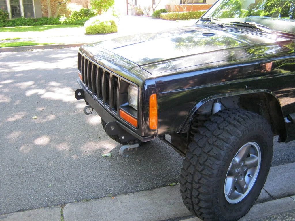

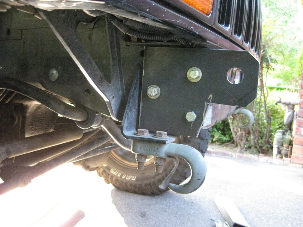

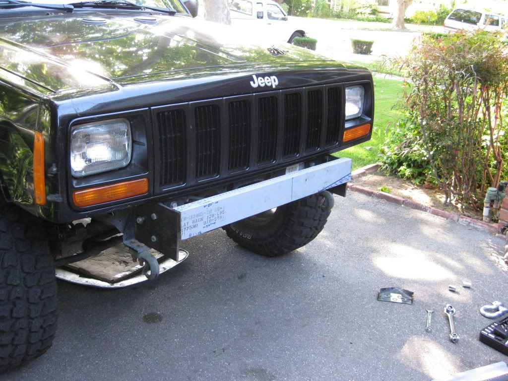

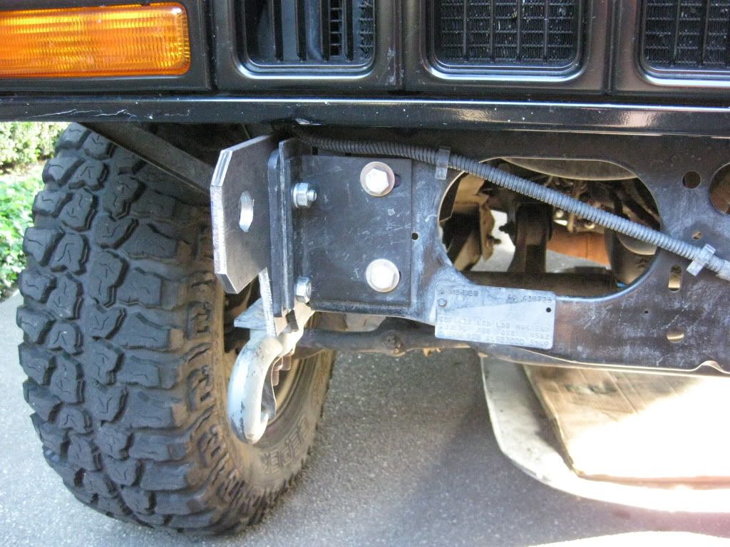

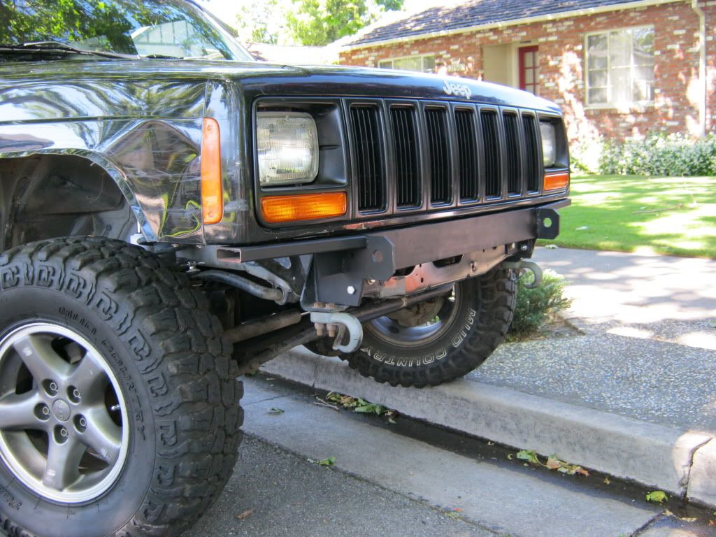

Front Bumper Done
Finished my front bumper as well. All I have to do is put some caps on the ends for cosmetics, but it's strong and high clearance, which is what I was going for.
Uses the C4x4 1/4" thick tow hook brackets and it's own 1/4" mounting brackets. The C4x4 brackets use a total of 6 bolts per side, and I won't be doing any winching off of this bumper.
Center section is 1/4" 1.5 x 3.5 Angle with a thickened lip.
The "wings" on the outside of the center section are 1x4 rect. tubing and are gussetted to the brackets and angled 5 degrees back to follow the curve of the grill.
Mocked up:
Welded & ready for paint:
Most of the critical welding was done by my buddy who was letting me use his garage.

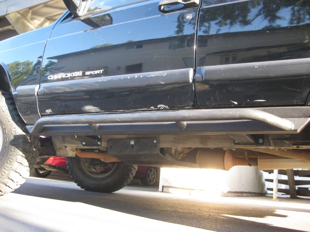

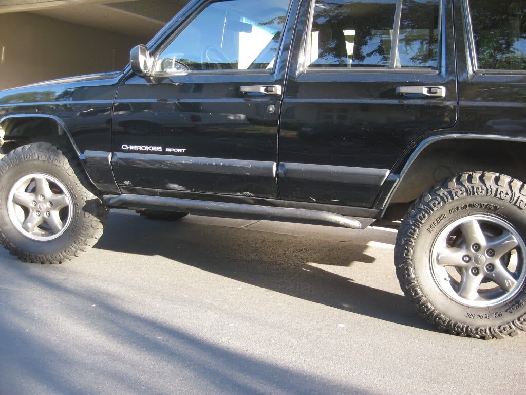

Got my sliders on finally. They've been sitting in the living room for around 2 months. Sorry wifey!
Anyway, my pinch seam was caved in pretty badly on the drivers side, but 3 of the 5 bolts on that side are through, and it should be fine for the upward impacts the sliders will get. I'm really happy with these things, they're super tough, and fit well (assuming you're not starting with body damage like me). I'll probably hit them with another coat of bedliner.
Anyway onto the pictures.
