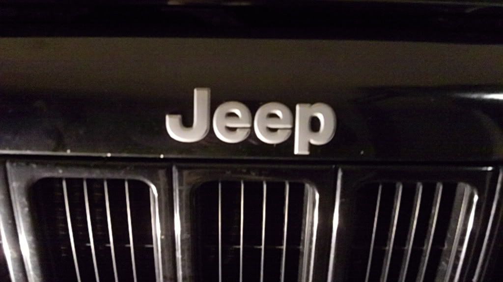

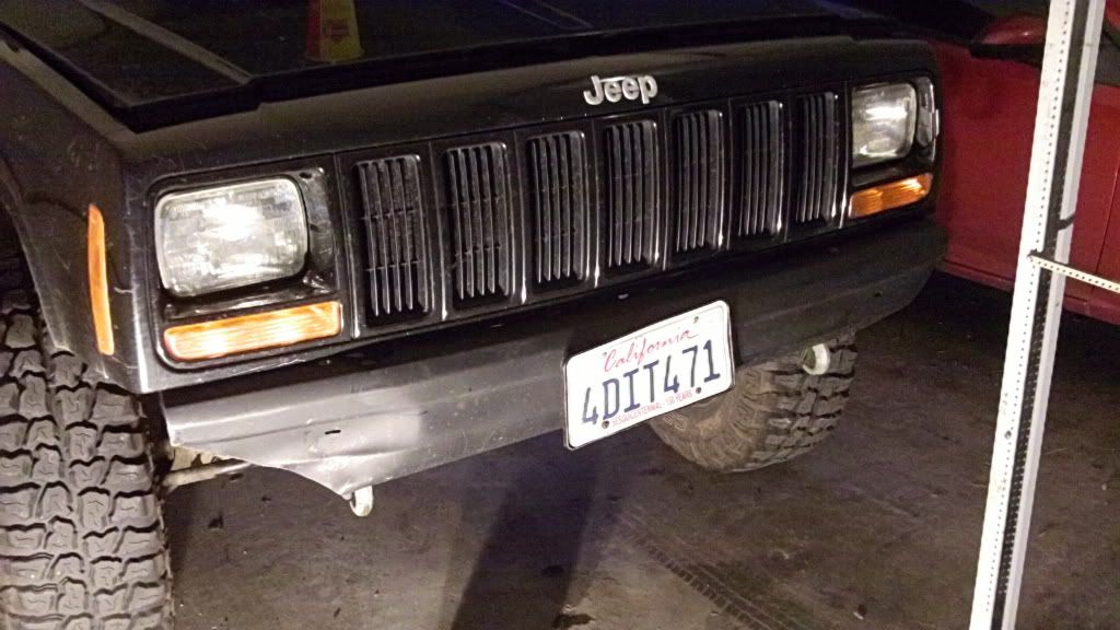

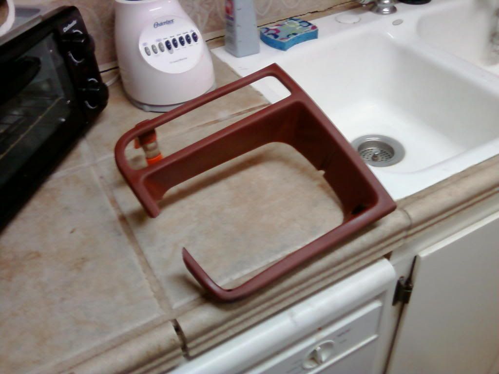

While waiting for my parts to arrive, I started in on a few things I've been meaning to do for a while. First, I ordered a new headlight bezel because the driver's side broke somehow when I wasn't paying attention. Since it comes primered, I decided I'd paint the rest of the grill to match it, since it's covered in bugs and crap anyway.
Took off and test-painted the broken bezel tonight to see how I like the satin black against the rest of the gloss black paint. I washed it in the kitchen sink don't tell my wife and scuffed it with 500 grit sand paper, then primered it. Once the primer is dry I'm going to shoot the Rustoleum Satin Black.
Poor thing looks so sad. (sorry for the cell pics, my brother has my camera)
scuffed up
primed
Edit: painted pictures. Not a huge difference between satin/ stock gloss black, but i just want the whole grill assembly to be one uniform color. The grill and the intact Passenger side headlight bezel have not been painted, for reference.

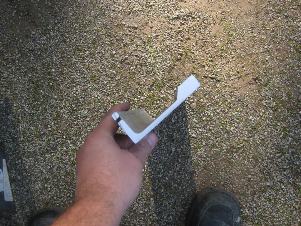

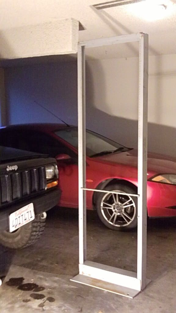

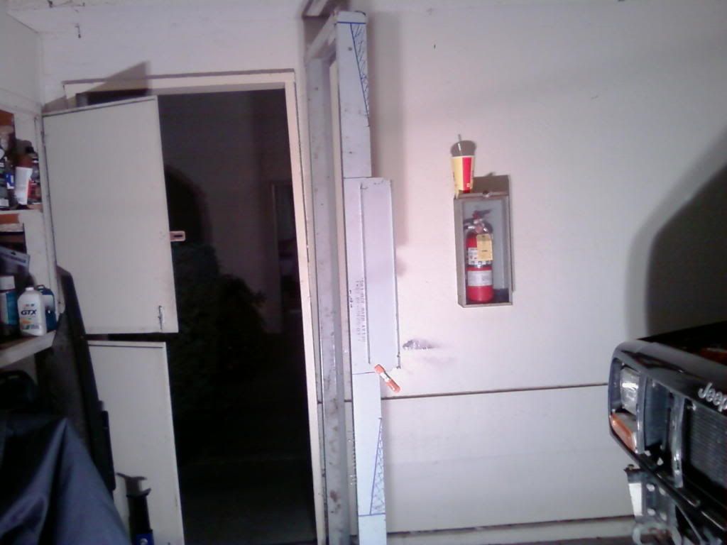

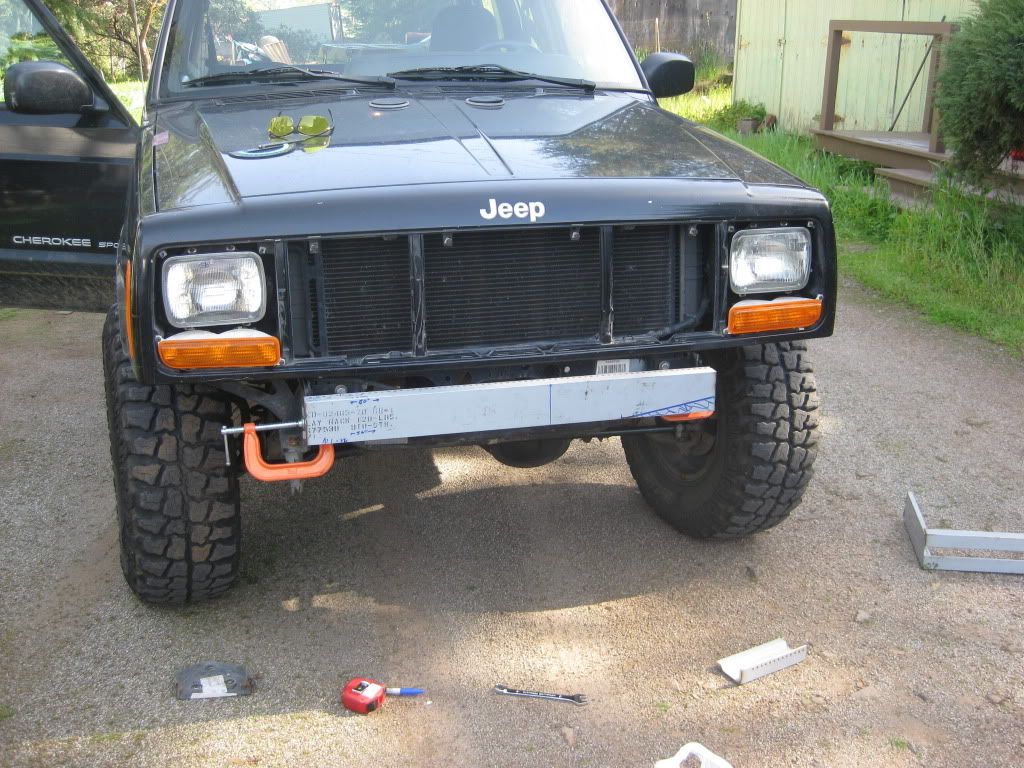

I also started thinking about how to build my front bumper. I scored a big relay rack for free, and it weighs a ton. 128 lbs in fact:
I plan on using the metal to build something with, and I'll buy whatever else I need to finish it off. It's about 7 feet tall, and each side is 1.5"x3.5" angle, 1/4" thick at it's thinnest, and tapers to 1/2" on the thickest end. The base is made from two 24" pieces of 5x6x.5" thick angle, which might get used, I'm not sure. This metal is beef though.
I plan to build a slim bumper with it, taper the edges, and extend the center section so that it is 6" tall, in order to cover the bottom of the support below the grill.
I will incorporate side protection too. Don't mind the screw holes up the sides, I'll weld some flat stock over the top.

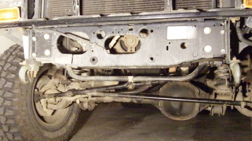

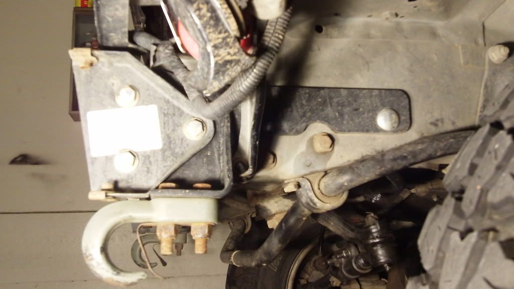

I'm going to try to build it using the C4x4 tow hook brackets, which extend back a ways to the unibody "frame". They attach with 6 bolts to the body, which isn't as many as most of the aftermarket tie-in brackets used, but if the brackets are good enough to tow from with hooks, then a bumper should be fine to attach to them.
I may convert the tow hooks to D-rings, or I may weld some D-ring tabs through the bumper nice and sturdy. I'll know more about what I want once I start mocking it up. I don't plan on using a winch with this setup.
I clamped that scrap piece to get a feel for what the 6" center section would look like, and plan to start the angled cuts at same angle drawn on the metal, but at the bottom of the piece shown there. I haven't worked out any details yet. Just looking at dimensions, etc. For now this is kinda the profile I'm looking at.
I didn't cut anything yet because I'm out of cutting discs and I don't want to dive right in without giving it a little bit of thought first. Can't waste metal.

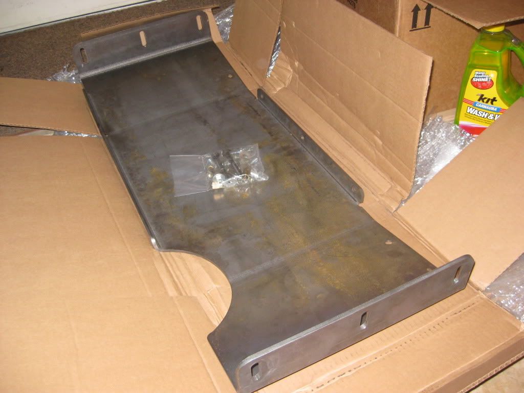

Brown Santa showed up today. Got some goodies. Still waiting on the sliders from JCR offroad, but the transfer case skid and rear nut strips came, and they're pretty sturdy.
The TC skid is 1/4", and weighs 50 pounds!
I also got Skyjacker Softride shocks, a new oil pan gasket, rear main seal, and a new oil pan since my old one is dented pretty bad. The nutstrips will be used for a future rear bumper build.

The skid is in! I don't have any pictures, but it's nothing exciting anyway. My crossmember is ****ed though, so we had to do the best we could with the self tapping bolts that hit the front of the Xmember.
I am not impressed with the nutserts they sent with it. They didn't crush very well and there weren't any extras in the kit. Luckily the guy helping me with the install had a whole box of them (different brand) that worked much better and allowed for some screw-ups. There is still one that is stripped but I need to pull the skid off in order to get at it. There are 10 more bolts holding it on though, and it's not load-bearing, so I think it will be fine for now.
It is super heavy-duty. I can't say it's poorly made. It should withstand a heck of an impact. Waiting on my sliders to arrive next Wed.
