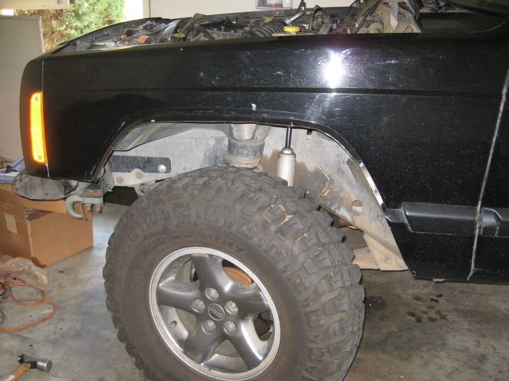

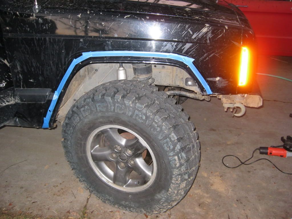

Quick update, since I'm at work. I trimmed the fenders and made some quick disconnects for the front sway bar. Now I can get into even more trouble. When drilling the top part of the stock swaybar end links, the trick to keeping the threads clean and nice is to drill through a nut that you don't need. That way you're drilling a flat surface, and the threads don't deflect or bend. Oh, and to keep it from rattling, we used Bellville Washers, which are bowed and keep pressure on the hitch pin and the bracket. Works great, and super quick.

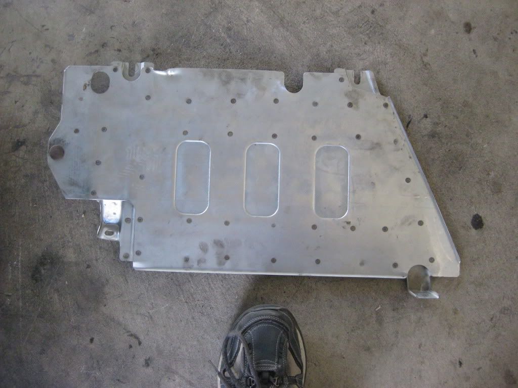

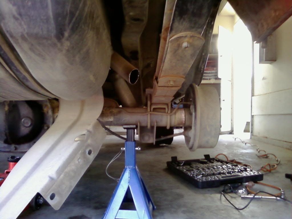

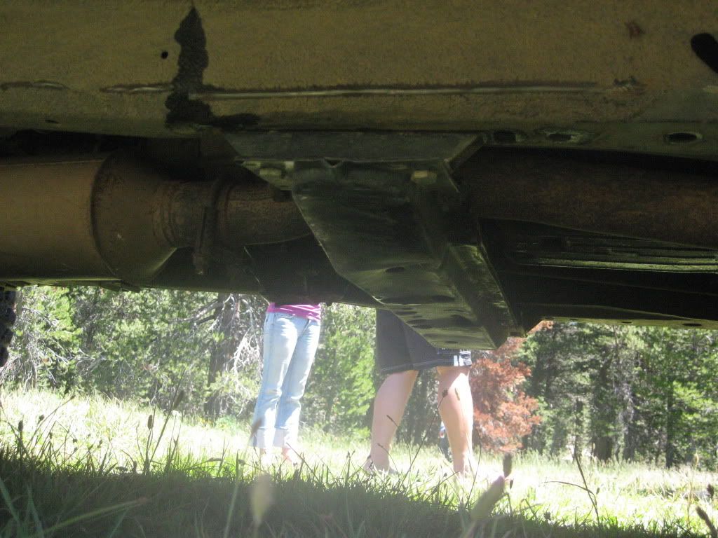

Not a lot is new, but I installed an 84-96 gas tank skid with only minor modification. Just gotta grind the welds on the rear corners and bend it down (helps to have a friend and a big hammer) so it will clear the tank. I will probably eventually beef it up but it's great as it is. I also had to cut the tail pipe just past the axle since it was rubbing on the leaf spring and would have gotten in the way of the skid plate. I did sand and paint it before installing it. Can't find the pictures though. Cost me $30 from a fellow JF member.

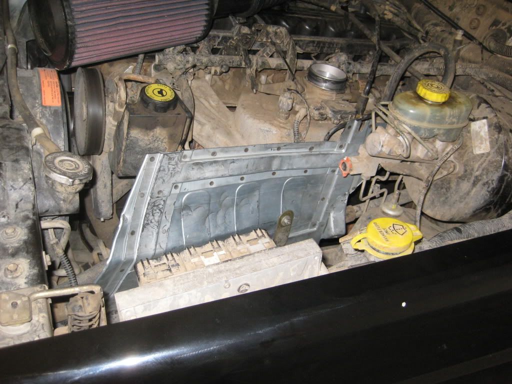

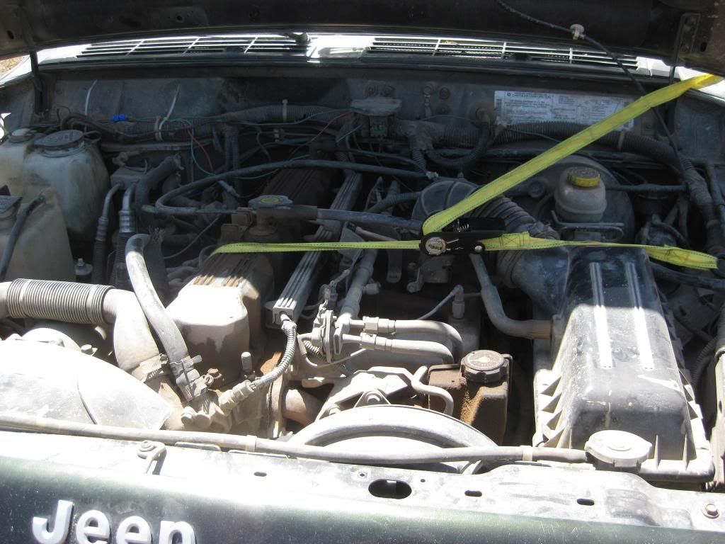

I also came up with a simple but effective homebrew intake and heat shield. Found a scrap piece of metal at picknpull, bent it and cut it to fit, and then took a piece of PVC, threaded an air hose fitting into it, and voila.

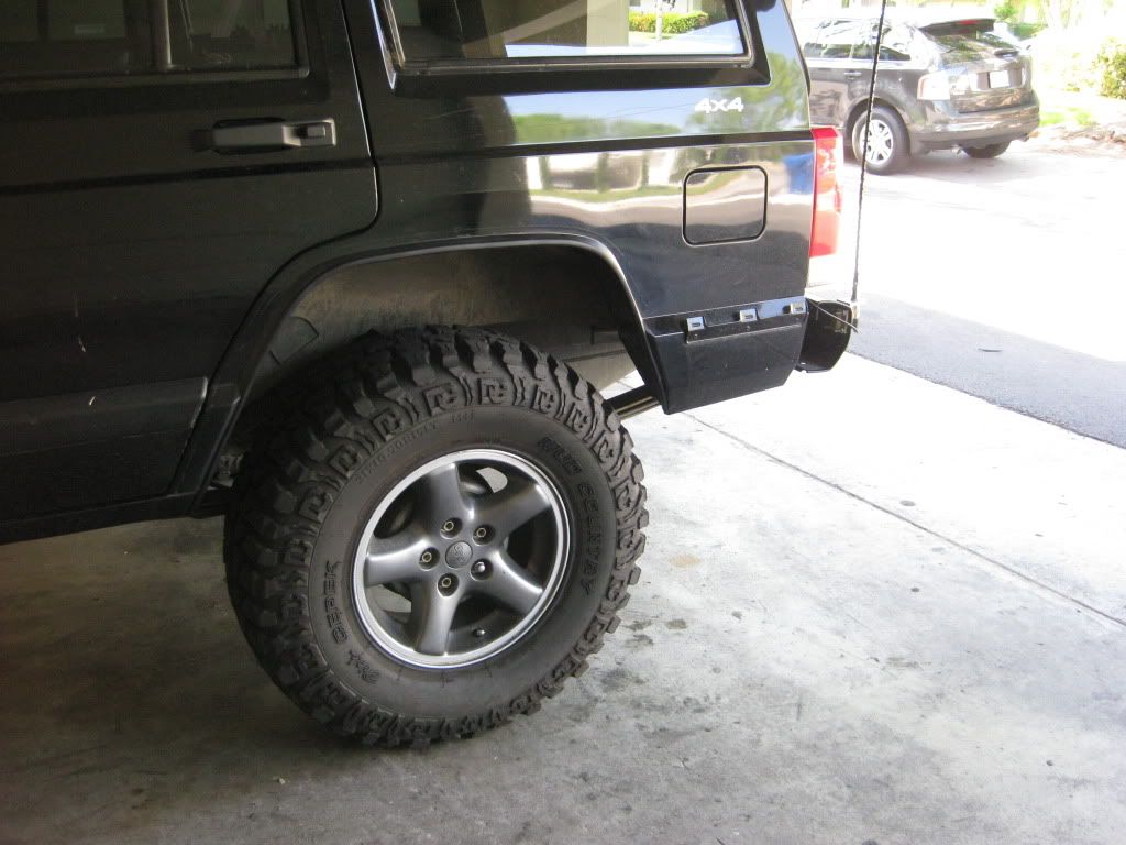

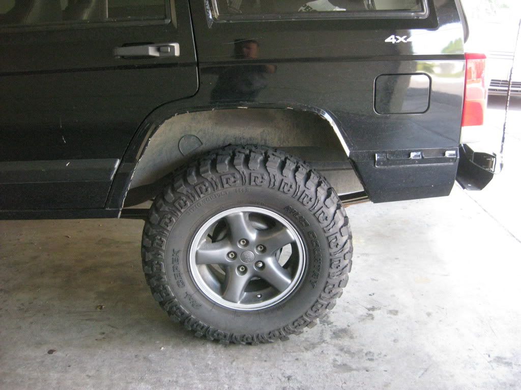

I put some door edge molding on the front fenders and bumper ends, and some trim molding on the rears (since I did the cut and fold, the door edge stuff would not work). This was bought from pepboys. Autozone has similar stuff but I didn't see any in big enough rolls.
Before:
After:

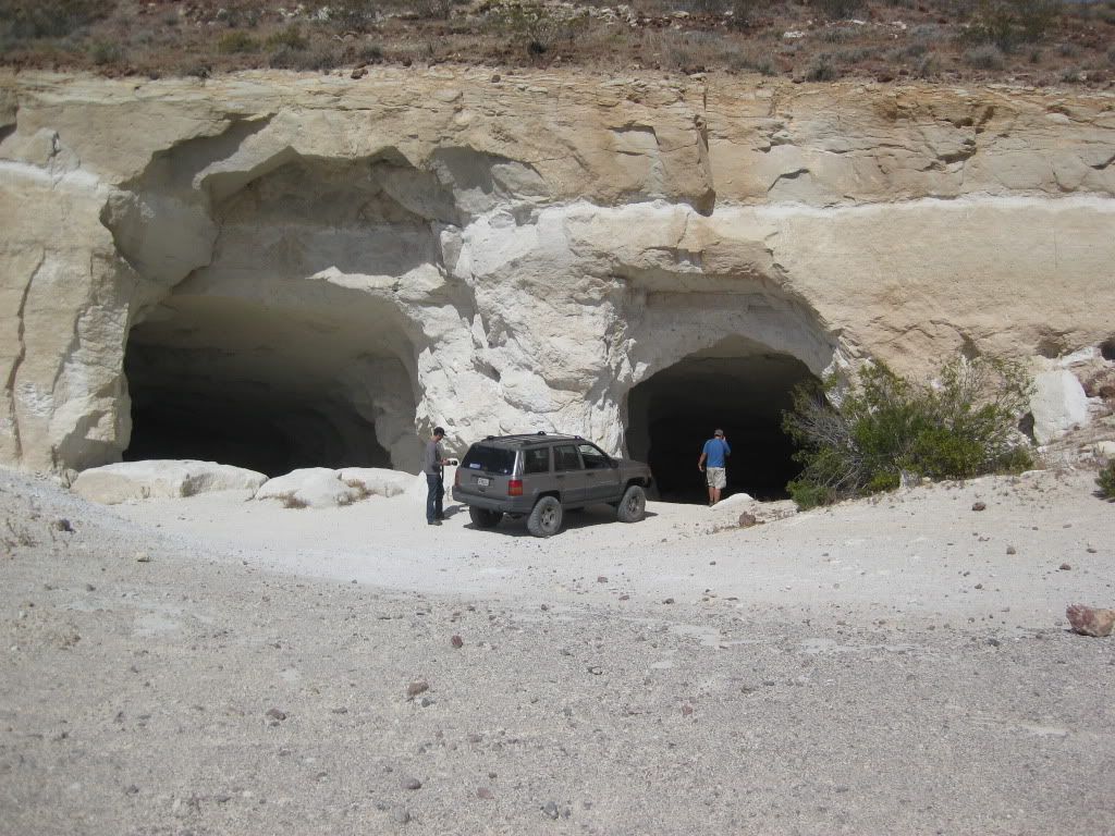

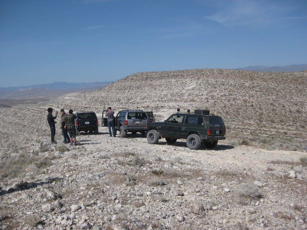

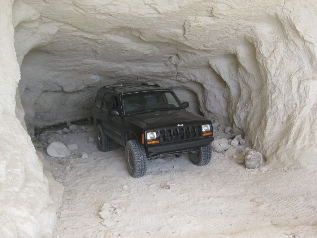

Then I took it on a trip to Red Rock Canyon, Jawbone Canyon, and Dove Springs in May:
Talk about a man cave!
Trail fix for broken motor mount bolts! Not mine, a fellow JF member who joined us down there. It was a LONG limp back to camp.

what trim molding is that?..i need to get some for mine.

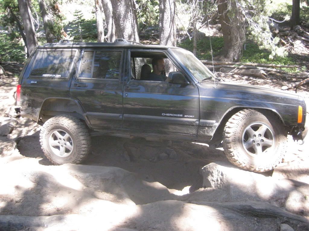

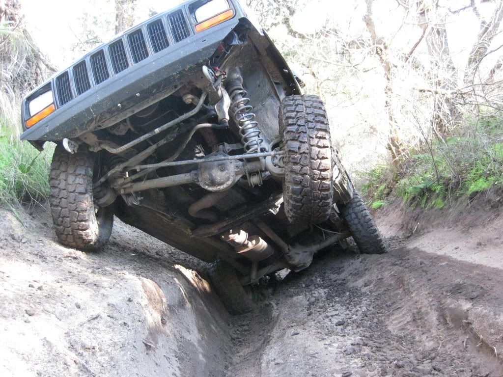

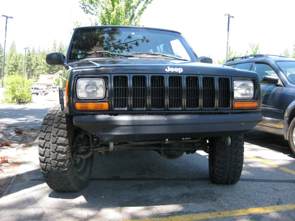

Another trip to Hollister SVRA to test some extended bumpstops (still need more) to protect my precious tires.
checking for tire rub
The quarry is always fun
Bonanza Gulch? Not sure...
Smokin the tires trying to get up this off-camber steep climb. Need lockers...
A good day. I wanna go back.

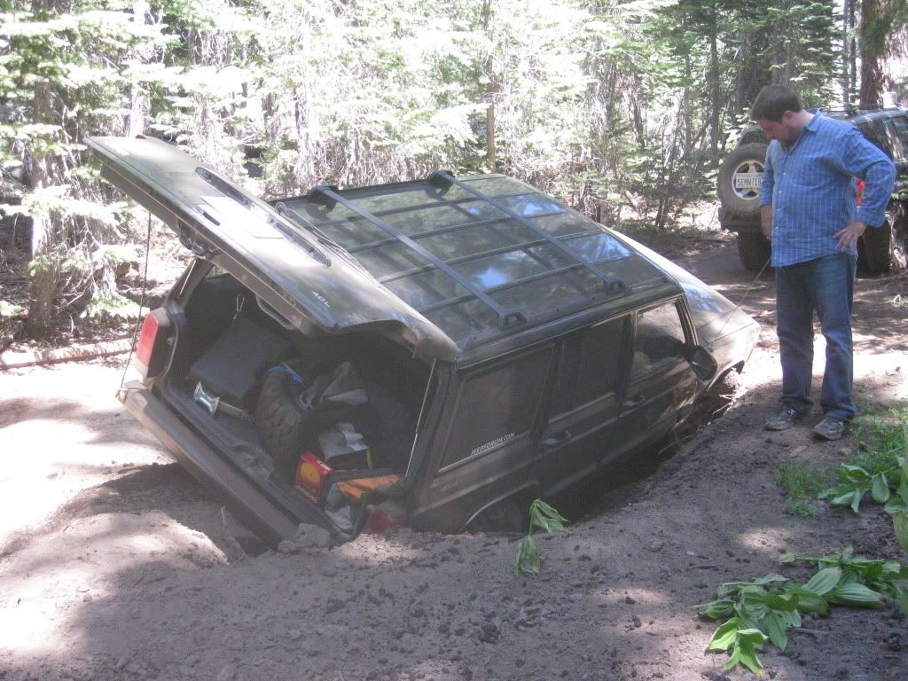

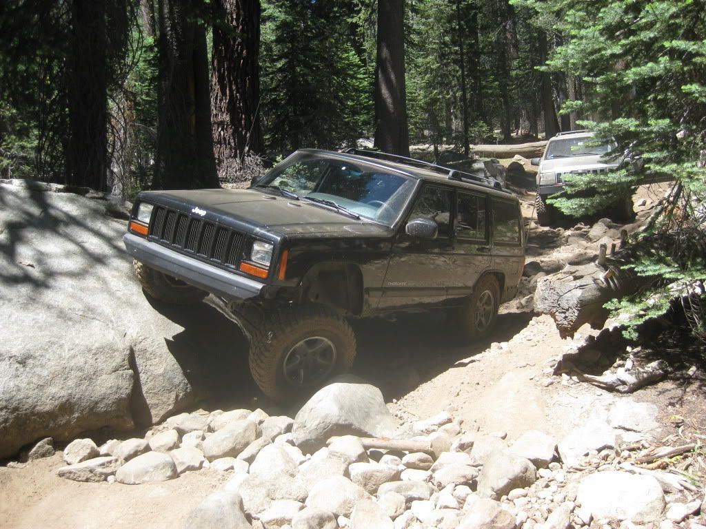

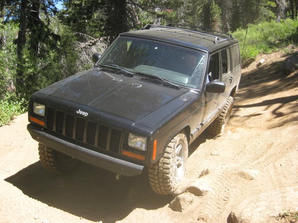

Most recently ran Deer Valley south of Lake Tahoe. It's rated a 6 going south, which is what we did, or a 7 going north. Took the better part of a day, but it was beautiful, challenging, and empty. Perfect. The best time I've had with my jeep yet.

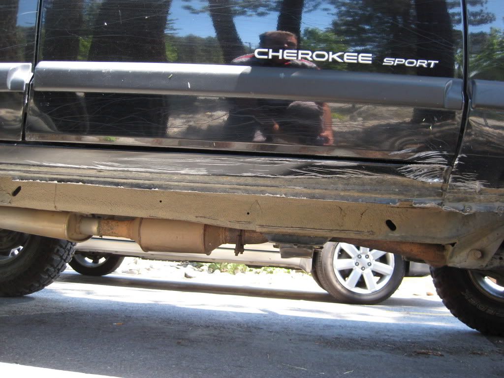

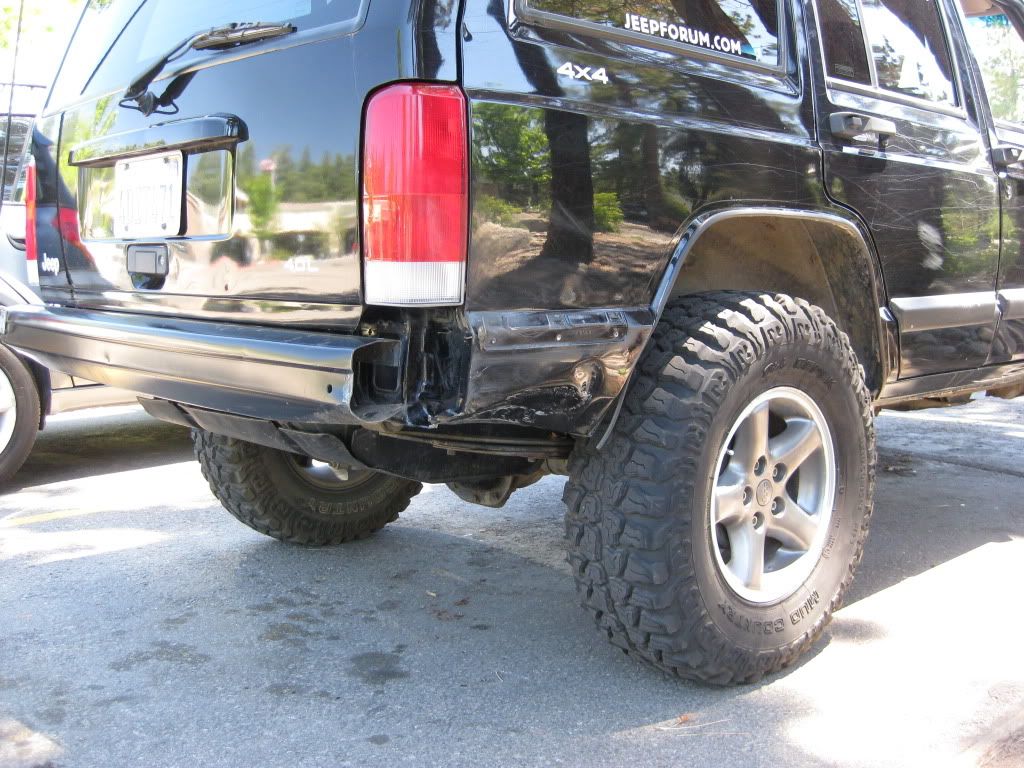

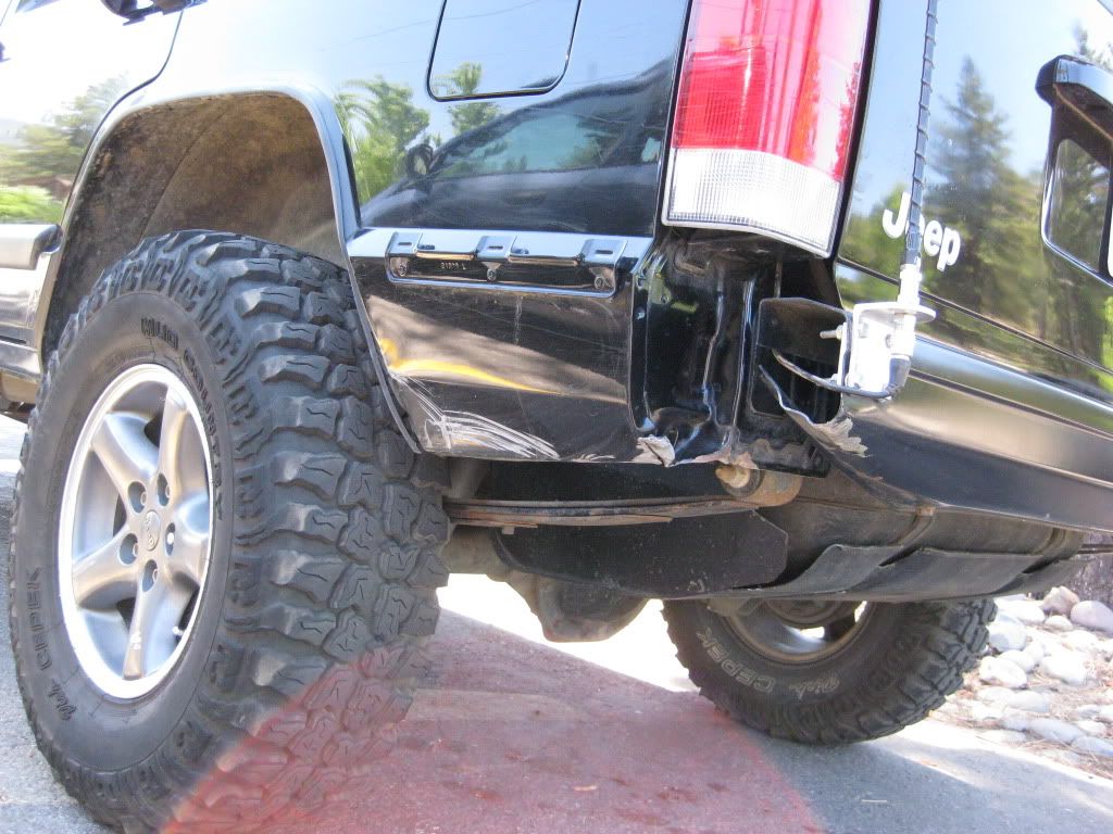

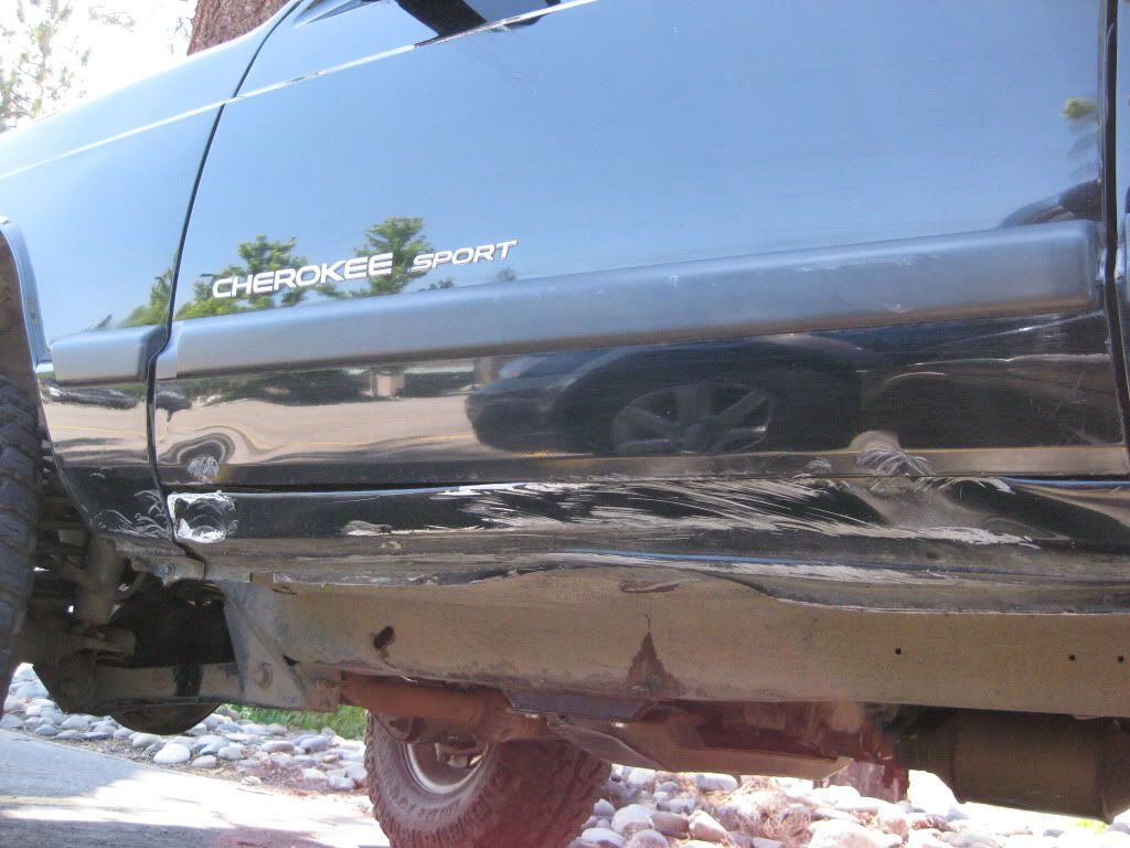

I took a bunch of body damage to the rockers and corners though. I should have had more protection, and I could have played it safe, but there were some big rocks. Oh well. On to pics:
Lower Blue Lake, just near trail head
found a hole, decided to drive into it. got stuck.
drivers side took the worst hits

post #29 of 75 Old 08-16-2009, 02:08 AM Thread Starter
tizzdizz
tizzdizz's Avatar
2003 WJ
Join Date: Dec 2004
Location: campbell, ca
Posts: 1,181
pass side
bumper

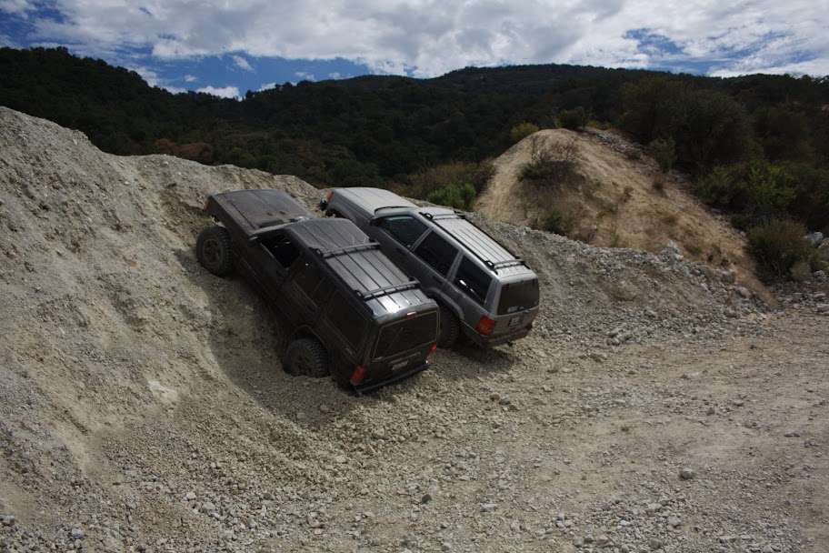

Also finally got a shot of mine next to a stocker. Not bad for a budget boosted jeep on a budget.

Pep Boys is where I got mine. I used a roll of door edge molding for the front fenders, and both bumpers. I also used a roll of (3/8" I think, possibly 1/2") adhesive trim molding just on the corner of the rear, where I folded. You can probably find it at any auto parts store.
