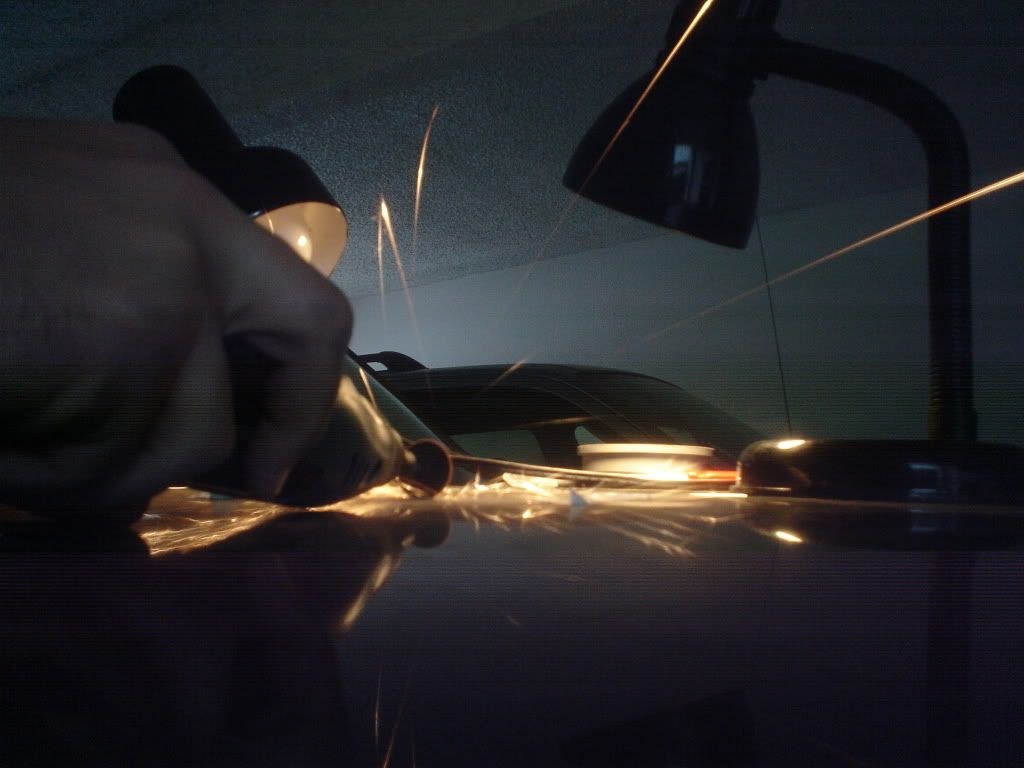

I also scoured Home Depot for some type of deck plate to install for wheeling during these hot California summer days. I decided on these 3 1/4" test ports, used somehow for plumbing. I found them in with the PVC elbows and drain stuff. The grey stuff is rubber, and will act as a gasket with the wingnut tightened. All I have to do is take off the wing nut and both black plastic pieces come apart, and I have open holes for when it's off road and HOT. As far as temperature difference, It’s maybe 5-10 degrees cooler with them off, but it’s hard to tell. What I can see is the heat waves wafting out of it when both fans are on and I’m crawling or stuck in traffic. Every little bit helps.
Pretty self explanatory, but taking a dremel to a perfectly good hood was very hard to do. If you do this, MAKE SURE you don't wipe off the metal dust with a rag. I got some buffing to do.

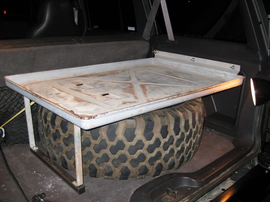

Found a junkyard cargo rack for the trunk:
Made it easily removable, and it clears the full size spare that I got for $30 from the JY.
