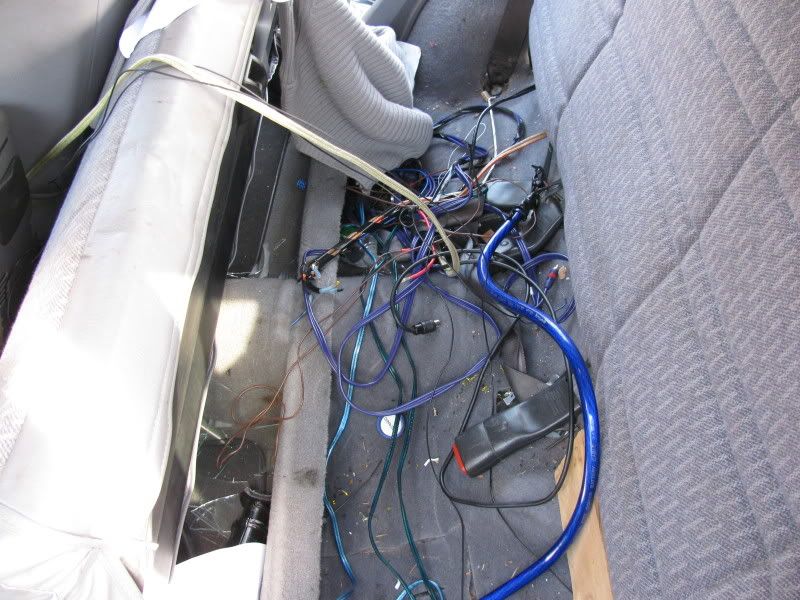

This is a build thread for a Friend that just bought black 1997 xj. Picked it up for under 1k. It's a good starting point to build up. The plans for it are a 4.5" re lift and 31's or 32's. It has around 180k on it and was really not well cared for so the first thing we need to do it fix all the worn out stuff and the crap load of electrical problems.

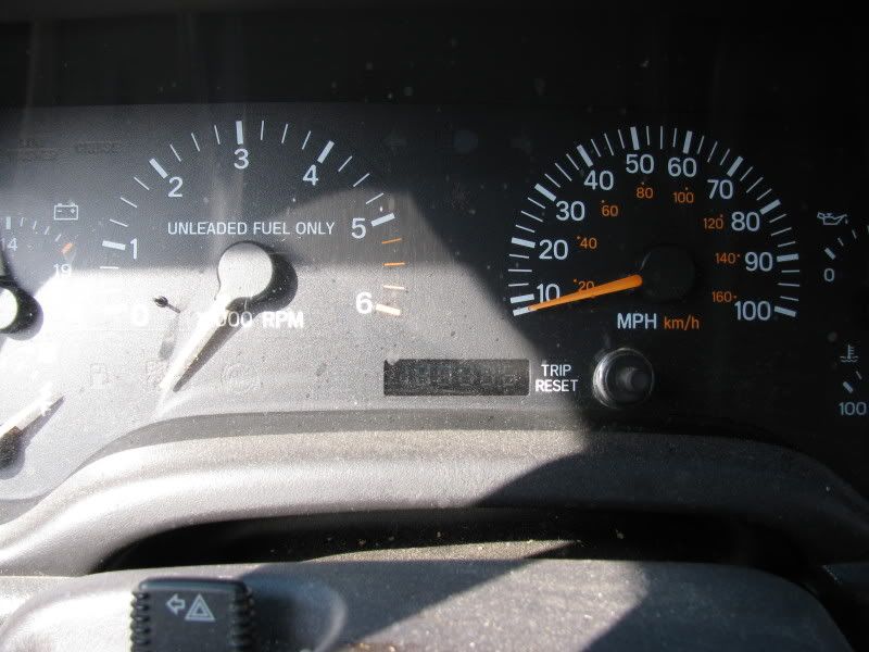

broken gauges

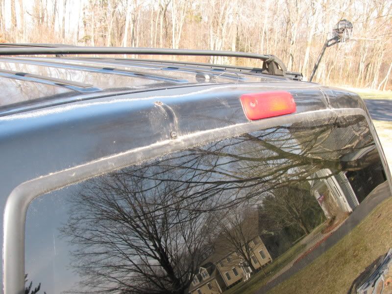

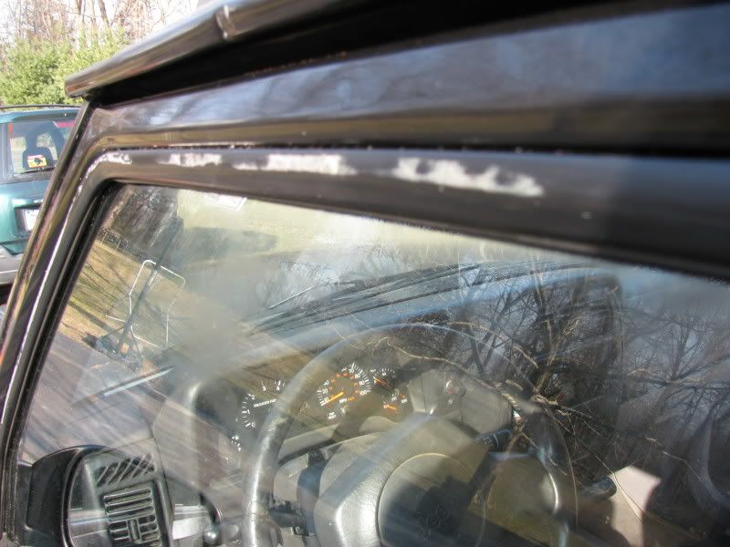

What is the best way to get rid of sticky **** left over from the stupid visiors?
spoiler gone

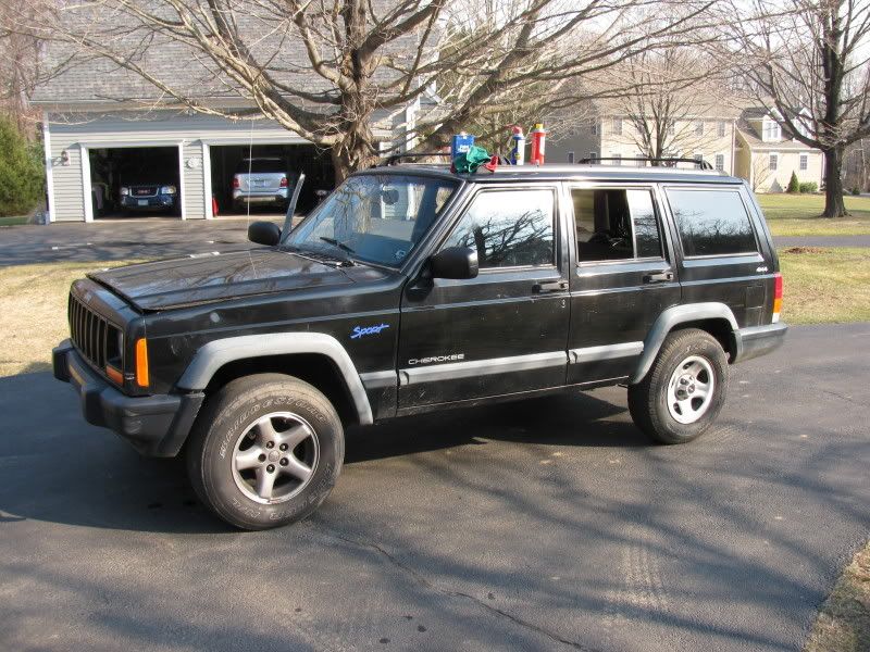

I seem to recall a similar Cherokee as well. Let's get a full exterior pic!

What a beauty!

Use this stuff on the adhesive, works wonders. Let it marinate for a few hours and wipe off what comes off, soak it again and repeat till it is off. It wont harm anything if it sits too long. It is the least abrasive way to remove it.

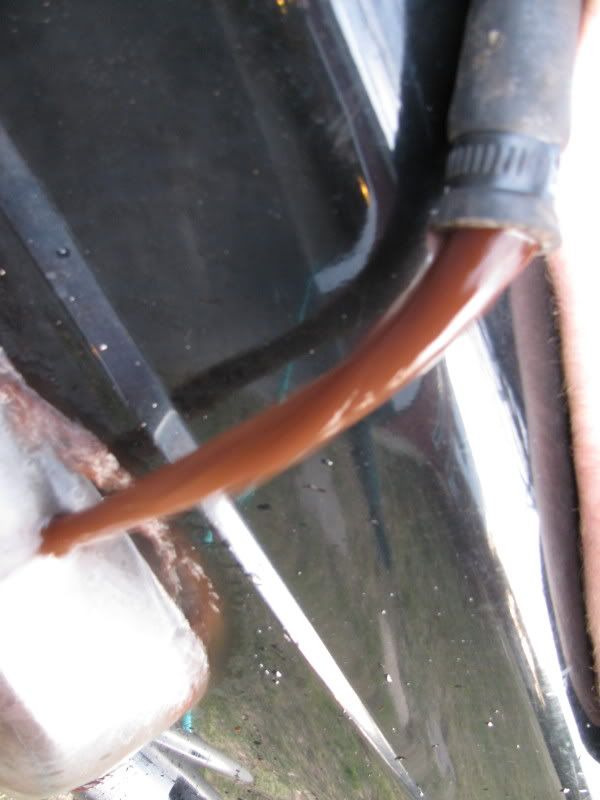

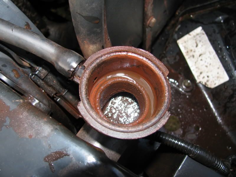

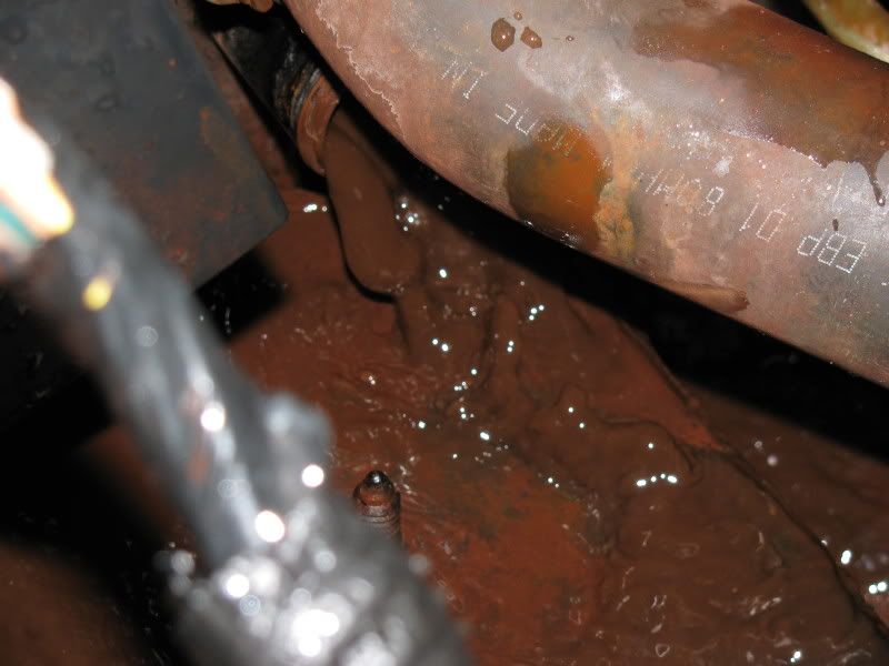

well started woking on the coolant system it was very poorly mantained. It is very rusty. There doesnt seem to be any oil in it and the oil isnt milkshaked so hoping the head gasket is ok. I took the t stat out to make it easy to flush. I'm just going to keep filling,driving and draining till it stays clear. After 4 fluses it's getting a little better.
4.0l sahara is offline   Reply With Quote

Holy crap thats some nasty fluid there.

I have to ask with all that gunk and so on it was not overheating? I would def run some flush cleaner through it multiple times..

no it seemed to run a tad hot but didnt over heat. ya I have some really strong cleaner thats going in there.
