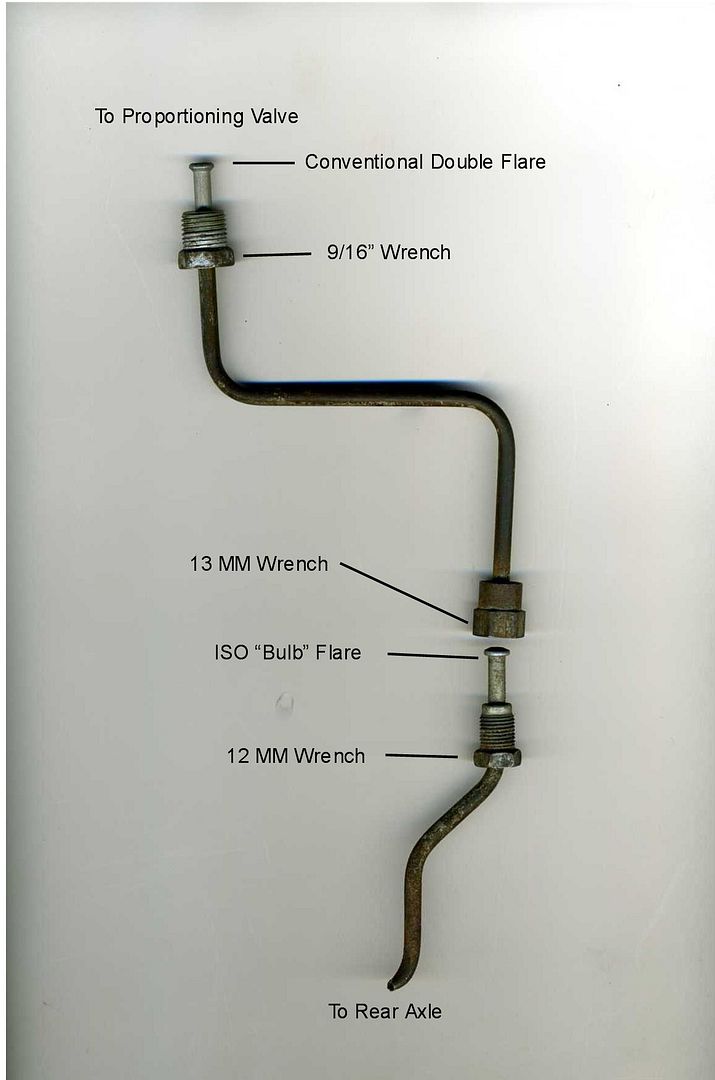

Here's a pic that shows the small dogleg tube that goes to the proportioning valve and it's flare types and wrench sizes. If you used an OEM tube assembly that goes all the way back to the rear axle the flare nut that connects to the dogleg should hook right up.

Verify that the flare end that goes into the proportioning valve is a conventional double flare (SAE), not an ISO Bulb type flare. Examine the threads on the flare nut-make sure they're not crossthreaded. Same with the female threads in the valve.
If neccessary, loosen (or totally disconnect) the Metric coupling enough to allow you to go straight in with the SAE end. Carefully start the threads and once they start you should be able to turn the fitting in by hand.
