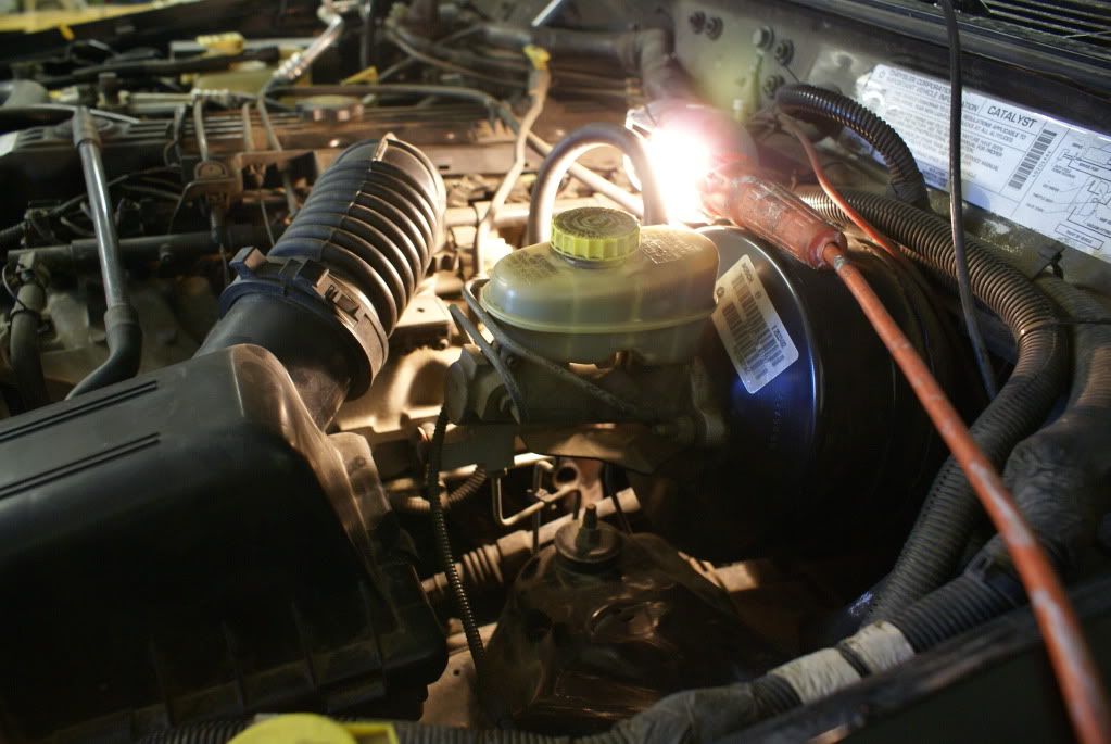

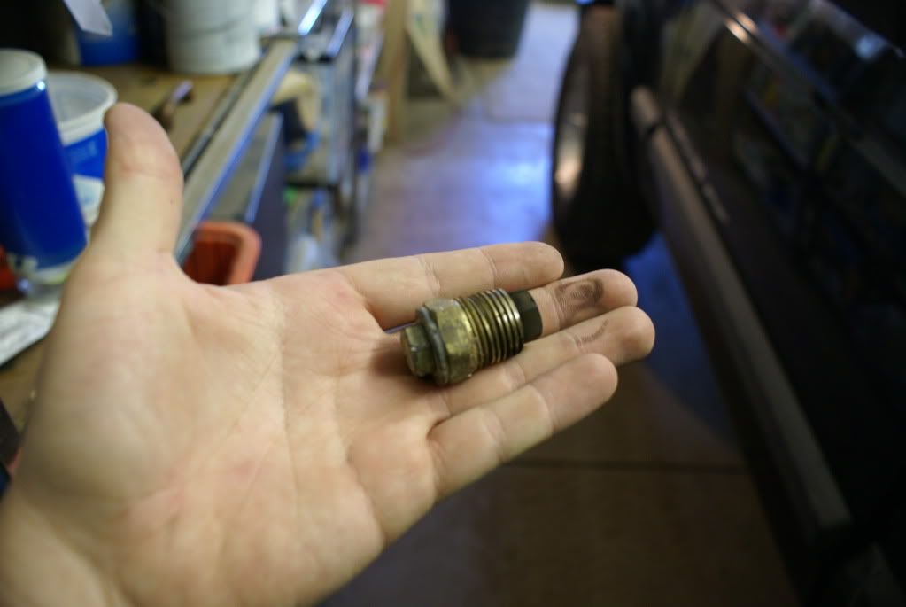

Sorry for the vagueness. one of my friends suggested loctite also. here are a couple pictures of where it is though.
Here is the bolt itself

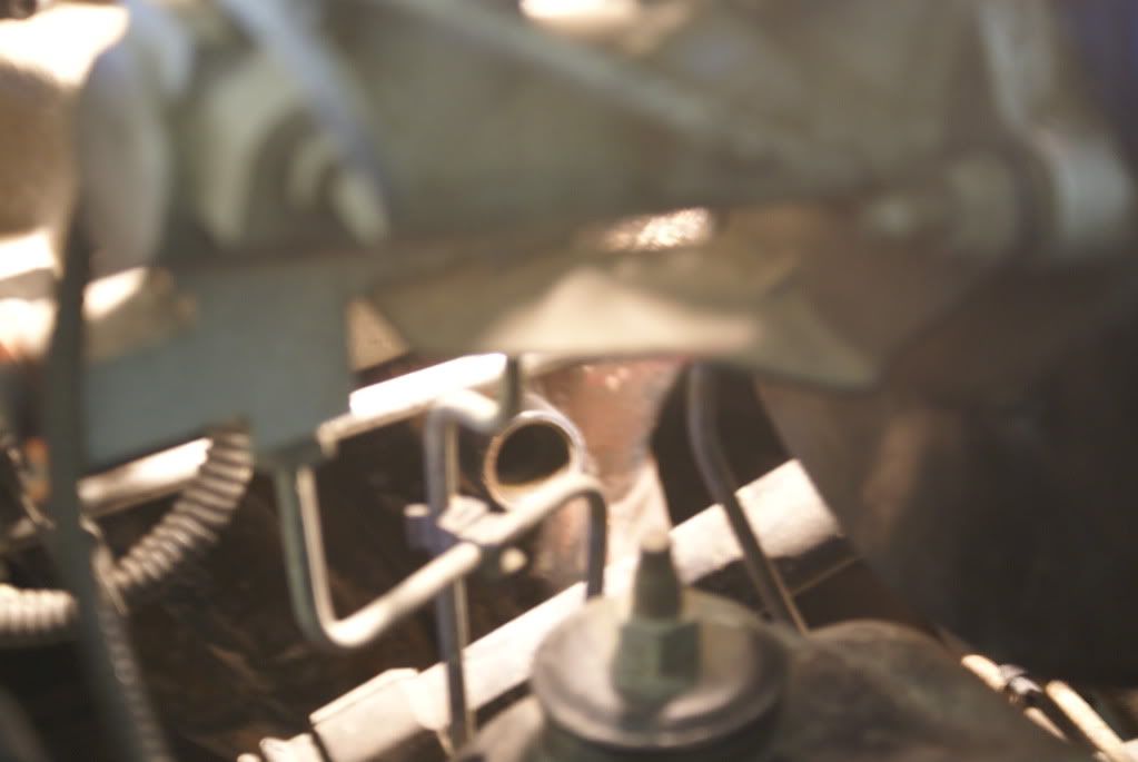

It might be a bit hard to see but the bolt fell out of the hole there beneath the brake fluid resivoir
here is a bit closer pic

That's reall odd. A 99 does not have EGR and stranger, does not have a tube sticking out at that location, and does not have a hole in the exhaust manifold there. I can't imagine what it is.
But that does appear to be a plug made out of a brass fitting and a bolt. The threads appear to be buggered, which would help explain it not staying in.

As others have noted, the photos of your engine compartment show features that are NOT normally found on a 1999 XJ with a 4.0L IN LINE (not "V") six cylinder engine.
The hole you see is in the exhaust manifold of the engine, and the noise you hear is exhaust gases finding a way out other than through the tailpipe and muffler.
The bolt you show is functioning as a plug for that hole, and is made from brass. The soft threads of the brass are stripped, and will not tighten properly in the hole. You need a new plug.

I did go to a auto parts store and bought a new bolt and some loctite for it and put it in there nice and tight. And it sounds better than before even with that previous bolt in there. Also while showing him the bolt he said it looked to him that whoever had it before rigged that bolt together himself.
