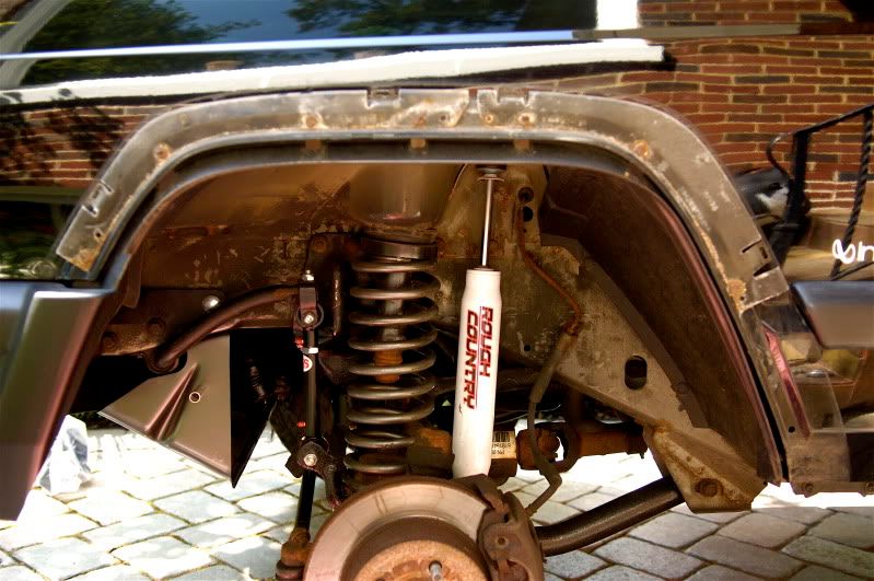

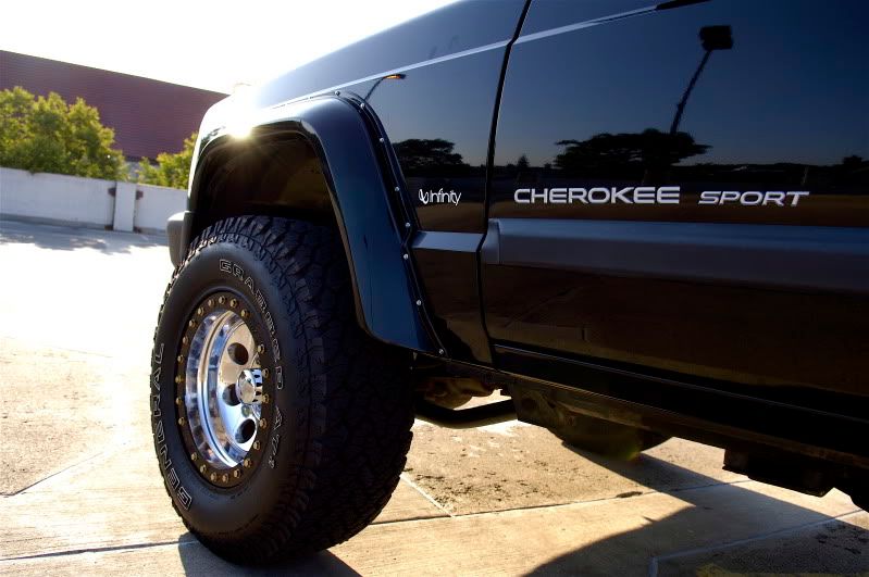

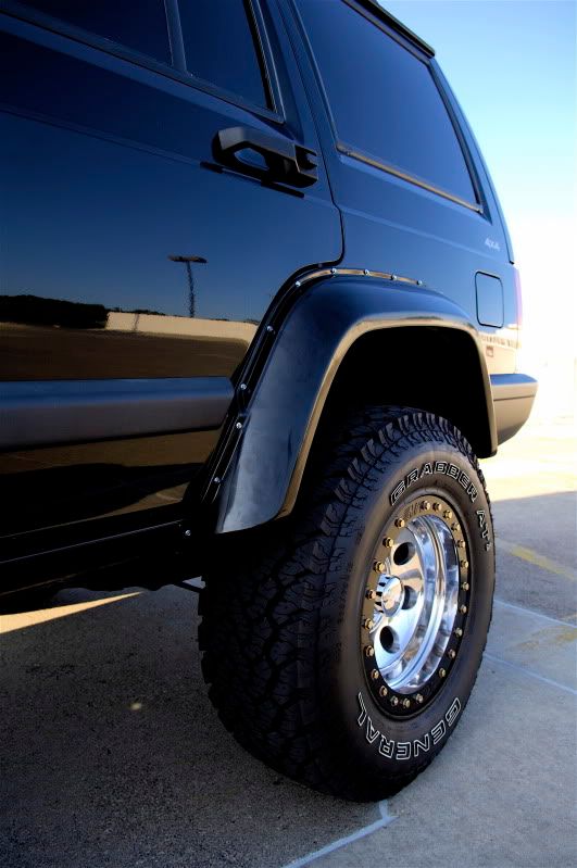

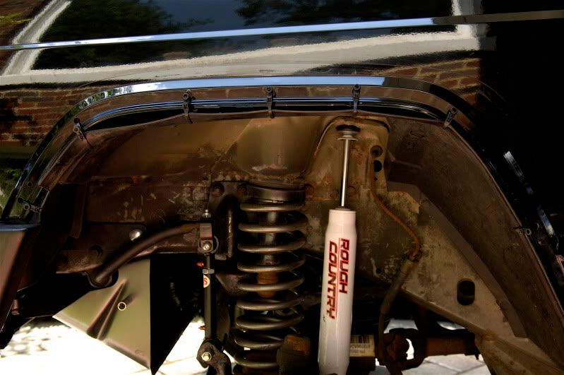

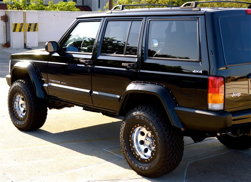

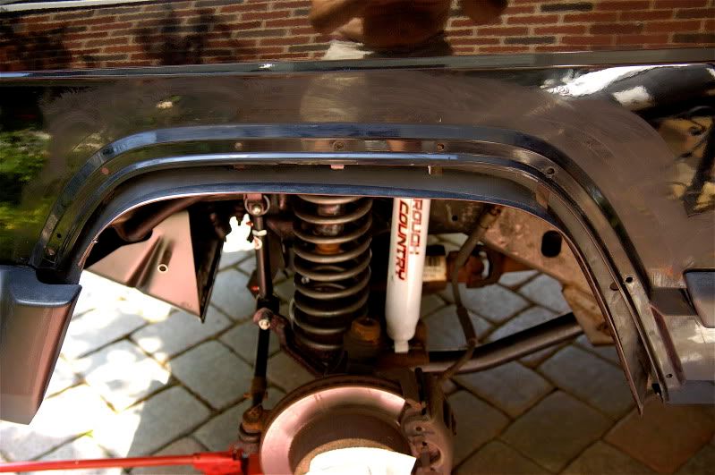

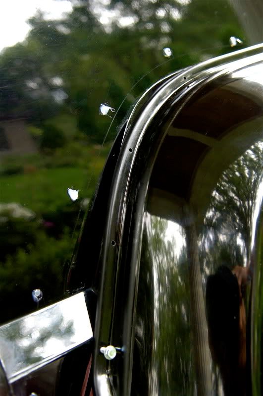

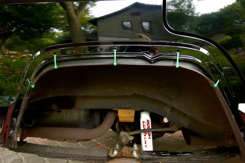

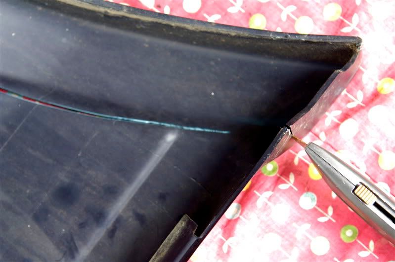

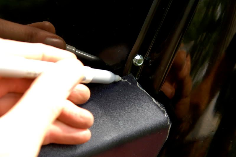

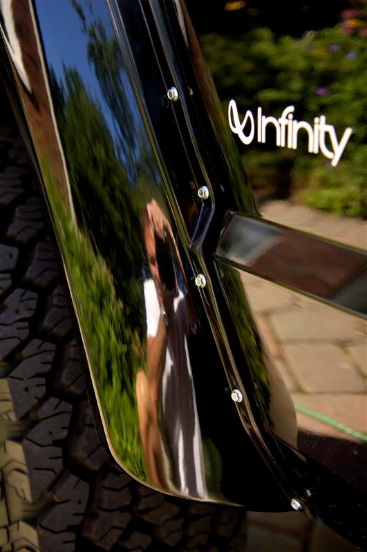

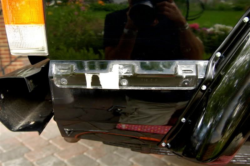

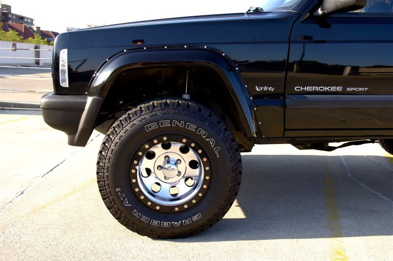

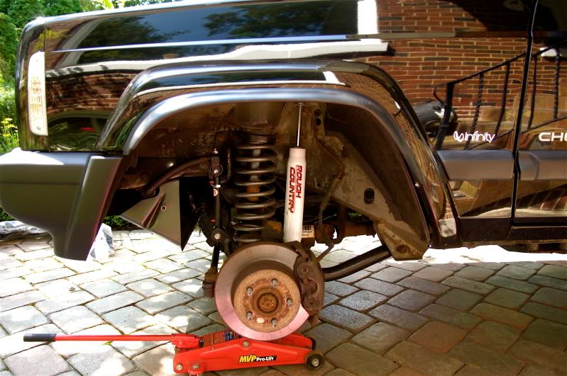

Update-Rusty's Flare Install
Hello guys, I recently had time to install a set of Rusty's fender flares. I like how they are very close to stock in shape. I did not want to cut my fenders, worried about corrosion, but also wanted the flare to not reveal the uncut fender. I was also able to retain my stock bumper end caps, and have these flow into the contour of the end cap. Very happy with the results.
Stock Flares
Flare removed
Cleaned/waxed
Zip tie inner liner-Front/Rear
Sealed holes with silicone
Now time to mod the rear end cap
Lots of time spent cutting
Finished

post #109 of 779 Old 08-02-2009, 02:28 PM
ajxj9197
2009 WK
Location: Bloomington, Illinois
Posts: 1,346
ahh so much better! those extended fenders bugged me. So much better, now time for that trim to go!
