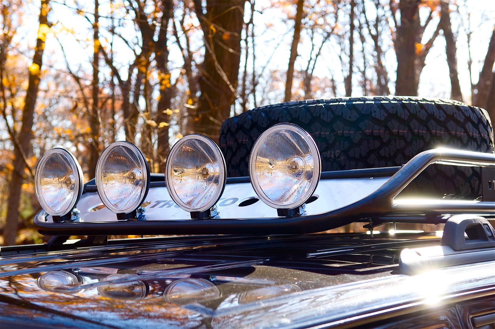

Roof Rack Lights
I got some lights installed on my roof rack. I went with four Hella 500 driving lights(55w). I didn't want to spend a small fortune on the lights, I don't see myself using them a great deal, but like the look. The Hellas fit the bill. I'll get them wired up and post that when I'm done. Here's a look:
Those are PERFECT 'screw you' lights (someone cuts you off, flip em on & say SCREW YOU!!!)
Great build, giving me WAY too many ideas!
Way too many ideas............feed the addiction

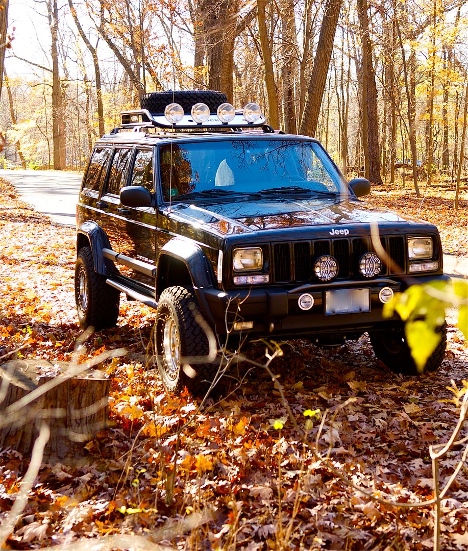

post #235 of 779 Old 11-07-2009, 07:38 PM
MLTXJ9889
1992 XJ Cherokee
Location: Washington
Posts: 999
Its so so clean haha. Nice work.

post #236 of 779 Old 11-08-2009, 02:19 AM
MGxj5875
Location: Maple Grove, MN
Posts: 25
Was your jeep repainted? What kind of polish do you use? Easilly one of the nicest and definately the CLEANEST cherokee here!!!! WAY NICE!!!

post #237 of 779 Old 11-08-2009, 02:30 AM
jshaab2
Location: NJ exit 105
Posts: 1,303
Woah , nice jeep man , its sick nice build. Very clean jeep . Wish I still had my XJ
