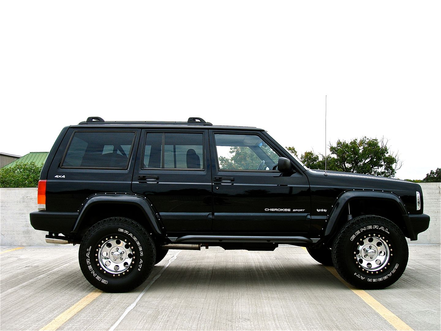

Sick rig man. I really like those sliders, but personally would have gone with black. Some 5% window tint all around would look awesome. I love the blacked out look. Now get out there and put some dings and scratches on that thing...
Thanks. See above

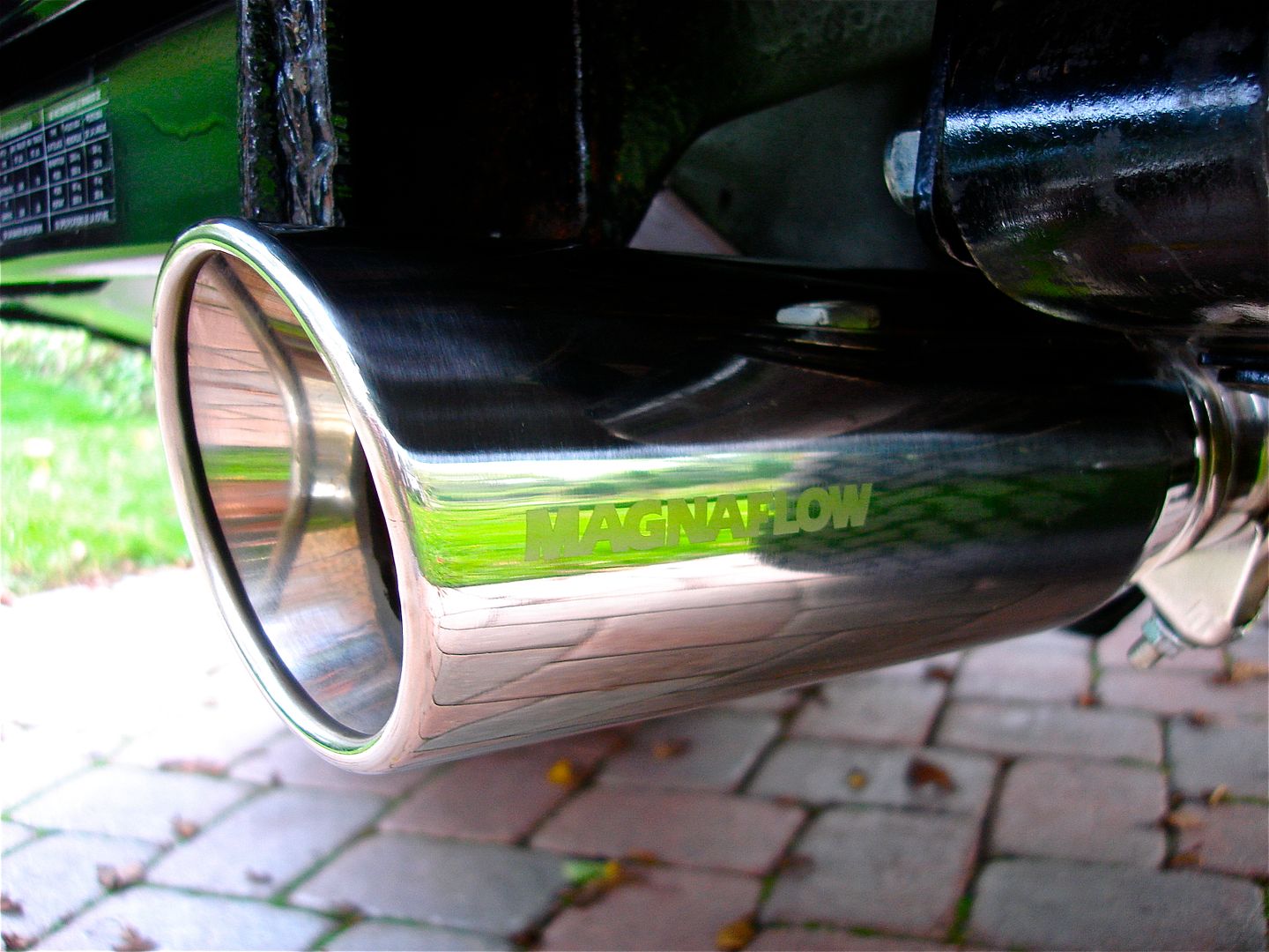

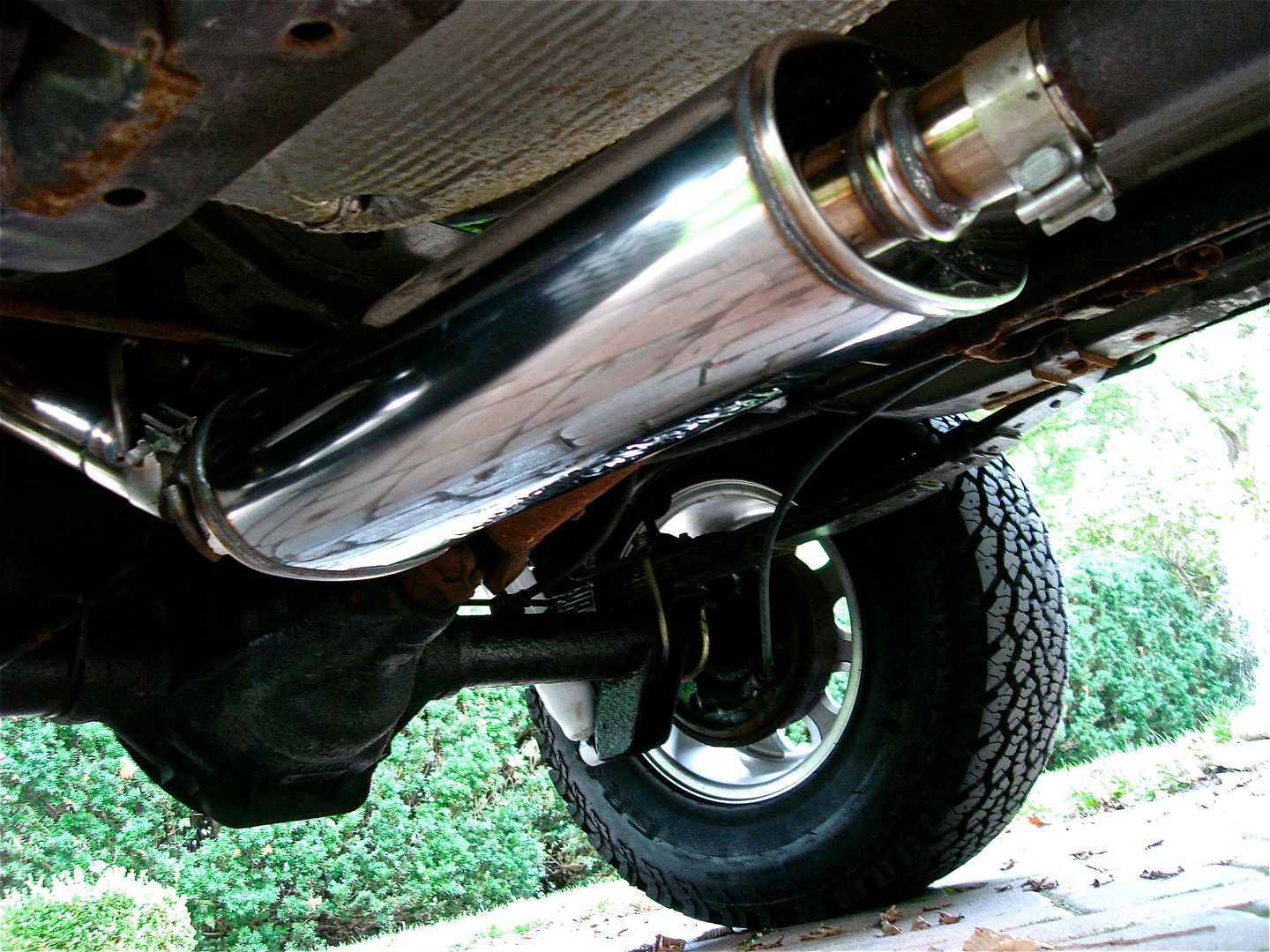

Here's a few pics of the Magnaflow cat-back that went in last week...sounds /feels good. I also have a 62mm throttle body (Jeepers and Creepers) waiting for me to start on. Love to hear some thoughts on CA intake systems. I'm hoping for something that has a little protection from water. Not really ready to go with a snorkel.

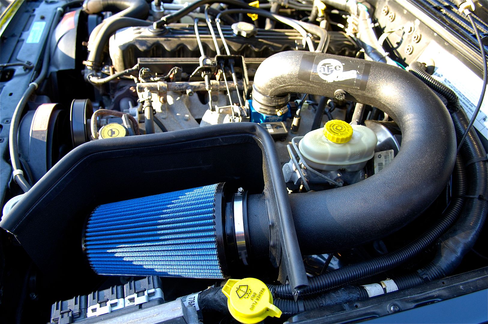

aFe 54-10422 - AFE Stage 2 Intake System for 91-01 Jeep® Cherokee XJ with 4.0L 6 Cylinder Engine - Quadratec
You can't really beat that deal if you want a true cold air intake with heat sheild. If you wanna go cheap, do what I did and do a spectre filter on 3" DWV tube. You should take a video of that exhaust. I really want to hear that!!
That intake looks good. I have a buddy running the K&N kit, it's nice, but looks susceptible to water contamination. This one sounds like it drops into the factory air box. AIRAID 310-136 - AIRAID® QuickFit™ Series Intake System for 91-01 Jeep® Cherokee XJ with 4.0L I6 Engine - Quadratec Better protection?

http://jeephorizons.com/news/images/...xj_install.jpg
yeah it does just drop in there, but it uses the same air tube like i'm using, which disrupts airflow. So for $210 I'd say its not really that worth it for the small filter and shield. The AFE routes the tube back around the brake booster, and gives room for a bigger filter. The K&N is a straight tube, so better flow, but more expensive. You should have the splash shield (that fabric rubbery thing under the engine bay) unless its taken off. That should keep quite a bit of water out. If you are really worried about water, and plan to tred water often, then I recommend keeping the stock box and just do an amsoil drop in filter (its better than the K&N drop in filter. Flows better and is a dry filter, so no oil upon cleaning).

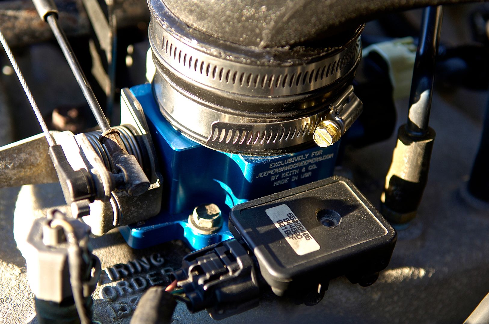

Update-62mm T.B. aFe C.I. - 10/7/09
Got some more work done on the XJ. A few days back I installed the 62mm Jeepers&Creepers throttle body. Install was pretty straight forward. They provide good instructions with the kit. I had only one problem screw that required heating to remove. The factory uses some form of thread sealant on the carbs, making removing them a little tough. The body is machined from new stock. Here's a look:
I felt an immediate improvement in throttle response.
Today I installed the aFe stage 2 intake.
I'm really happy with the quality of this set-up. The filter was actually larger than I thought. Install took just under 30 minutes. I liked the routing of the intake, up and away from exhaust heat. First drive, even better throttle response, engine pulls real hard. Exhaust sounds even better than before. In general, it feels like you just woke the engine up. I'll keep an eye on mileage to see if I notice any difference. Right now I can't keep my foot off the skinny pedal.
