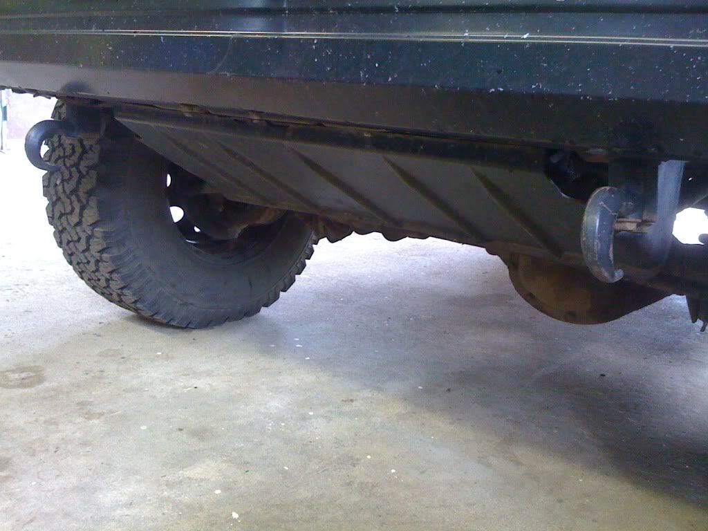

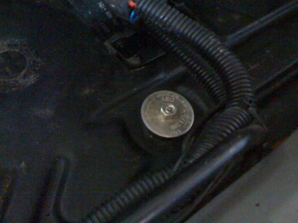

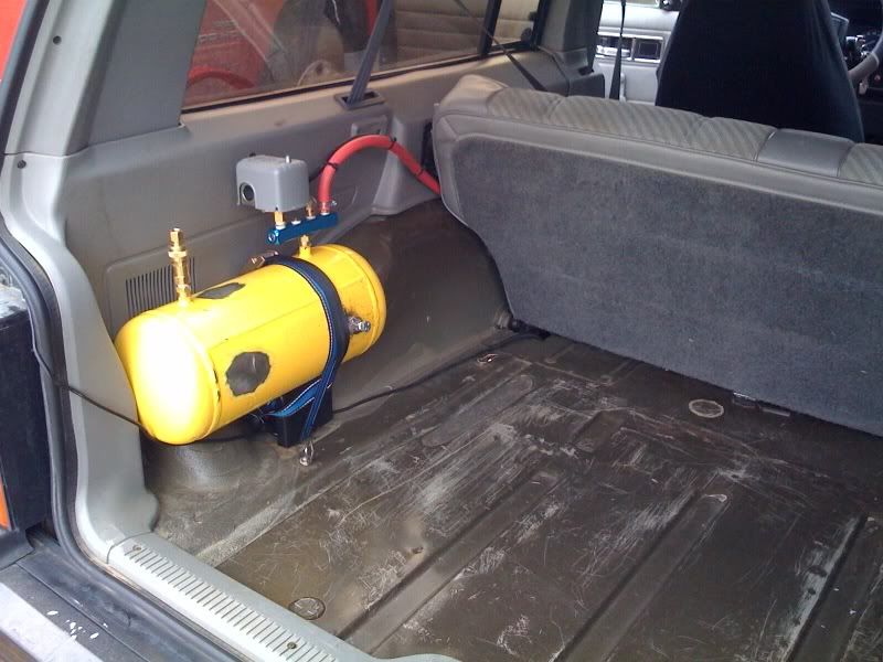

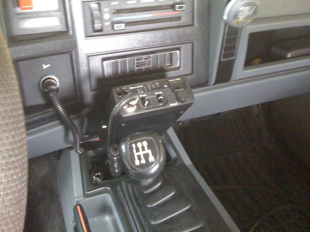

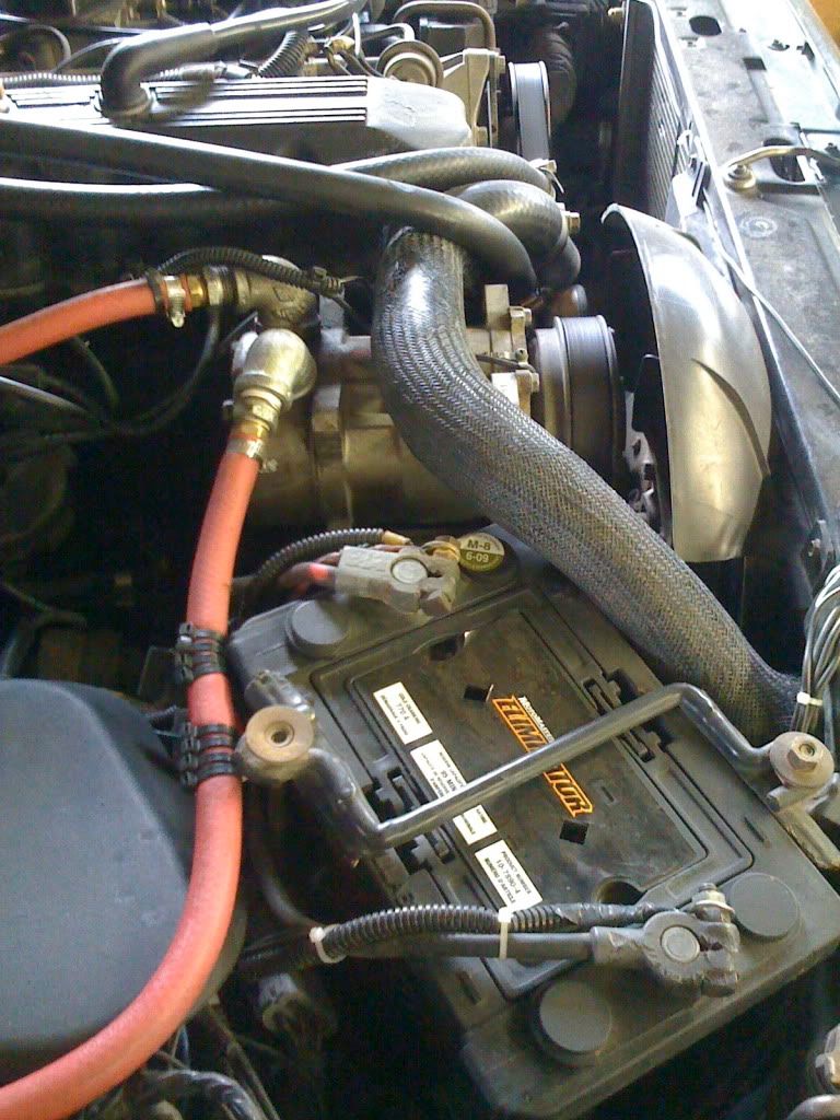

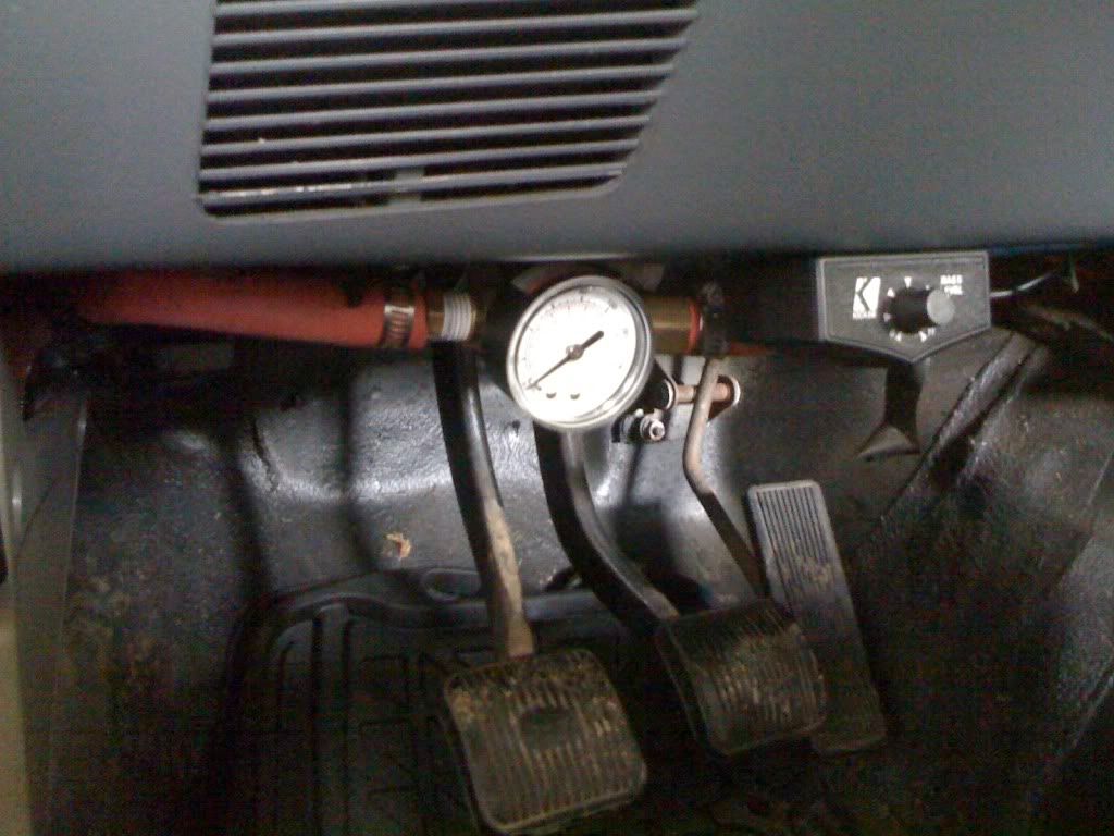

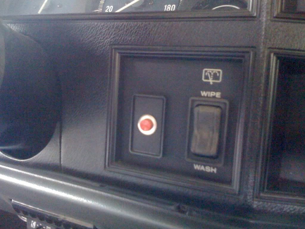

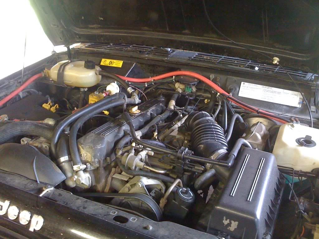

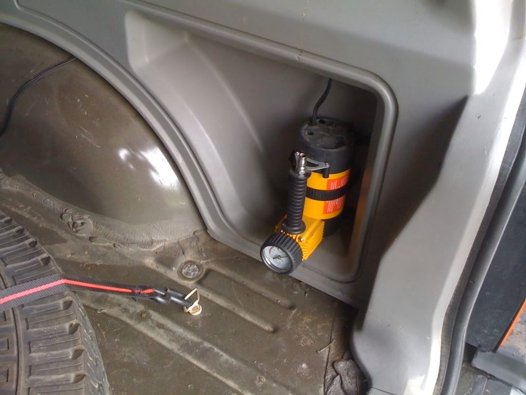

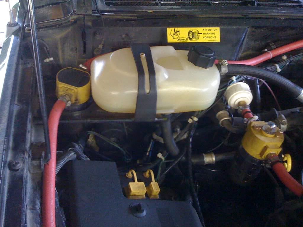

Current upgrades (feel free to ask if the pictures leave things unclear...never touch the little red button):
Yes...there is 2 sources of air, I like redundant systems lol. The CB wire and rear electric pump wire are currently laying like that as I have some trim bits removed to paint the exterior but once reassembled the wires should be out of sight...I'm a little OCD with my jeep and wires laying in plain sight gets to me . The little red button is for my homemade immobilizer and the large red safety switch is for the engine mounted OBA. I am an electronic engineering tech by trade so gadgets and gizmos are right up my alley.
1990 Black 2 Door, Homemade 3" lift, 31x10.5 BFG AT's on rock crawlers, recovery front and rear, bed lined interior, rockerless, armored rear quarters, magnaflow muffler, CB, DIY Immobilizer, AC to OBA, Silverstars and a nice rack.

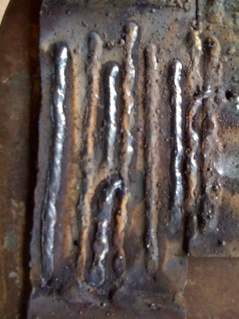

I think I have found a clever way of bolting the rockers in with minimal welding (somewhat similar to a rock slider setup) but still I have been practicing welding all weekend in the hopes that after a few hundred more burnt rods (miller 220v stick welder) I might be proficient enough to weld some ends on my rockers...anything that is going to bear a lot of weight I will let stand for a while...until my welding progresses a little more.

Good looking 2dr. I will be looking forward to your build up.
My 2 cents on your welds, more current(heat), wider arcs or circles which ever you perfer, and slow down a tad. You will get better penetration and stronger welds. Your weld should look more like ))))))))) instead of >>>>>>>.
Thank you for your comments on my welds. I am looking for all the help I can get. I'll buzz thru a few dozen more rods this weekend and try upping the heat a little and go a little slower. Thankfully I have about 100lbs of scrap metal to play with so I should eventually get better.
