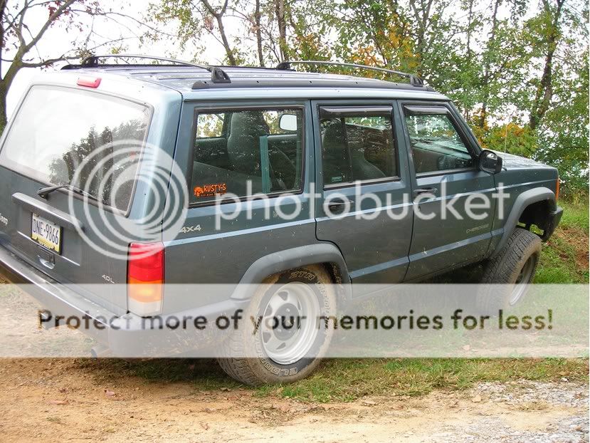

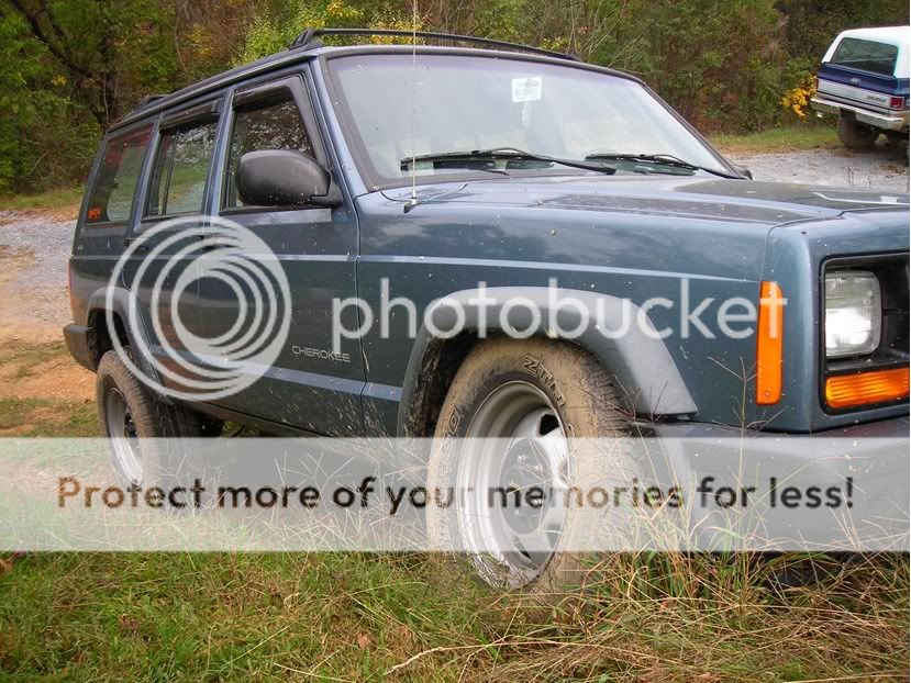

I've got an old set of cooper weather master st's on mine and they're 235's. I think stock most XJ's will come with 225's but 235 is an easy fit. I can only feel a tiny bit of rubbing at full lock and my tread is semi-aggressive. Also honestly, full lock isnt something you do that often anyways if you drive like me ahah
Also, I must say, I agree with everybody else, 235's DO fill out the wheel wells real nicely, I love the look. Heres some pics of mine while it still has 235's on it. I'll be lifting soon and those tires will be gone but I sure as heck won't forget how well they do in the snow Or maybe that was just the Jeep haha....
as you can see it really fits in there nicely
