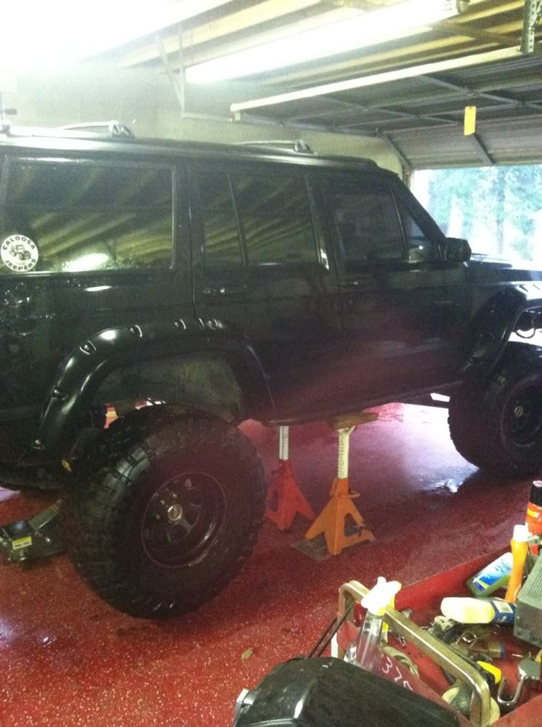

I got my 92 cherokee a little over a year now. I traded a lifted wj that i had for this jeep and everything was mostly already done to it and I have decided its time for my to do some things to it. Its currently running a 8.5 rustys long arm kit with some 35x13.50 TOYO open countries.
I noticed that one of my leaf springs were sagging a little so that gave me an excuse to get a new lift set up
In this new lift set up i hope to achieve a few things
1. I drive this to and from school a good bit which is 45 minutes away so i want some smaller springs and maybe get a little better ride rather than the crazy stiff 8 inch coil springs i currently have.
2. The new lift set up ill be doing will be lowering the jeep about 1.5-2 inches wich will make the jeep a little more stable. 8 inches of lift is just to big for 35s.
3. Hopfully the softer springs will allow a little more flex also.
So i ordered some goodies this past weekend and they just came in tonight.

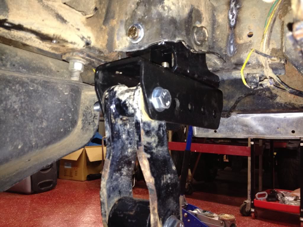

Some RC 6.5 inch springs and shackle relocators!
Ill be putting a 3/4 inch spacer/isolator on top of the spring so have aroung 7.25 inch lift in the front
A few months ago I got a deal on some new 4.5 inch RC leag packs on craigslist. So i will be using those along with the 2 inch shackle i currently have and the shackle relocators I just got. So i hoping I will be able to match the same 7.25-7.5 lift in the rear to get it as close as I can to the front.
Ill be putting all this on either tomorrow or friday. I am also waiting on some anti roll TRE spacers and Bar Pin Eliminatiors to come in before I start on the new front suspension.

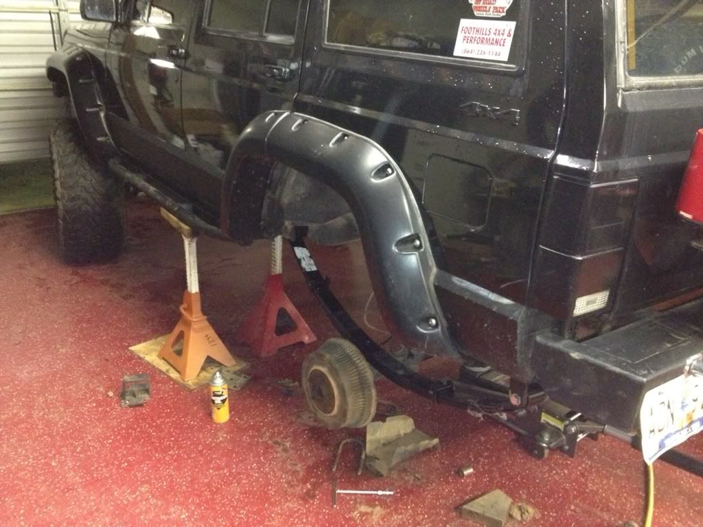

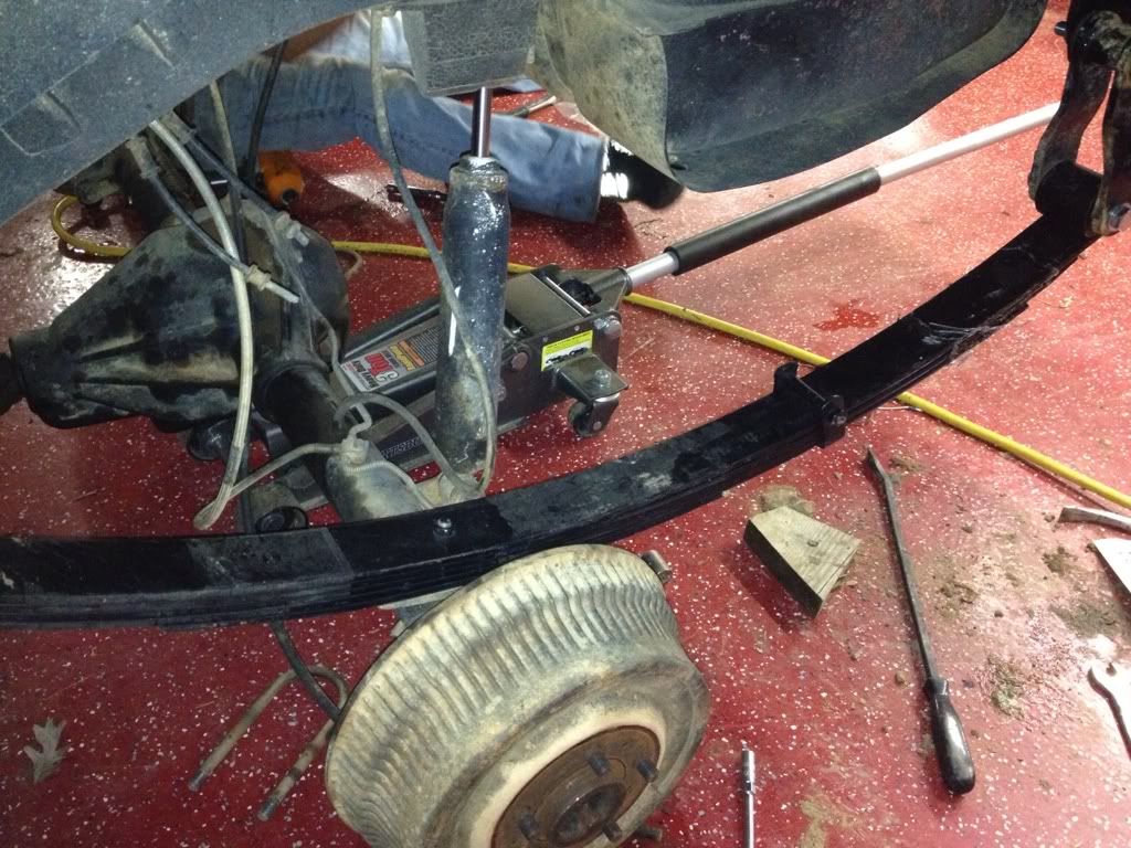

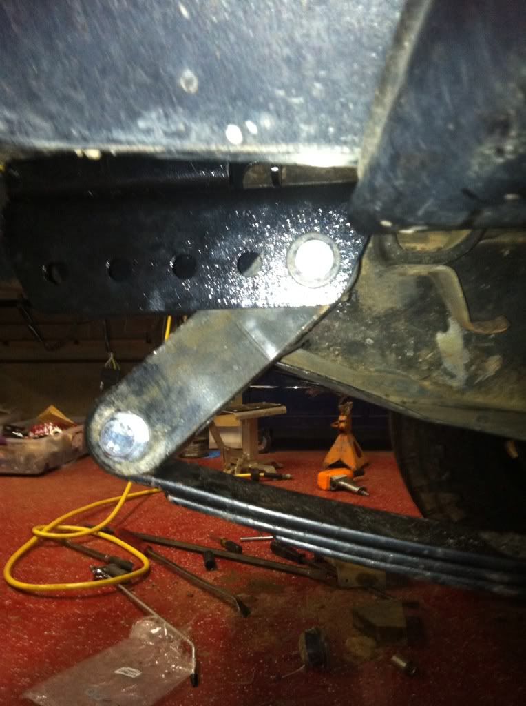

Got the Rear done last night. Went pretty smoothly other than getting a bolt cross threaded and having to re tap the hole. Im very satisfied at how it turned how and how it sits. It dropped the rear about an inch and a quarter so its sittin at around 7.5 inches of lift. I expect the springs to settle some and may have to move the shackle back one hole in the relocator when they do. But here are a few pics.
Before
After
Jeep Squat!
Gonna need to do some trimming. Only has about 2 inches up travel before the shackle hits the bracket when the shackle is in the far front hole.

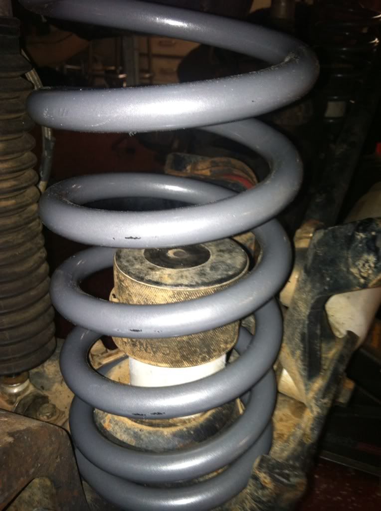

Thanks man. Just finished up the front springs on the jeep tonight. It all went well and i ended up at about 6 and 3/4 in the front and 6.5 in the rear. Once the springs settle some i may replace the .75 spacer with a one inch spacer and move my shackle one hole back on the rolocators. The relocators turned out nice I really like how its changed my shackle angle and all. Since my shackle is in the hole at the very front i only have about 2 inches of up travel before the shackle hits the relocator bracket. So i will either have to trim or move the shackle back a hole to see if that will work but here are a few pics from the project.
Check out the spring difference!

Moved the shackle one hole back on the relocator. Im not going to need to trim the bracket any to be able to stuff my tire. Which I was glad about that. Added about 3/4 of an inch and is now at about 7.25 and I really like how the project turned out. Rides 10 times better. Got my JCR Tie rod spacers today so I will be putting those on tomorrow.

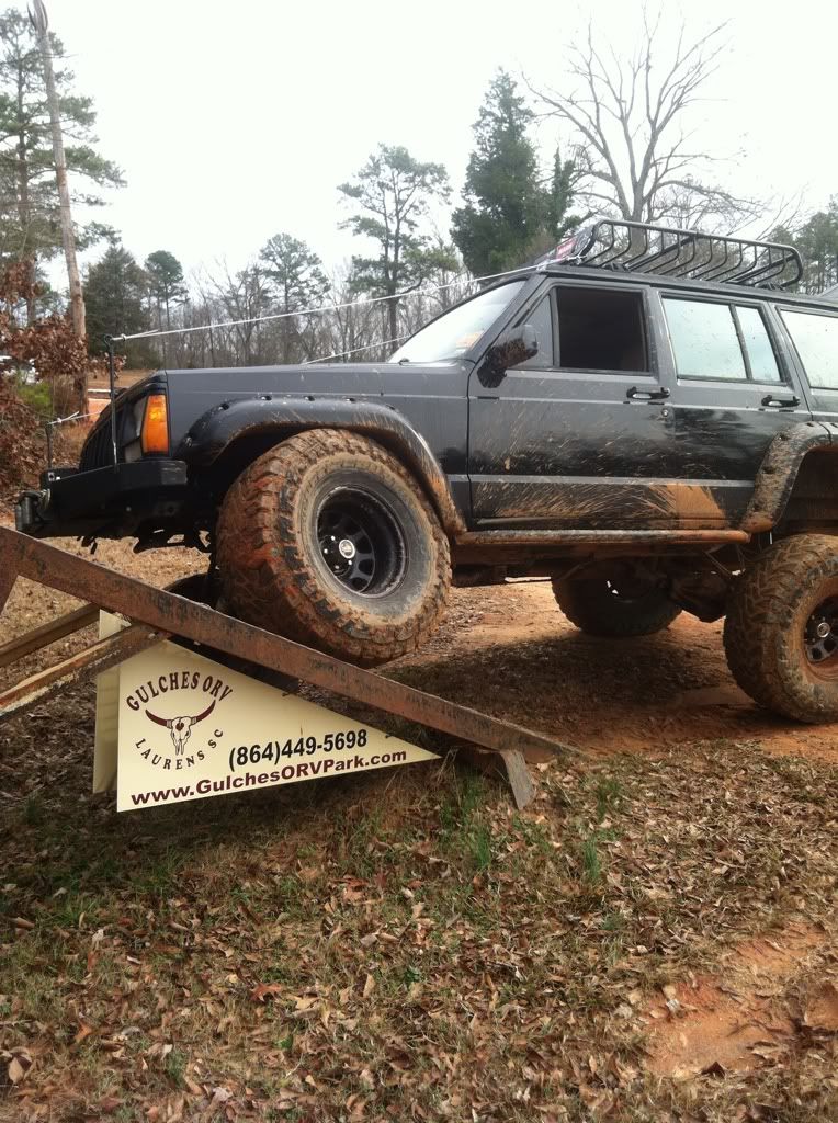

Went to gulches ORV in Laurens SC Thursday and friday and had a little camping trip. Few pics from the trip.

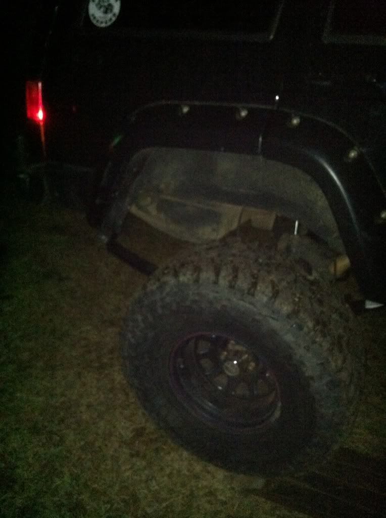

The morning i was suppose to leave for the wheeling trip I realized my trac bar mount was now too long and was hitting my tie rod when flexed. I had to take off the mount and cut 2 inches off with a sawzall. I then redrilled the hole and mounted it back up and hooked the trac bar up. Now i will need a stock jeep cherokee pitman arm to raise my drag link. Ill be going monday to get that and a durango steering box.
The only issue i experienced was the trail in the second pic above. My rear leaf un loaded and shackle went forward and I was stuck because i couldnt back up or i would have broken my new leaf spring. I just hooked my winch to a budy parked above me and winched myself up a foot or so then made it up the rest of the way. Going to need to weld in a limiting bar to stop the shackle before it going past a certain point. I will post pics of the durango swap when done.
