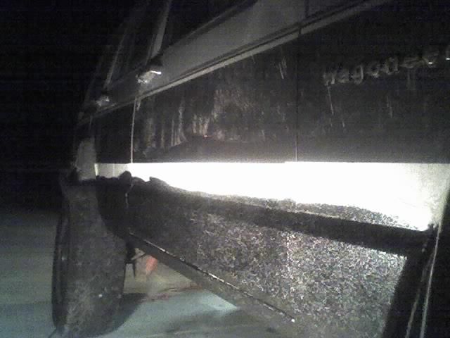

Here is mine, did it with Herculiner. First one is preped by buffing. I did two coats, six hours apart rolled on. Then I let it sit without driving it for 4 days. It came out flawless.

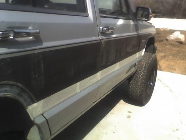

i'm no painter so..
This may be a dumm kwestchun, but I want to do this right when it warms up...
You need to take off the tape between coats, right?
Looks great by the way!

I agree, Herc is pretty good, thats what I use, but be sure you 1) Stir the liner well to evenly space the rubber particles 2) Prep well with turpentine/paint thinner, scuff the surface so the paint looses it waxey finish 3) Paint and roll on two thick coats

I didn't, I also got some pretty expensive painting tape though too, and I did it in 20 degree temperatures, since I see your in Cape Cod... it probably wouldnt hurt
