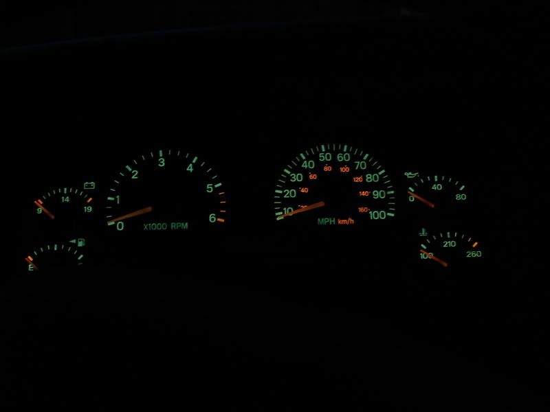

IMO, theres nothing wrong with changing the look of the factory gauges. I hate the stock illumination. So I fixed it.

^ x2!! What did you do? Those look great. LED bulbs??

That LED conversion does make it much more vibrant and better looking. Good Job! I as well as 98ia-xj would like the white face for day driving, I like the looks of it alot. so this kit was a pretty good matchup for me.

WRONG! LED light swap. I also did the tcase and tranny lights, but they failed badly.
Electrical 97+ XJ Interior LED Conversion - WebWheeling.com Forums
That will answer everything ^.
