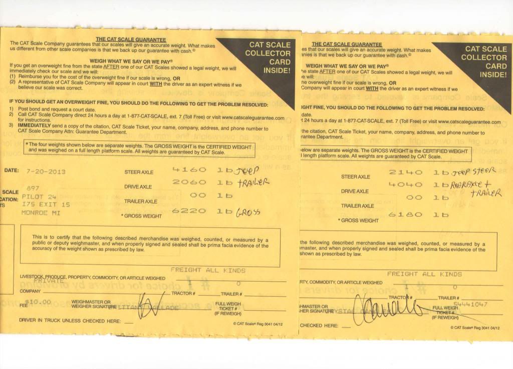

TRAILER WEIGHT:
You show a location of central Ohio. Roll the truck into ANY truck stop. EVEN TODAY!! most of the name brand truck stops along the nearest interstate will have a platform scale.
(I have done this with my own XJ when setting up my camper at a Pilot truck stop) The XJ wheelbase is too short to split all the axles on to their separate pads, but the truck will fit on the front axle pad, and the trailer will be on the drive tire pad. Just pull into the TRUCK side of the place and look for the scale. Pull on and park. There will be a call box on a post (at truck window height) Jump up and smack the button. when they come on and ask if this is the first weight, say, "FIRST WEIGH, PERSONAL VEHICLE." They will tell you are good to pull off. Go park, go in to the Truck fuel desk and get your scale ticket, pay $10.00.
Now he will know for sure what the trailer is. IF HE IS OVER the magic 3500LB, turn around and rethink what he is taking, for he WILL NOT get there..
For your benefit, and those reading along, attached is the 2 scale tickets from my stock 2000 XJ pulling an enclosed 10x6 trailer with a 600LB utility quad inside. This trailer has a 200LB tongue weight, and the truck is empty.
