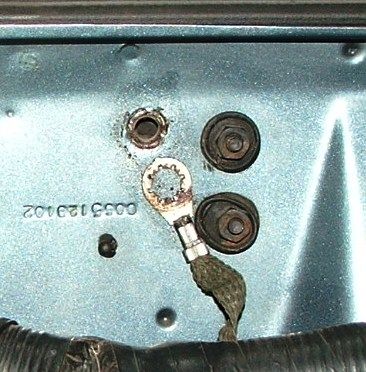

You may want to check the bonding strap that goes from the firewall to the left rear cylinder head bolt. This bonding strap is intended to be a radio interferance suppressor. The following pics are of my bonding strap. My connection at the firewall was pretty corroded. The connection at the cylinder head was okay.
After removing the corrosion from the firewall and the strap ring connector I installed a stainless steel bolt and washer.
Rusty firewall bolt:
Rusty ring terminal and firewall:
New stainless steel bolt:

Good Golly Ms Molly: ( I couldn't let that go withourt a comment) You really opened one up. Some good responses, unfortunately they don't answer your question.
In general, I would agree with Ken above. He points out a valid issue, that should be addressed. However, if that were the main issue you would have static all the time. Your question stated it was just near power lines.

He also said: "The noise becomes less noticable when I apply my brakes. Is this a grounding problem?"
