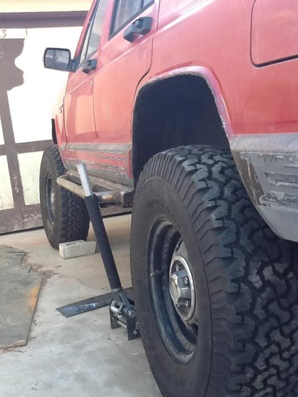

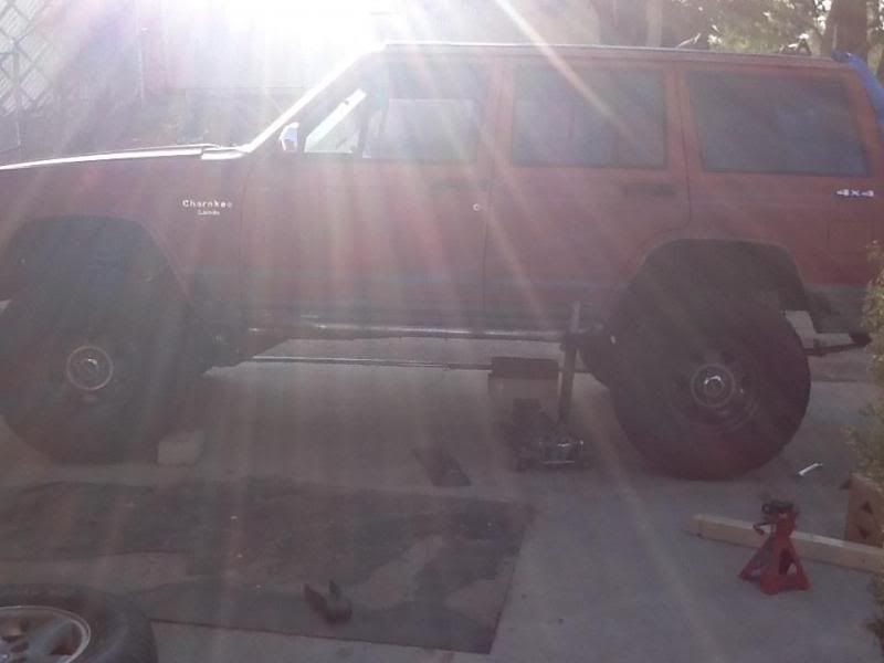

I'm running 3" and 33x10.5s currently...actually I'm dropping ins down some. I have custom deavers with a 7.5" long shackle, with HD no lift relocators for the rear. Up front is a RE 3.5" coil with adjustable arms and drop brackets. I'm going to drop the front down about an inch since its sitting higher than the rear currently by around. 1". Ill post a pic I snapped yesterday. My rigs a build in process still.
Overlanders do it over land via overlanding because they like to overland?

This pic make its look taller because only the tires on the driver side are on, so its leaning a it making the gap at the wheel wells bigger. The first pic is how it truly is. Even still you can see he fronts taller, and my basic ride height.
I'm 6'1 and am still taller than my jeeps roofline. The roofline on my 93 2500 4x4 suburban on 235/85/16s is actually a few inches taller still. Again that's at the top of the roof.
