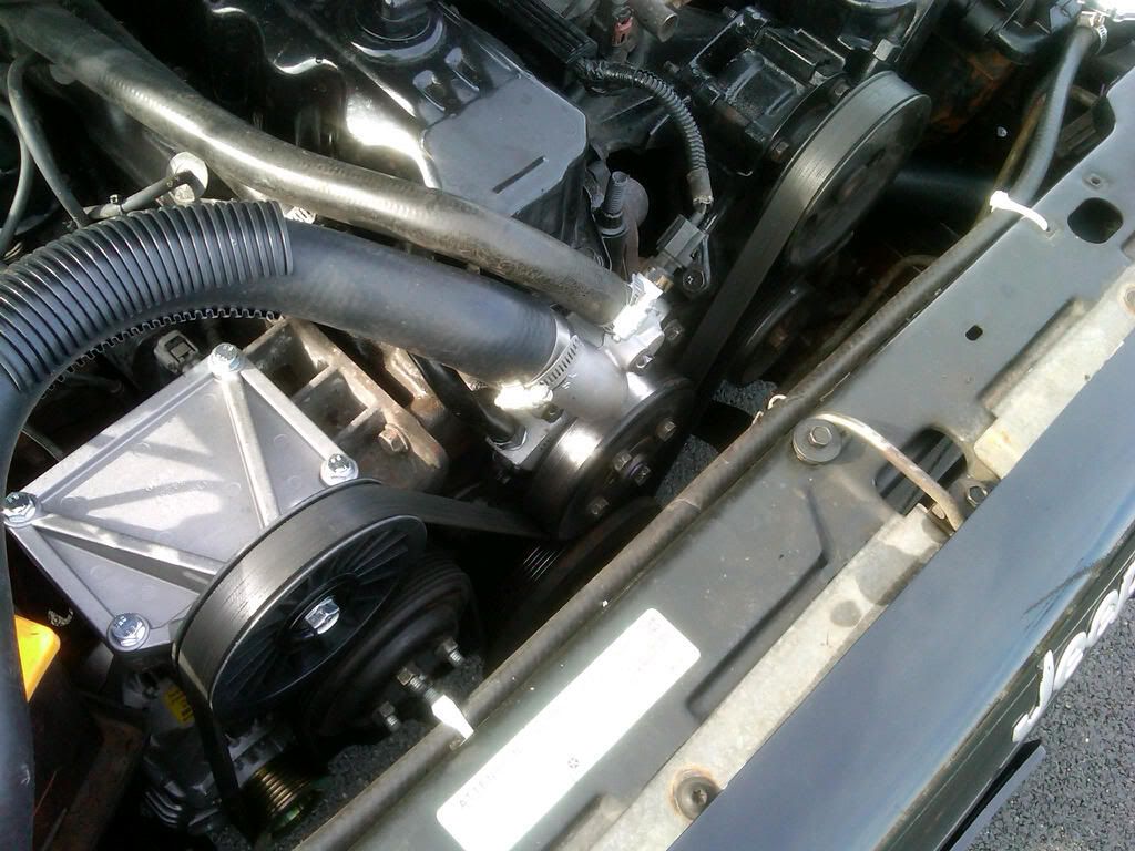

post #14 of 14 Old 11-13-2011, 05:08 PM
kade
Location: Chicago
Posts: 961
just got it done today
http://shop.advanceautoparts.com/web...7CGRP60000____
And the green stuff from condenser is not coolant its ac lubricant
