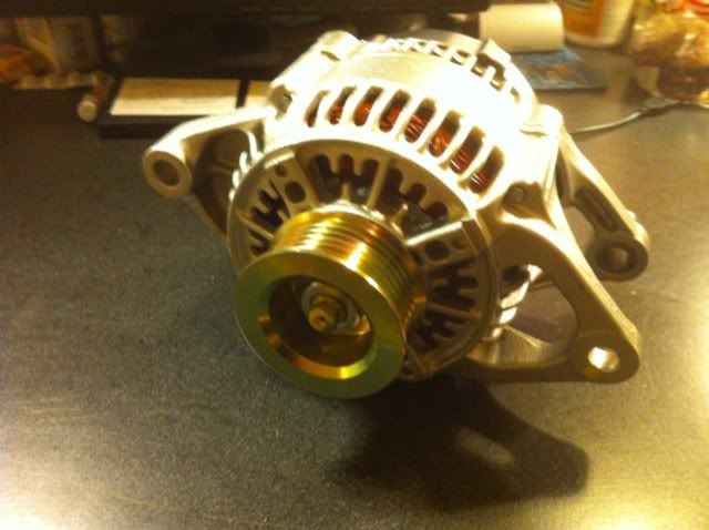

Once again, looking to the ultimate source for help here. Yesterday, I started my Cherokee and within a minute, it was at 9 on the IP voltmeter, and the Check Gauges light came on. As I let it run, the needle came back up. I left this morning to drive home to Maine, and about 160 miles into the trip, the voltmeter needle dipped to 9 and the CG light was on again. I stopped for gas, and it was normal again. Then the dip. Stopped for coffee, looked around under the hood (had no tools, as i had the kids and their Christmas gifts in the back), so as long as nothing obvious was wrong, I would keep driving. The needle dropped again, the CG light came on, and remained on for the last 140 miles or so, even with the headlights on. I am leaning towards the alternator starting to go out, but it did make it home. The lights were dimmer, but still on. If there was 0 charge, I doubt I would have gotten that far. The battery is almost 2 years old. And I have had some loud squealing on cold starts, which I thought was the belt, but might have been the pulley bearings. Any and all thoughts are appreciated, as always.

I'd say alternator. My friend's Ranger did the same thing about a week ago. His lights were so dim you could barely see them. Turns out he was running soley on battery power. I'd go for the Autozone remanufactured alternator with a lifetime warranty. I have one in my Jeep and its been good so far.

Thanks!! I'm going to go either AZ or Napa, depending on who has it in stock. Looks like a fairly straightforward swap out. Do they come with the pulley, or do I need to buy that also? Just curious

Autozone had mine in stock and it came with the pulley.
Edit: I'd also take out the battery and battery box. Made taking out the alt so much easier by just lifting it up through there.
