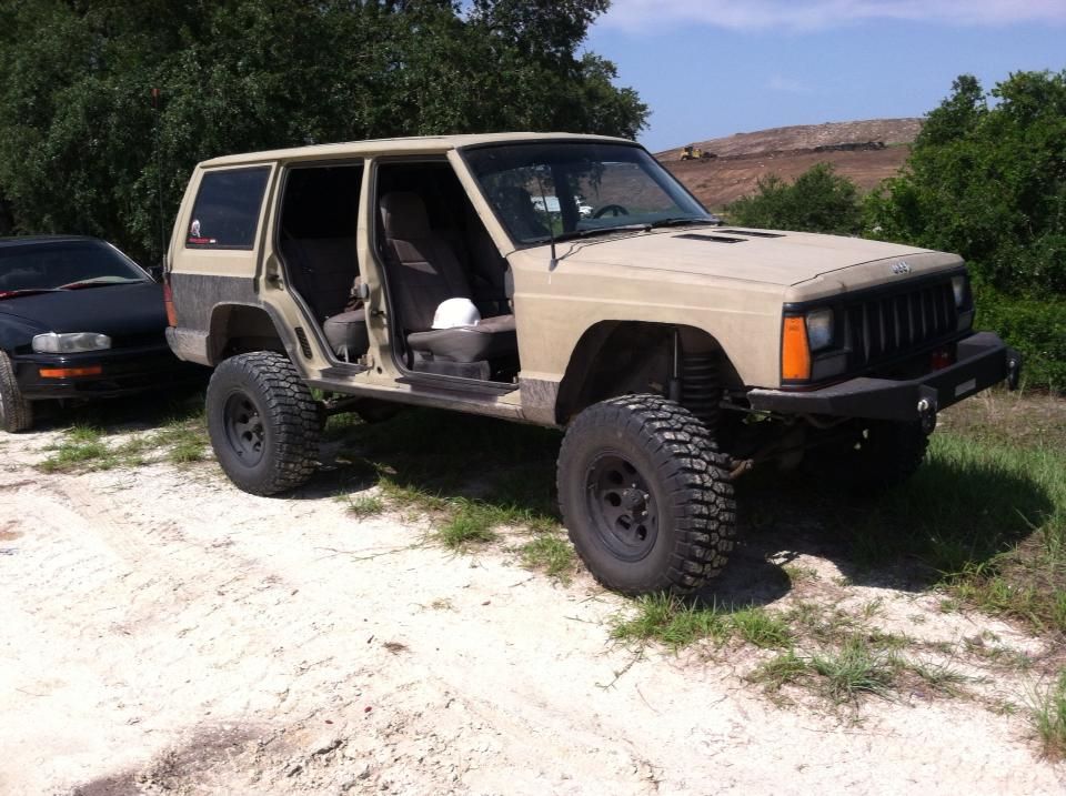

Did this just for you! Lol

Heck yea ... Welcome to doorless you will love it man .... So much better

Ok ok, I might have to pull my doors off now. haha
You really should ....

It really is nice

It's soo much better and way more fun. Kinda lucky we are in fl, I don't even put them on in the winter ... I just got a sweet jacket .... And maybe some cloves if its really cold .. When it's cold ... It's kinda like skiing just in a jeep in fl
