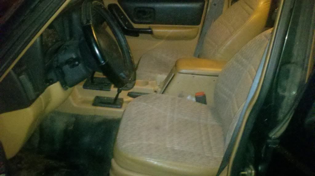

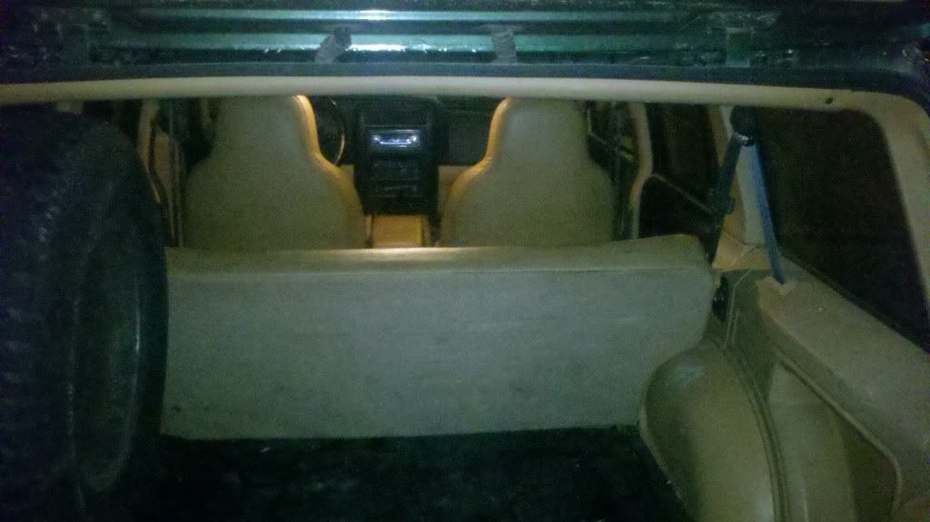

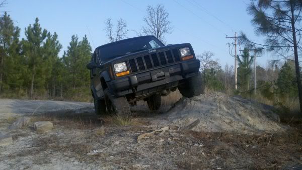

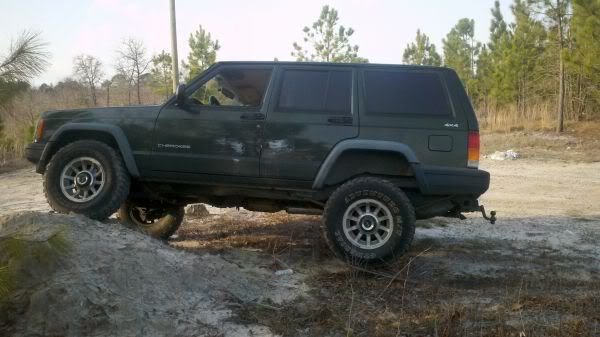

post #12 of 153 Old 08-15-2012, 02:18 PM Thread Starter
Tylerzap
Location: Asheboro
Posts: 903
Owner said marks on door was mud from neighborhood kids.
What yall think?

post #14 of 153 Old 08-15-2012, 06:09 PM Thread Starter
Tylerzap
Location: Asheboro
Posts: 903
Im going to try! What do you think of the condition? I dont know much about XJs. Im going to go buy it saturday. A man is coming to buy my CJ7 tub and some other parts Friday.
My 98 XJ "Zap" Build Thread
1988 Jeep Comanche 4x4 Longbed - POS
Tylerzap is offline
post #15 of 153 Old 08-15-2012, 06:14 PM
Altimeter
1997 XJ Cherokee
Location: Concord
Posts: 594
It looks to be in decent condition from the pics. It is a used vehicle, so you always take some sort of risk on buying one. For $800 that risk is relatively small.
