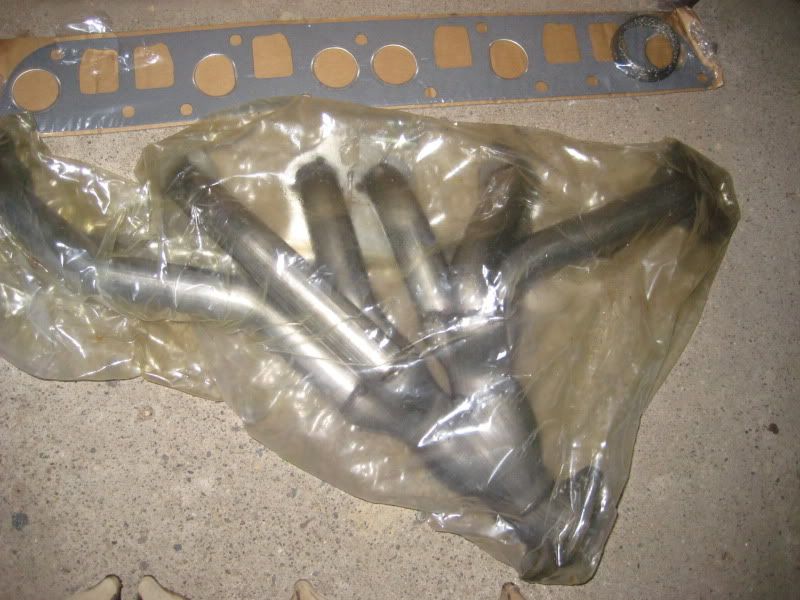

APN header install

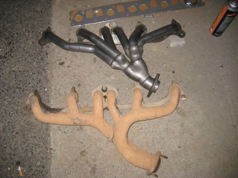

so the night before our show, i decided to install my header that i ordered. i went with the APN header, heard of the great reviews, price and quality of the product so i went with it after waiting forever to fix my cracked exhaust manifold. it was $160 shipped to me and it got here fast.
so off to the install. i had my buddy Mike help me install it since hes got all the tools and a garage.
the goods

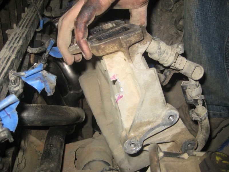

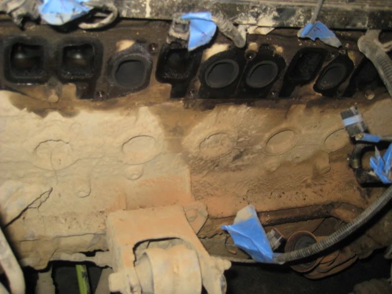

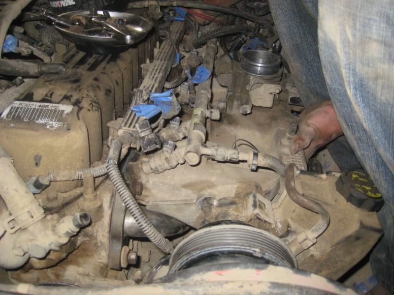

first thing your gonna want to do is mark everything with tape and label them for the reassemby later on. injectors wires etc. then just disassemble the intake and move it out of the way. then loosen the belt and disconnect the power steering pump and just move that aside. from there you can just start unbolting the intake and exhaust manifolds. use a lot of extensions. i belive we used 14mm for those bolts. then clean the surface of the head after removing the old gasket. pardon my dried and muddy engine bay.

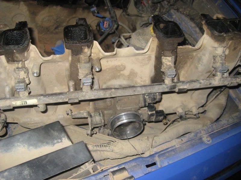

the intake manifold set aside

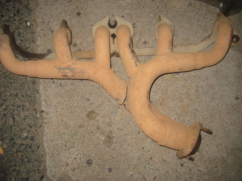

once you have both manifolds removed look and compare. a world of difference.
the 1" crack on my manifold went completely around the pipe. yikes
reassembly is pretty straight forward. clean surfaces and reinstall new gasket and the donut seal.

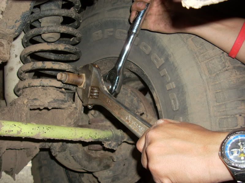

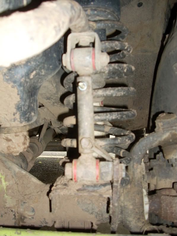

yesterday me and a buddy tackled putting my JKS quick discos. putting them on was a breeze. taking the old ones off, thats another can of worms we didnt want to open, but had to.
note to self fellow jeepers, wash your jeep lol. anything under my jeep looks like a found artifact with all the dirt and dried up mud. so the pics.
these are my old ones. i believ they are from 4wd hardware. the middle section is a pain to disconnect/reconnect. and the bushings dont really merit much movement to help ease the reconnecting process
disconnected to help somewhat with the removal
these helped
Mike felt the need to take a pic of my RTI ramp score.....o wait thats his. its just funny that we got the same score and his jeep is much bigger hah.
this part was kinda stupid on my part. completely forgot that these werent threaded in and a few whacks with the BFH got them out. im a retard.
my mechanic hard at work envying my rig lol
and TAH-DAH JKS discos installed. took no time whatsoever to install these. the greasable bushing makes disconnecting/reconnecting a breeze. i might actually disconnect when i wheel now.

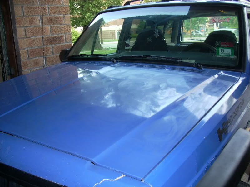

o and while i wasnt looking Mike decided to wax half my hood
so i had to even it out
at least my hood is now waxed while the rest of the rig is dirty and muddy.
