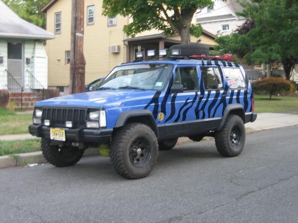

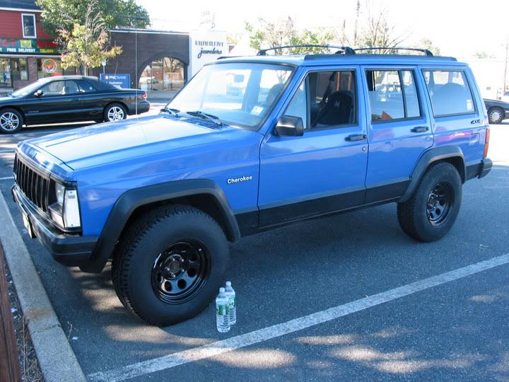

figure id start one to keep track of the upgrade/fixes ive done. background on this rig. 1996 XJ sport. aw4, 231 t-case,hp dana 30 front, 8.25 rear, bought for $3000 and it was MINT. no rust or oil whatsoever. bought it so i can drive all my stuff from school in FL. from the day i took it home and the first mod. good ol clear corners and delete of red side trim.

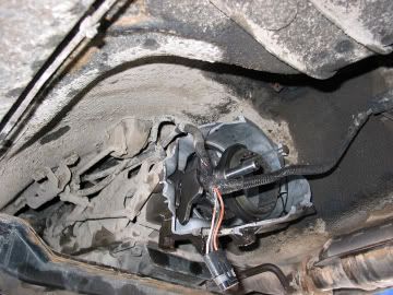

weeks later, BAM this happened. like a soda can ripped in half, twisted and snapped driveshaft, cracked bellhousing, and $2000 later
that sucked.

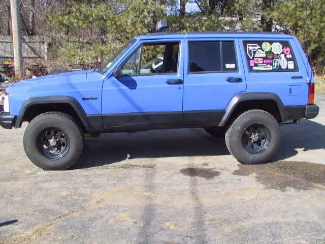

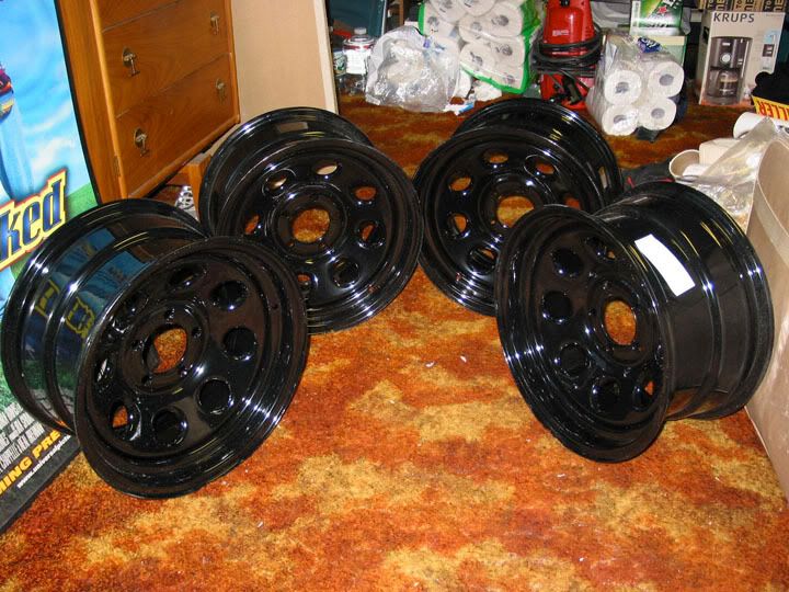

fast forward, drove home after graduation. suspension is shot. so wat does this genius do? fix suspension? nah, get bigger meats! wheels, soft 8s
whoo! look at that carpet, and no it doesnt match the curtains.
then the 30x9.5x15 ATs

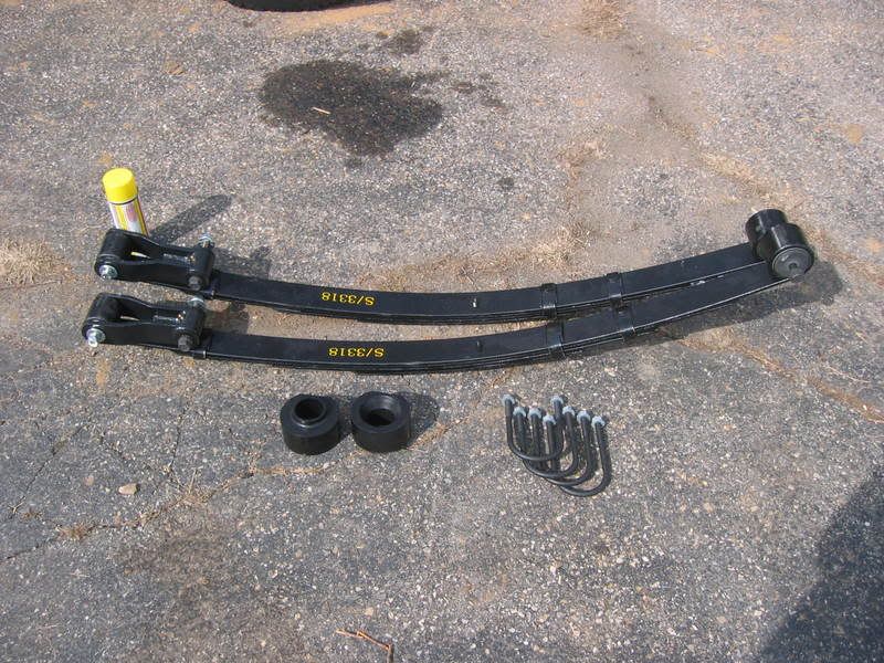

of course it turned it into a 2 seater cause i couldnt carry anyone else in the heep without the tires rubbing. half a year later. teraflex 2" BB and Quadratec HD leaf packs.
air tools, breaker bars and beer are needed. before the lift, uugghh look at that sag.
after the lift, yowza!
She's a 96, 4.5 inches on 33's. 30 front, 44 rear, armored & wishin i can wheel it like i stole it.

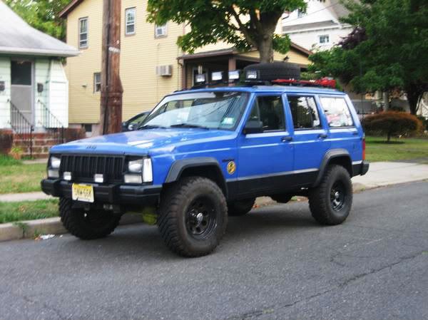

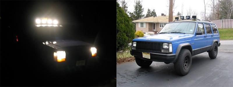

i skipped a step. i forgot that i threw on lights up top b4 the lift. here they are.
switch for the roof lights.

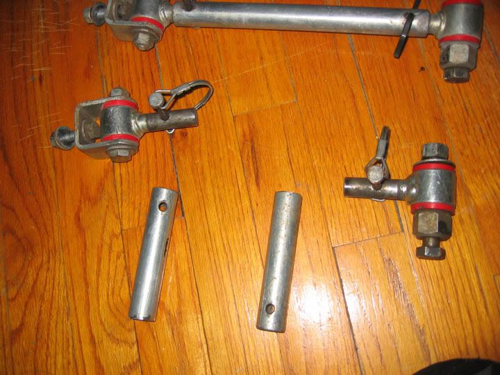

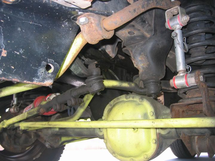

then i got bored and painted the steering links and diff covers and control arms. then i got a hold of some sway bar discos. 4wd hardware i believe. they were for 4" lift so i cut them in half and had my gf drilled at her work. here they are installed.

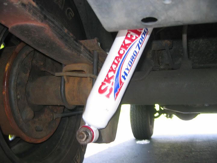

snazzy i think. then i replaced the rear shocks with skyjacker hydros (for lifts 0-3")

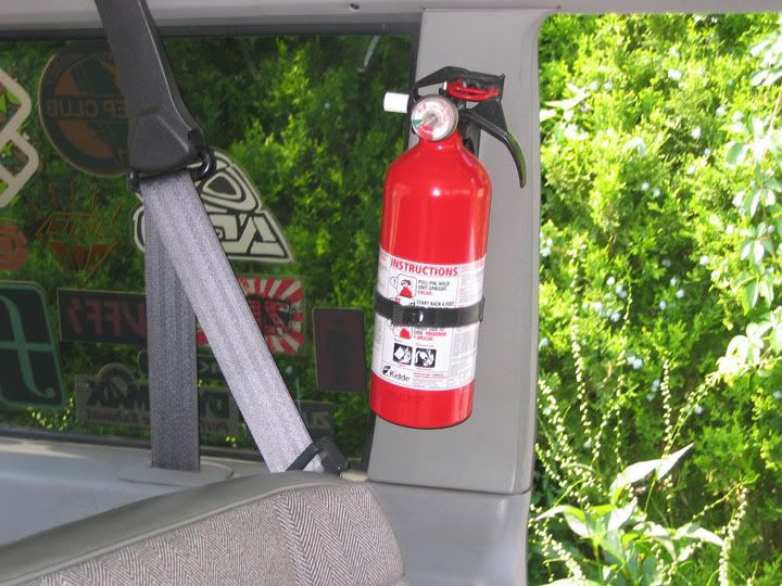

they ride nice. then it was time to start checking off some requirements for my jeep club. fire extinguisher

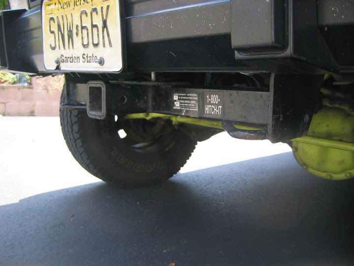

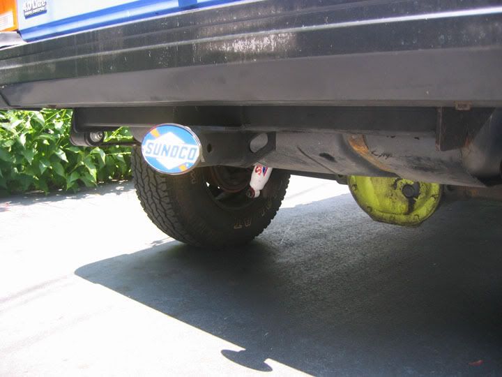

front and rear hitches

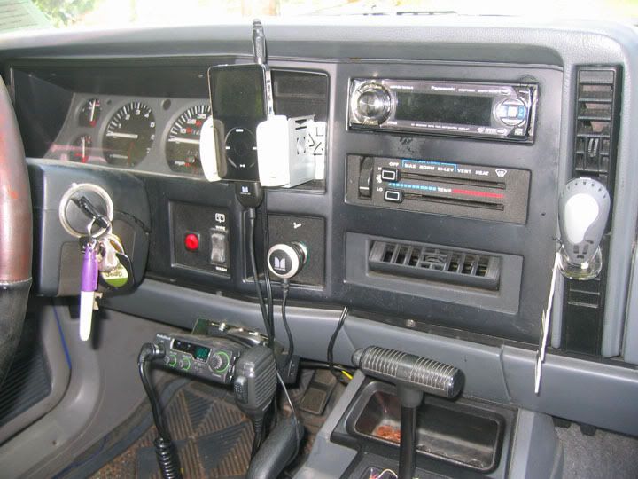

cb radio and a 4ft antenna. i also made a homebrew ipod mount.
i got a mopar roof tire carrier and mounted my hi-lift jack on there with exhaust clamps. i actually just sold the tire carrier. but i had no problems with it.

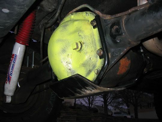

to protect that new asset, i got a Rock-it 44 diff glider. this unit bolts up in 5 mins. it literally took longer for me to get my tools out. i will change over to a HD diff cover the next time i change the fluid in the diff.

Nice evolution. I like the top lights. Dumb question, but when you ran the roof lights, how did you run the wiring?

thanks for the feedback guys. without this forums help, none of this would be possible. to answer some questions.
im from northjersey in West Paterson.
for the wires on the top lights, i went thru the door jambs and along the inside trim.
for the lift, i used the teraflex shackle on the quadratec HD leafs. the 7"arch to be exact.
