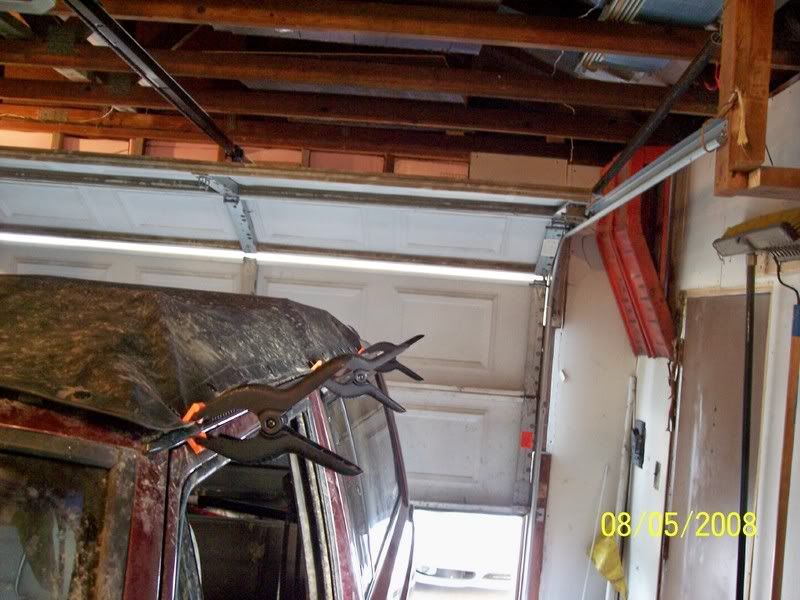

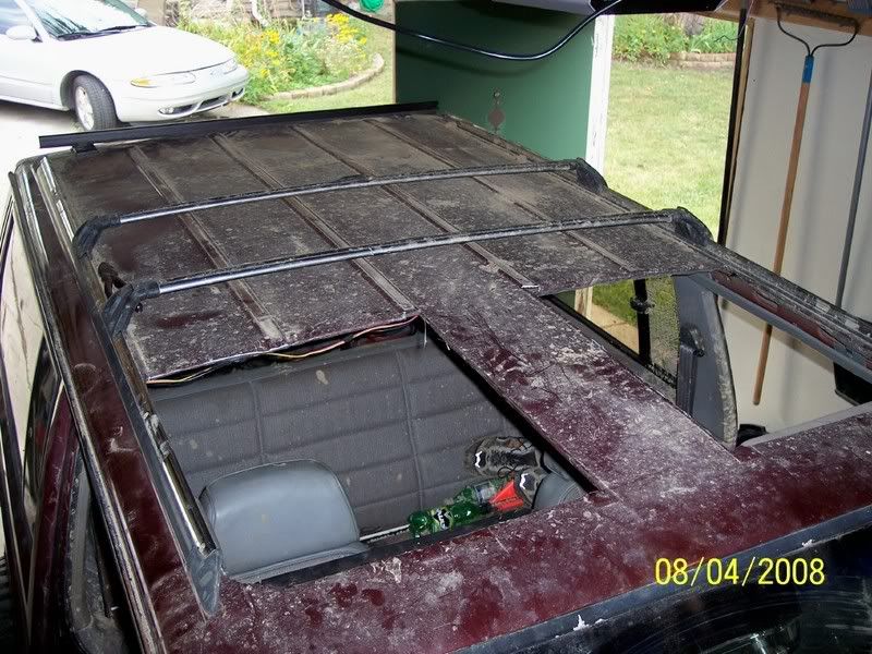

Rear I decided to use an existing bar off the tonneau frame and trim it down to fit between the stock roof rack. Course this could get interesting since the frame is flat and the XJ roof is curved. The sides and front will be snapped down - I took the snaps of the frame and timmed the edges so they will sit more flush with the sheet metal.
No turning back now -

Some more test fitting of the top:
Well its gone in the rear now too. Not sure if i will keep the "T" section in the middle after the cage is installed.
The high tech install tools:
Got a shop around here that does vinyl / cloth repairs and thad them trim the cover width to my specs and stitch it back up. So now the install of the cover can proceed.
Not all the snaps on yet:

For the rear all I did was bolt the frame down after the width was trimmed and it bent enough to fit the roof curvature. Plus with the thick weatherstripping it sealed up pretty tight.
