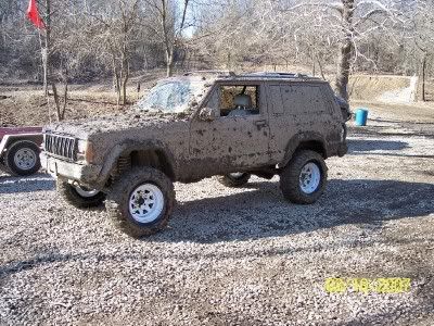

Here is one of its first madien wheeling trips. Did do better then I expected with stock 3.54 gears and open difs.
course here is the rig I teamed up with most of the day - he had to tug me a few times.
boggers definetly fling the mud - went thru a creek on the way out so thats why the rims look clean......
