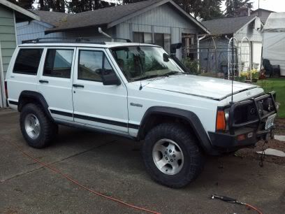

Thank you for the input so far. This is the rig the kit is being sold from:
As you can see, it's an XJ. What if he's using heavy ZJ coils in the front? A friend's current theory is that it's an old, old ARB demo rig from like 10 years ago. Waiting on further pictures -- and build code -- to figure it out. More pictures to follow, if anyone's interested.

Nice looking xj, but that doesnt look like 3.5" of lift to me.

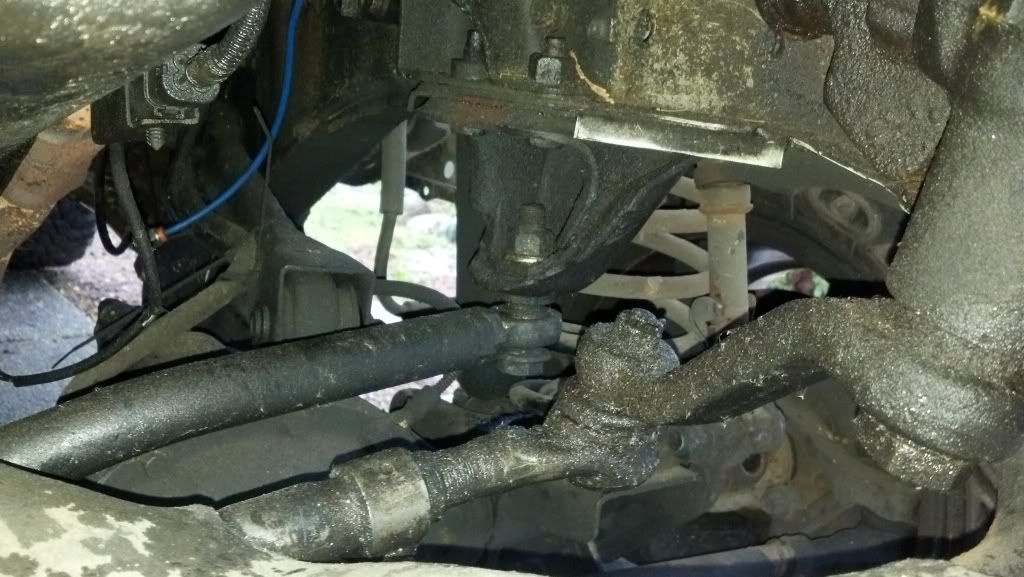

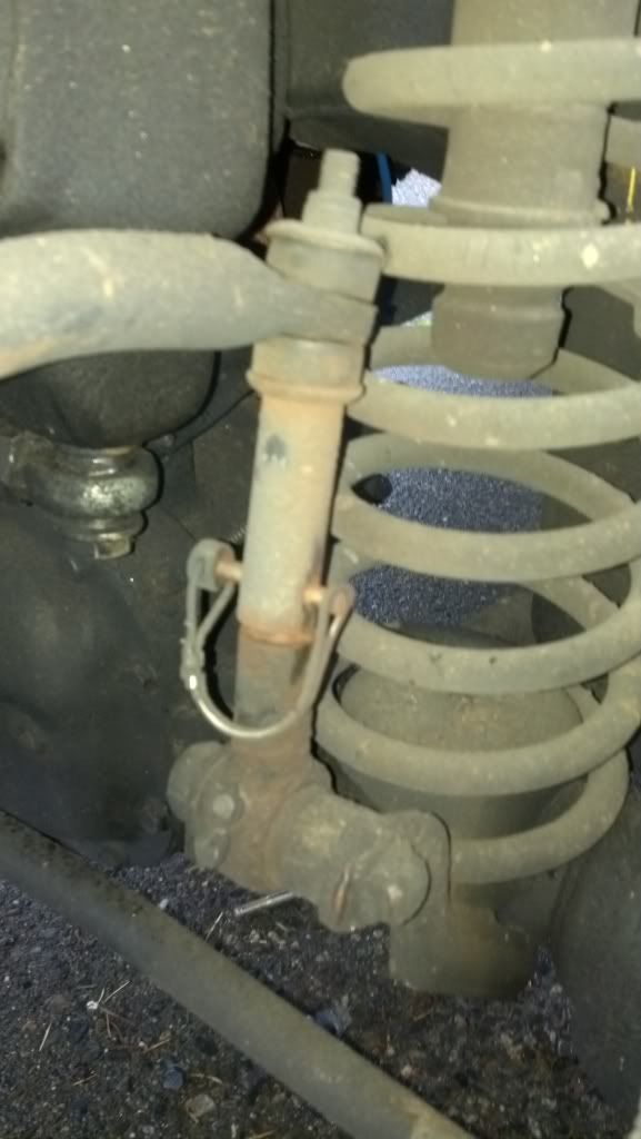

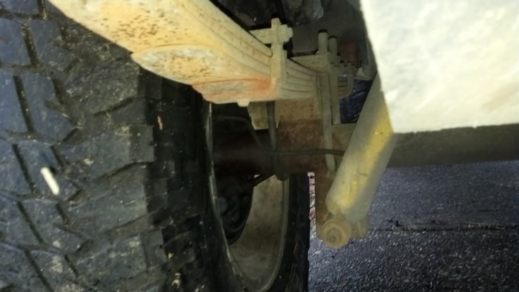

Follow-Up Photos:
Yeah, I'm not entirely sure whether its modded to work or whether it isn't actually 3.5". As research indicates, and as you guys have pointed out -- the product doesn't exist.
Either way though, I think I'll go for it. Worst-case scenario, I'll sell it off.

Posts: 1,545
Looks like a 2.5" kit with 1" spacers (can't see if the coils have any but the leaf packs definitely do). It will work fine, but I'd avoid using blocks in the back and go with extended shackles or an extra leaf instead.

Blocks exacerbate axle wrap, because they act like a fulcrum. The further away the leaf is from the axle, the worse it is. Add-a-leafs or shackles don't cost very much, and blocks are just the absolute cheapest route with the most mechanical drawbacks.
It should flex okay for a 2.5" kit. It's possible that the coils could be for a ZJ lift as they net an extra inch when installed on an XJ, but check for a thick spacer on top to make sure.
