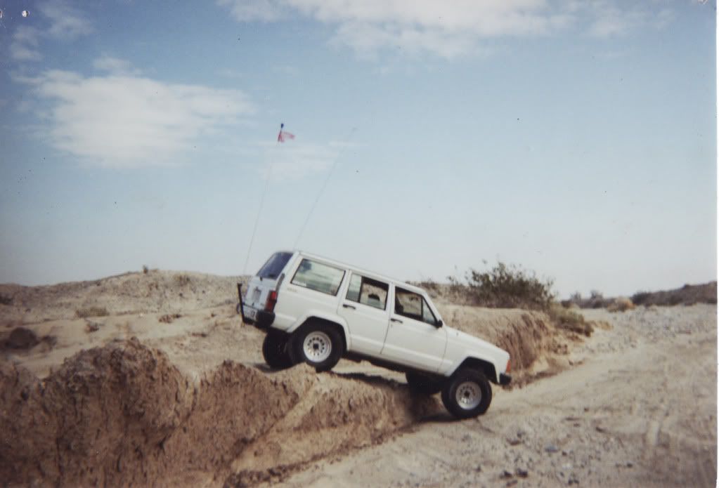

my old jeep 7.5"wide wheels with 31's
best pic i have these were 7" wide wheels with 31's
sold that jeep
now i have
stock hight with stock 7" wide wheels 30/9.5/15's
97desertrunner is offline   Reply With Quote

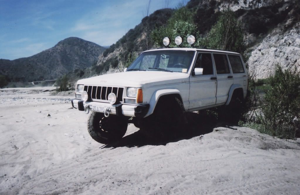

Not the wheels you are looking for but heres my old 92 XJ with a 3" lift. No fender trimming. I dont know the b/s on the wheels as I bought them used..
7.5" wheel with 31x10.50r15 Dunlop Mud Rovers
-Chris
