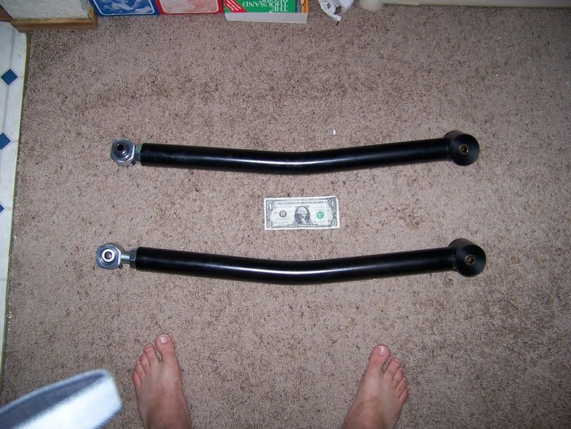

explain .
Yes, please do and cite your sources. My RK parts are rock solid and carry a lifetime warranty. The control arms and track bar are all made from sold stock. The brackets are all made from 1/4" A50. The rod ends are Rock Krawler's Monster joints, which have the highest raidal and axial load ratings of any comparable sized rod ends or Heim joints on the market today.
Any negatives that you find on the Rock Krawler LA design are nothing more than internet myth. It's a superior design to the cookie cutter radius arm front end that everyone else uses. The only kit that is a better comparable is the Full Traction LA suspension. The caveat is that the 4 link design that the Full Traction kit uses will bind in high articulation applications, so it's best suited for high speed, desert racing applications. The Rock Krawler kit owns when it comes to high articulation applications.
Do these parts really look like crap?
