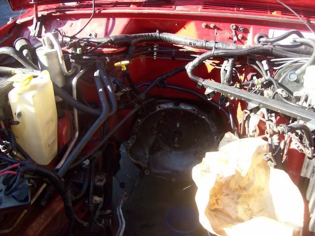

Originally Posted by CJ7-Tim View Post
There are no holes and no threads for the XJ brackets on the TJ/WJ block and the TJ/WJ accessories don't physically fit into the XJ engine bay.
wj
meet XJ
you have to drill and tap 6 holes and shave some off the back of the timing chain cover bolt holes
not impossible
and brown dog sells mounts that will save you drilling some of those holes
when someone offers you an engine with 30k on it, you make it FIT
