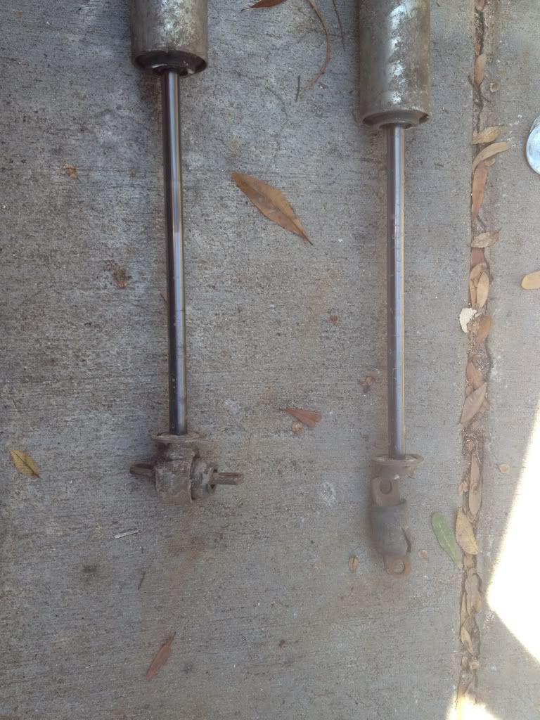

Almost sounds like you have a dead / lost shock. What you have describes exactly what happened when I ripped the barpin off of my RF shock.
Mine did the same thing when I snapped the bar pin on one of my BDS shocks. I was pulling on to the road and turning right and while turning I hit a bump and then all hell broke loose. The tire was just bouncing for a few seconds until I slowed down. I thought it was death wobble at first but I remembered there was a clunking noise I kept hearing while I was driving in the dunes. That was the sound of the shock rattling around in the wheel well as I was driving.
Here's a picture to show what broke.
