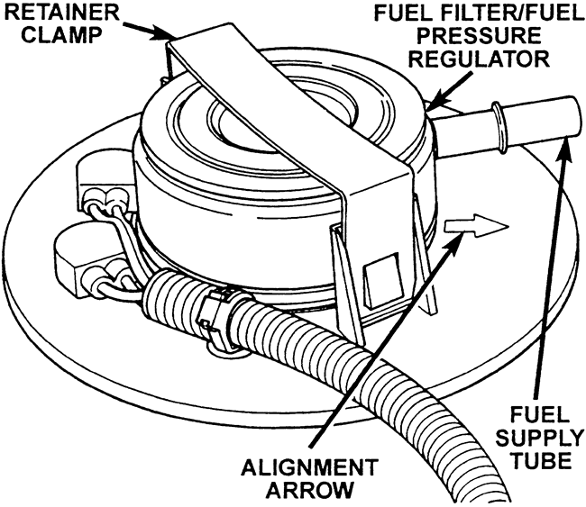

Where in the blazes is the fuel filter on a 1998 4.0 Cherokee? On my Grand Cherokee, it is just a foot or so away from the gas tank in line... Also, is there a way to test the fuel pump? I don't hear it prime/start when I turn on the key and there is NO fuel at the fuel rail at all..

on top of the fuel pump module

1997-2001 the fuel filter is inside the gas tank and is not routinely serviced unless you are experiencing fuel delivery issues.
Apply 12 volts directly to the fuel pump to test it.
What symptoms are you experiencing? There are some common Cherokee sensor failures that result in a no-start situation or the fuel pump not running.
