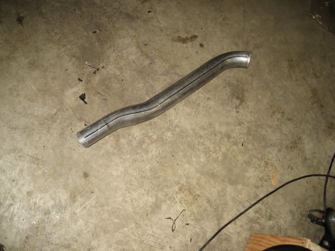

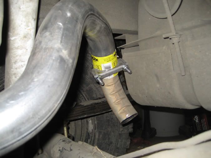

...when you see what i did with my exhaust. so i got everything together and went ahead and put up my magnaflow hi-flow cat. and my dynomax cat-back system. i like the sound; not too loud, but you can tell its not stock when you give it some gas. but, there were some problems. no matter what i did, the tailpipe wanted to sit crooked:

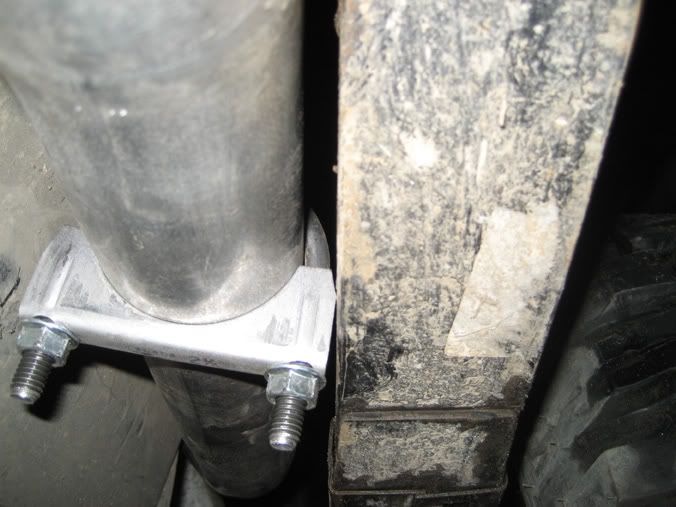

and the last clamp on the tail pipe made siamese twins with the passenger side leaf spring:

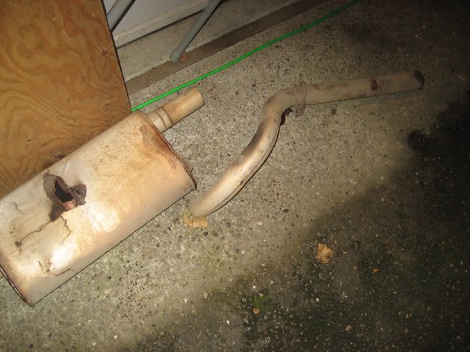

i could not live with this. so that ugly dynomax tailpipe got the cut-off wheel:
and then the old tailpipe got the cut-off wheel as well. i cut out a couple of curved sections so i could decide which one would work best for my downpipe application:

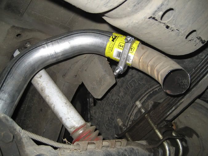

and this is what i came up with:
it goes up and over the rear axle like the stock pipe, then takes a quick turn down and away from the leaf spring right before the gas tank, and points more or less towards the ground. i clamped that old piece of exhaust pipe on REALLY REALLY tight. i dont think it will ever come off. its kind of ugly, but functional because it will not, should not, be hit on any thing because it drops right after the axle. and it isnt too close to the axle so the rear will still be able to flex fine. besides, who cares if its ugly, for the most part im the only one who crawls under and looks. and that stock tail pipe, well it pretty much sucked balls. now i need to clean my garage. stuff has been piling up:
