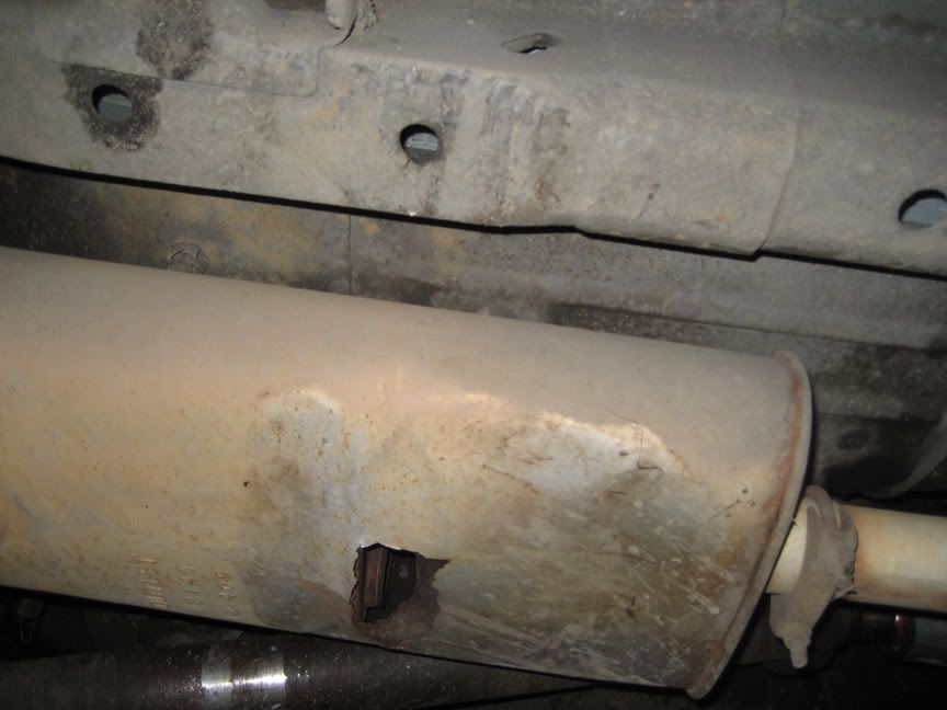

unfortunatley i ordered all the parts for the newer model cherokees. i sent it all back today and in return they will exchange it for me for the right exhaust parts andhopefully refund the rest of the money back into my checking account so i can put it towards my drivetrain overhaul.... what a waste of a day.
this is how my muffler will be for another week atleast...
but hey, they sent a complimentary gift with my order...
in the end, i still think its got a mean lookin stance right now...

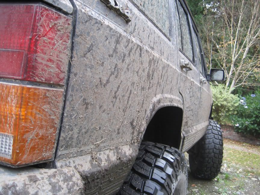

Just A Few Pics:

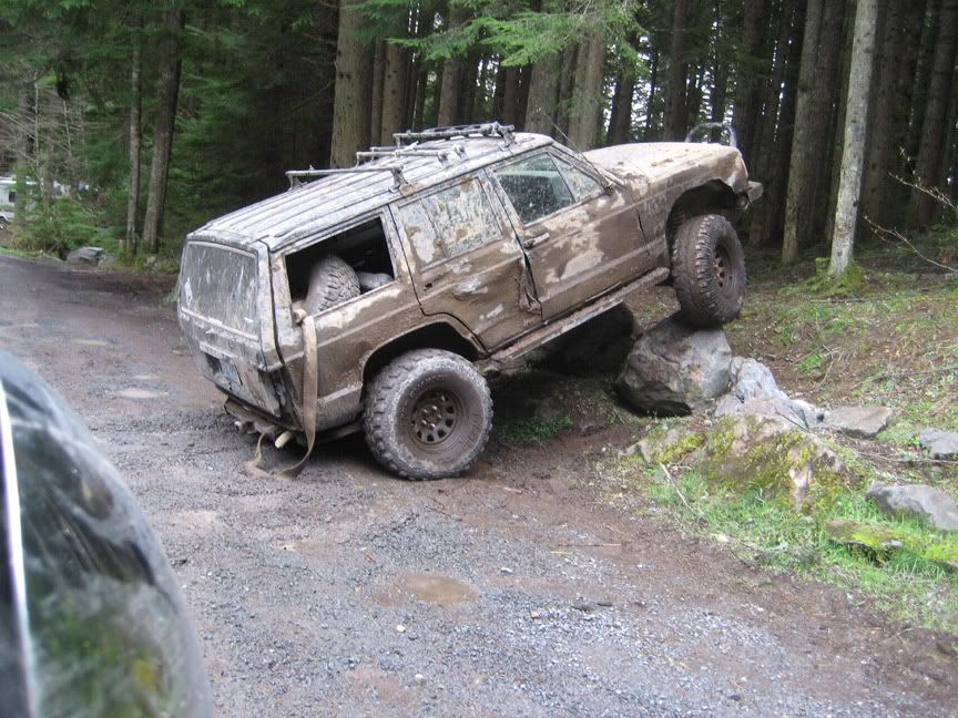

wanted to share one of my cherokee inspirations. this thing looks like a beater but it wheeled like a beast. this was up at elbe.

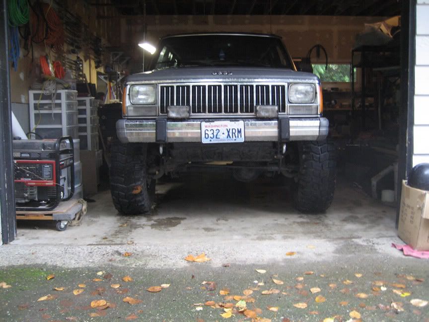

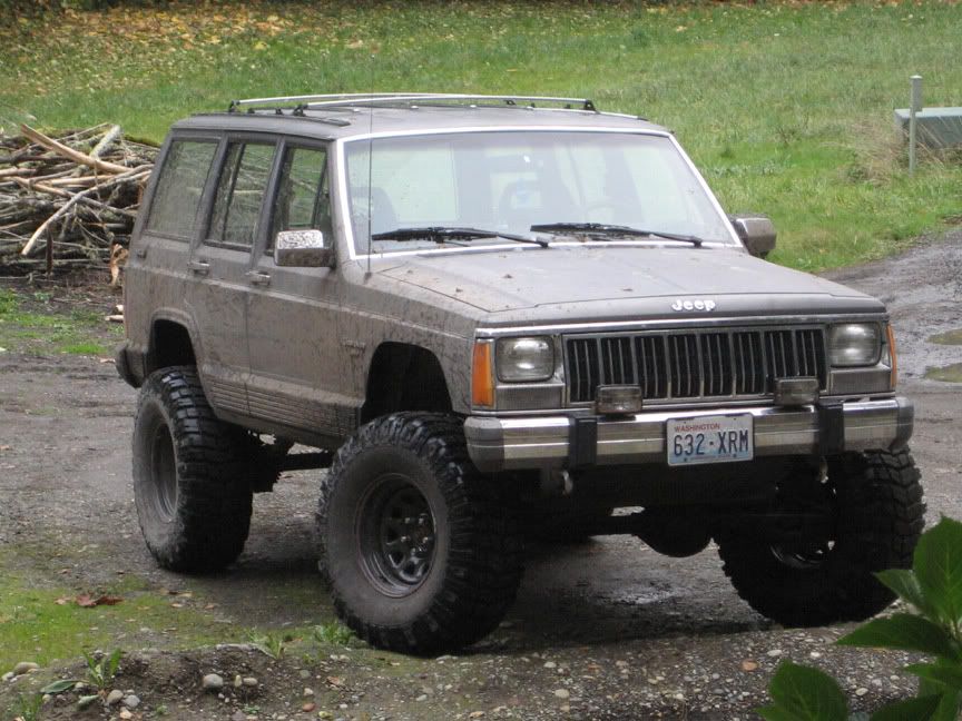

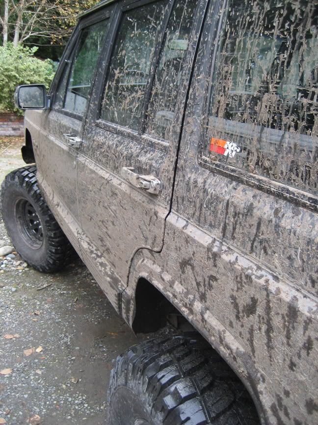

here's a few pics of my jeep that i just took. just showin off some mud from last night.
and i was wondering if anybody knew anything about these lower trim pieces. i stuck my hi-lift jack right there a while ago and it smooshed it. when you put rock sliders on, do you remove these? or can you? if my dad splits the cost of a welder with me, i wanna fab my own stuff, and might think about removing those guys and replacing them with something a little tougher. like steel. hopefully this pic is good enough.
-Sean

when you get rock sliders they will be attached below your rocker panels (the section that you bent w/ ur hi-lift jack). They attach to the uni-body "frame rails" and the pinch seems. I would recommend AJs Offroad Armor for those, also I would get the Super Rails or Square Rails, not the cheapest ones they have because the Supers/Squares will protect your doors also. Now if you wanted to do more extreme you can actually remove the stock rocker panels and install something like FormattFab.com has for their rocker replacements (which I am going to get). You can also build either of the two options listed above on your own but these are just ideas, to build your own I would look up EricsXJ's build on here. He fab'd his own and they are amazing.
I am going with the FormattFab.com rocker replacements because that price sounds good to me and my brother is dieing to work on the XJ with me, so if you can weld I'd personally suggest those. Though I haven't heard anything about them, their other products just look very well made.
