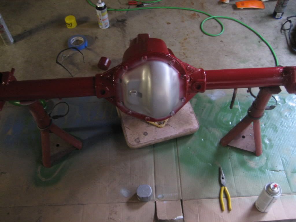

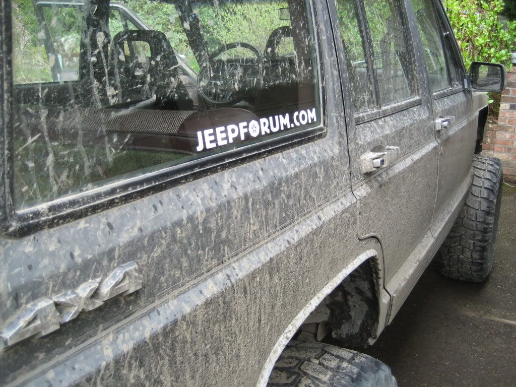

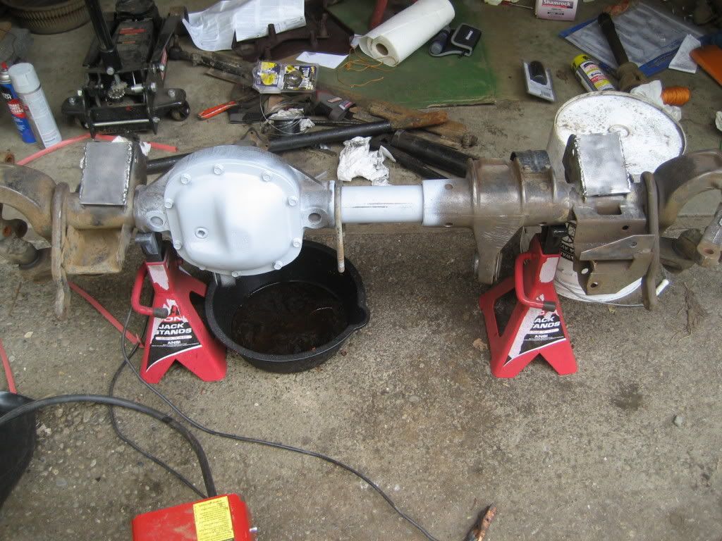

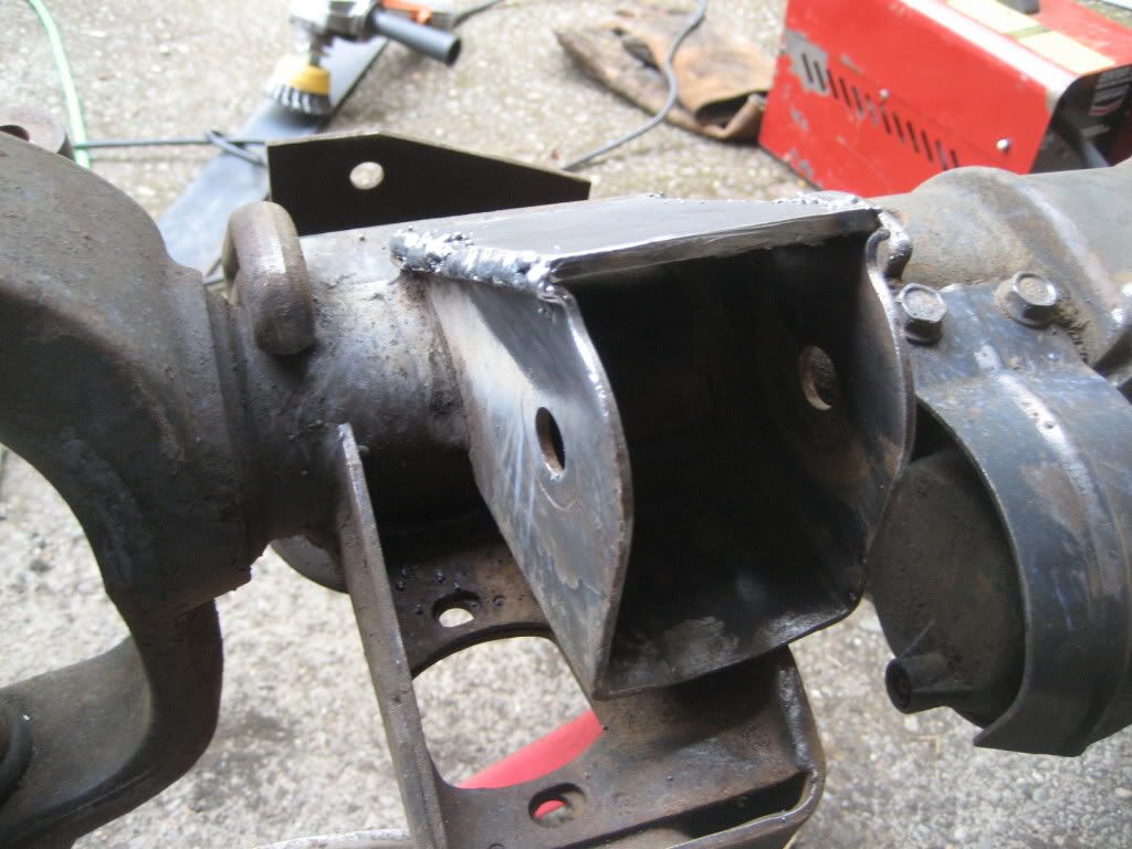

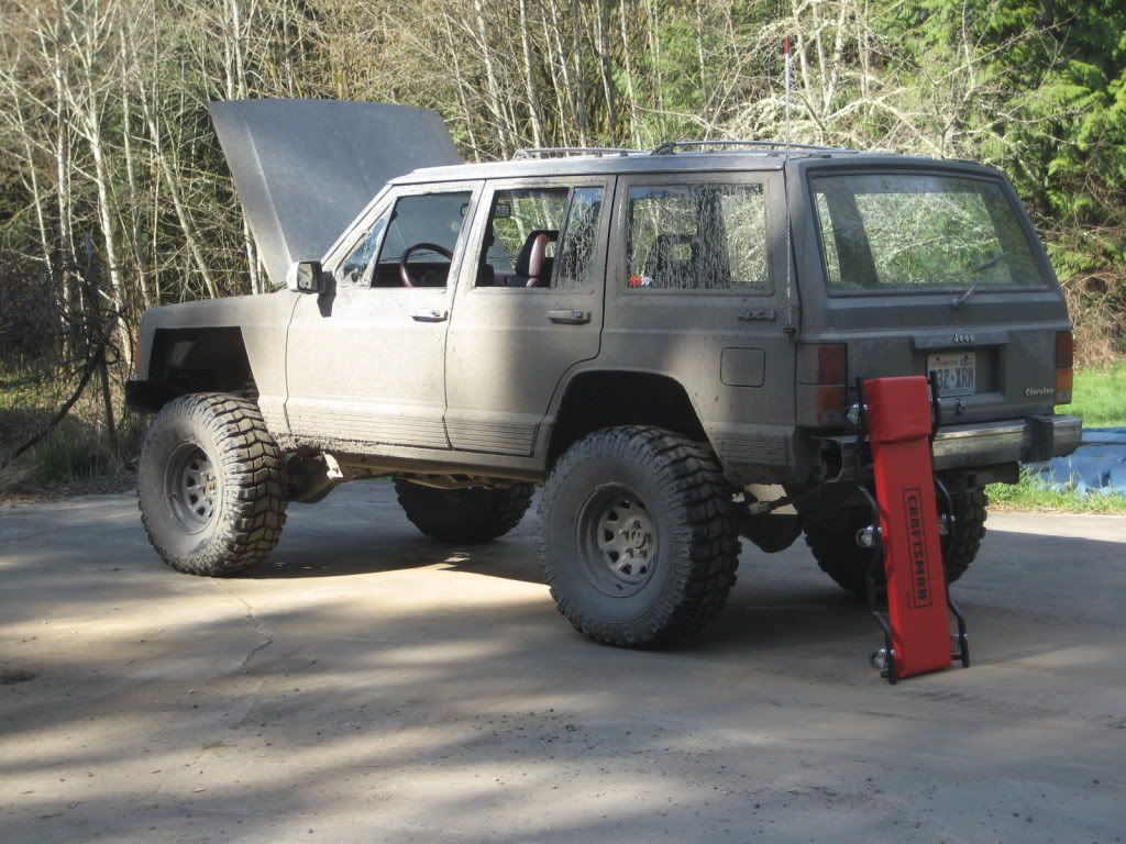

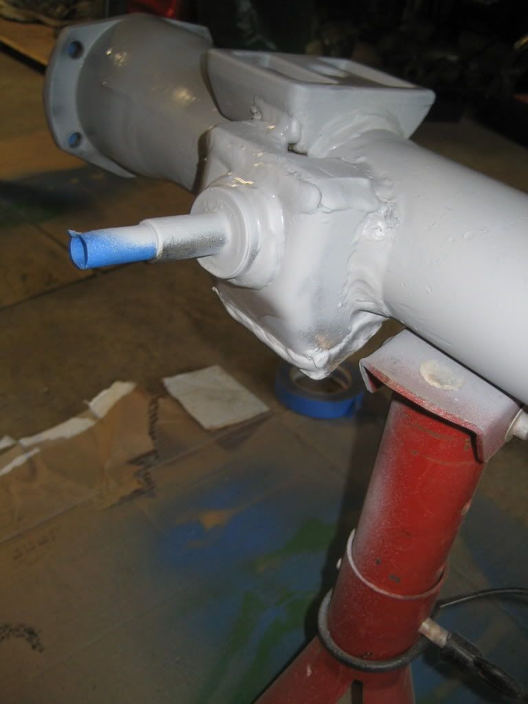

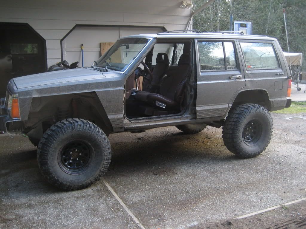

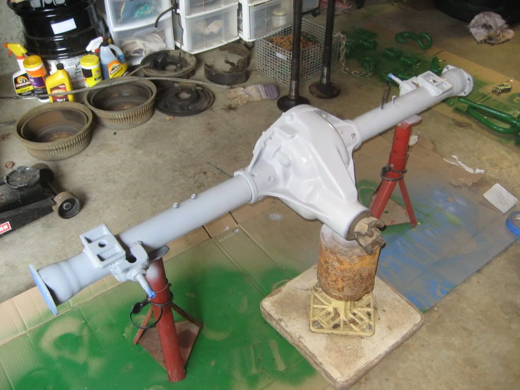

...im using the school computer to upload pics, so i have no idea how big these are gonna be. so bear with me... i have done the doorless mod upfront now. also made a cool recovery hook for the hitch. and i have a JeepForum sticker. the welds on the LCA skids are crappy because i now realize my friends mig sputters when feeding wire making it impossible to actually run a good bead. i am going to be grinding those welds down and bringing it to school to put some fat arc beads on there. the LCA skids are 3/16". front axle will be getting a small tubular truss between then diff and passenger side UCA mount, as well as a couple gussets on the LCA mounts, and a solid shaft swap (297x) with spicer 5-760x U joints and welded caps. the rear is going as is except for it will have a ford explorer/ZJ disc conversion on it. both axles get RuffStuff diff covers with 4.88:1 gears and the rear for sure is getting an Aussie not sure about the front yet. Yes, both axles will be that cherry red color with an aluminum colored cover. i might have the front sandblasted before paint because it has got some decent rust. here are the pics:
-Sean
