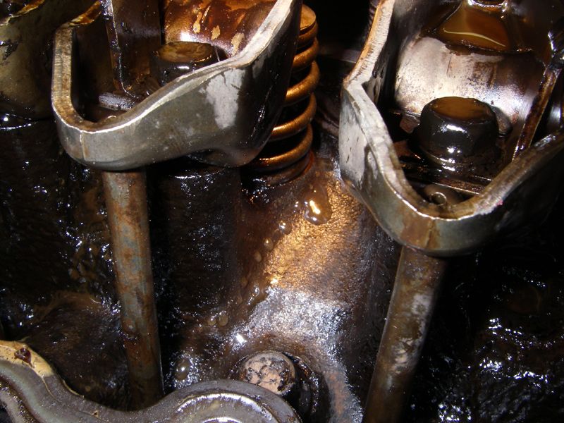

post #6 of 46 Old 10-24-2010, 03:52 PM Thread Starter
Kevin108
Location: Portsmouth
Posts: 3,951
I'm officially another victim of the 0331 head. Pics later.

post #10 of 46 Old 10-24-2010, 05:10 PM Thread Starter
Kevin108
Posts: 3,951
Weeping from a hairline crack at cylinder 4. 0331 FTL!
My build thread has pics again. http://www.jeepforum.com/forum/f177/kevin108s-2000-xj-build-867428/
