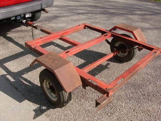

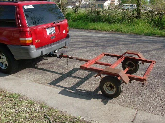

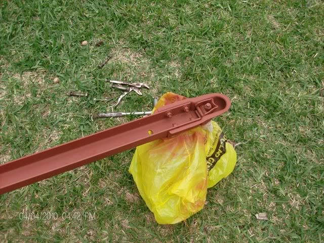

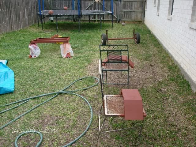

So about a month ago I pulled out a trailer from our back yard that was considered trash to my parents, and they got it for free from my uncle. and I decided to fix it up and get it going.
The bearings were locked up, it had a lot of surface rust on it, bolts needed oil, it was in pretty good shape besides that. It has no identification as to what brand it is so I had no idea what its capacity was or anything. Then one day I stumbled across a page on harbor freight and there it was! The license plate that was on it said '89, so it is kind of old! The original tires still hold air, so I am using them for now.
I soaked the bearings in diesel and cleaned them up, repacked them with grease, and got new bearing seals.
Then I took it for a test run!

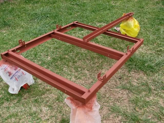

Then sanded and primed:

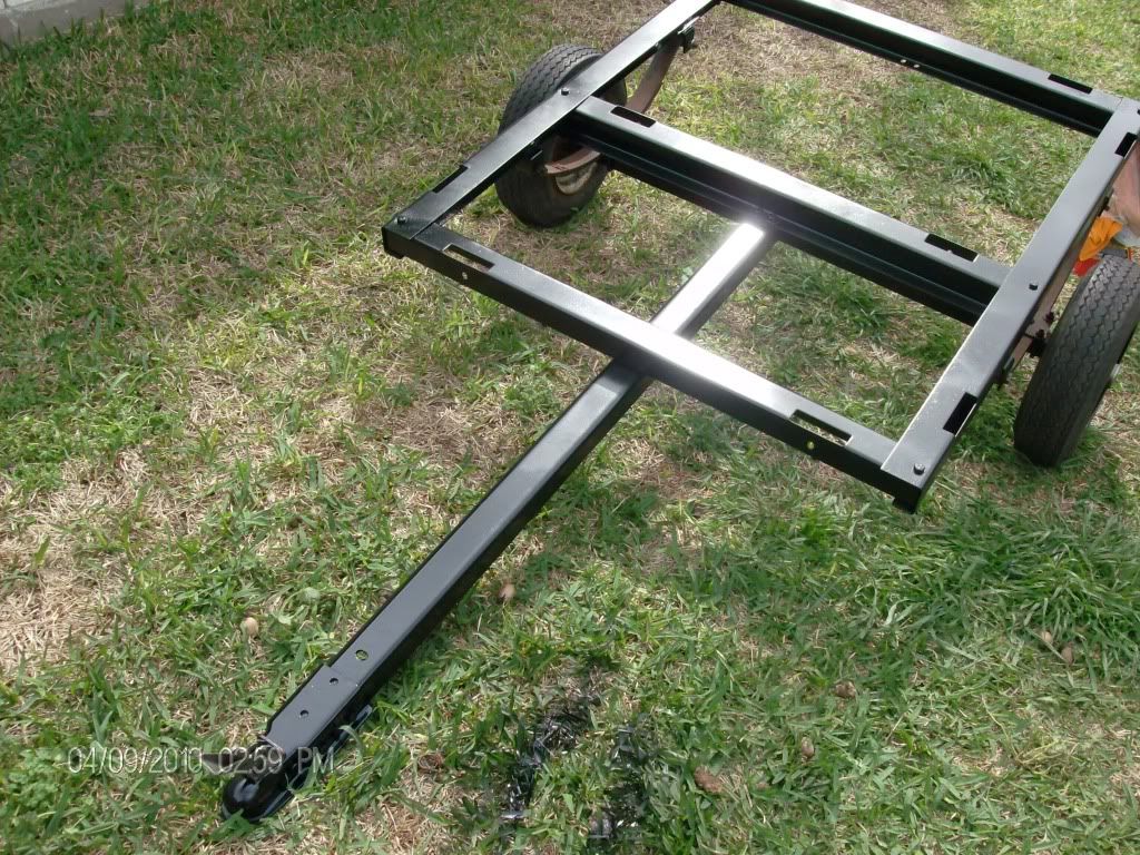

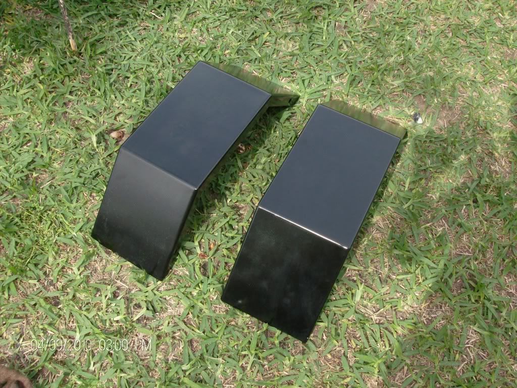

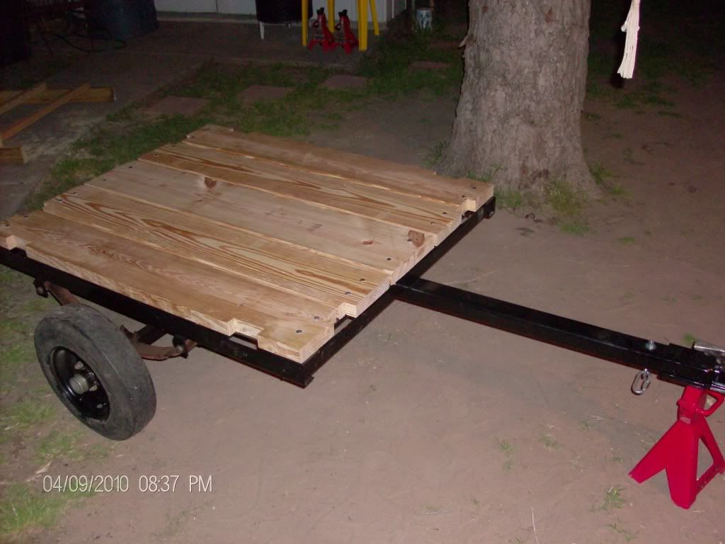

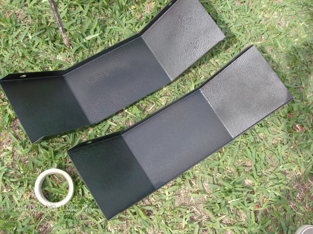

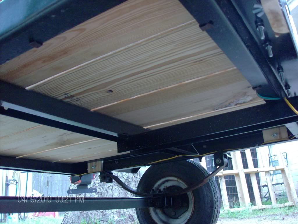

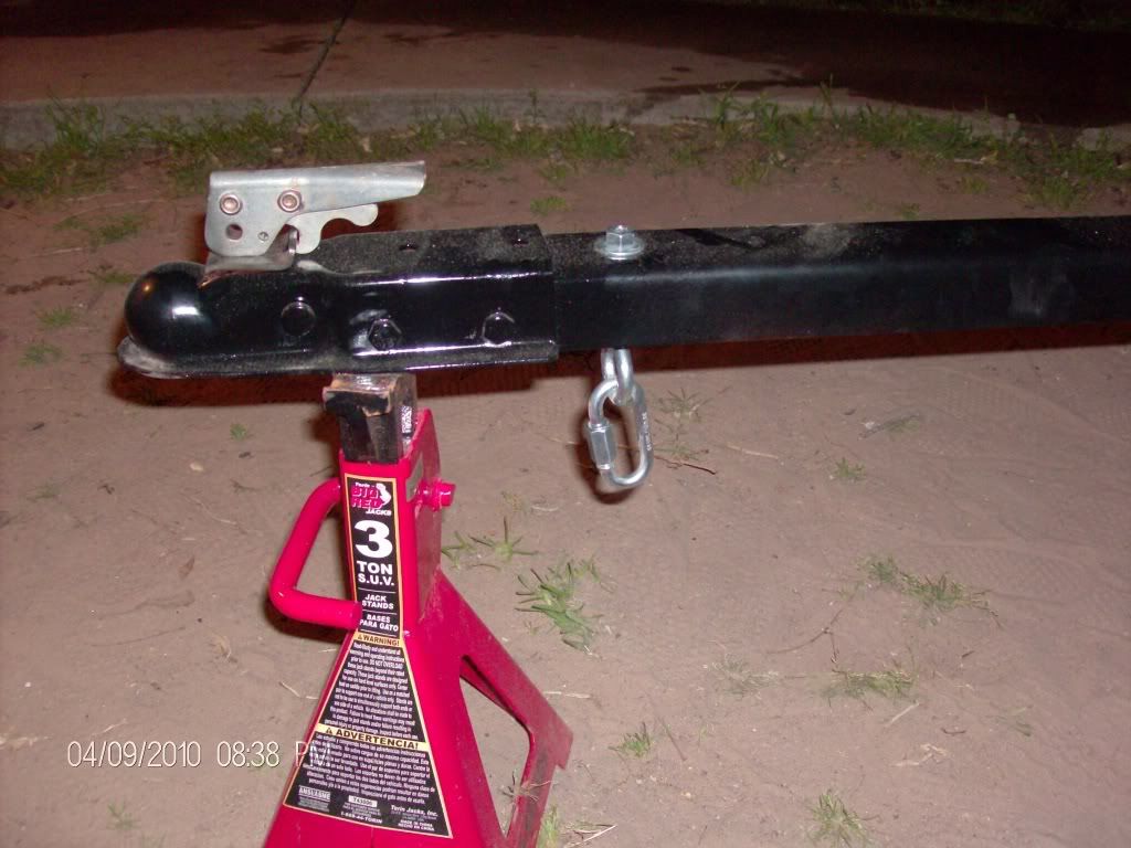

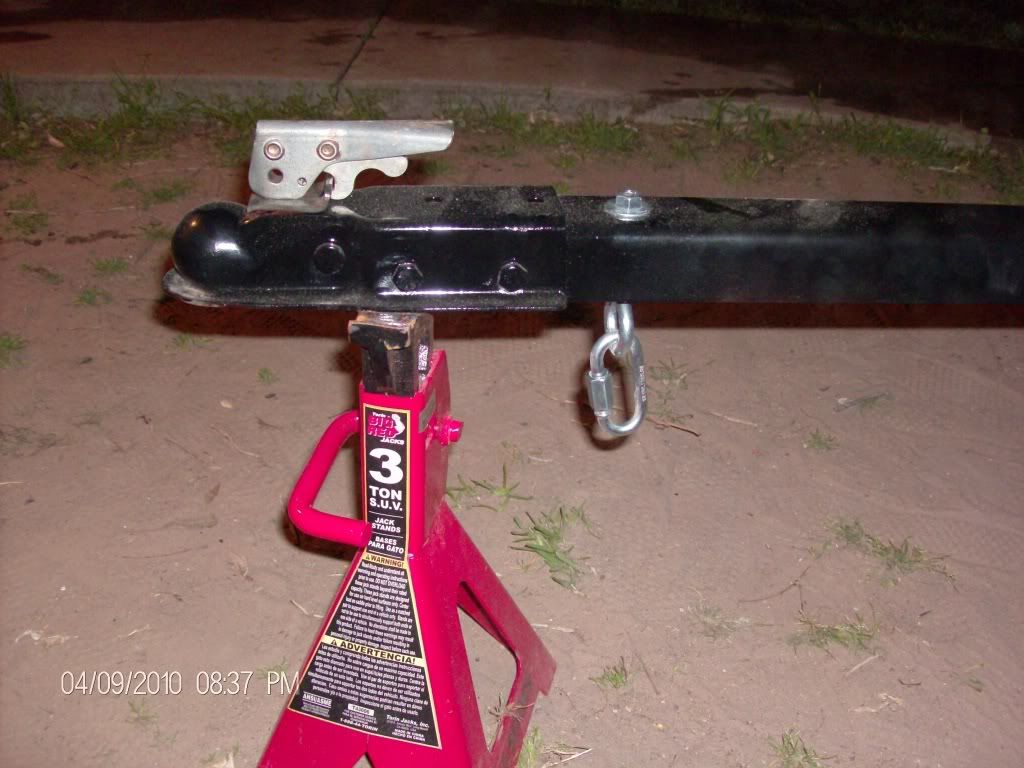

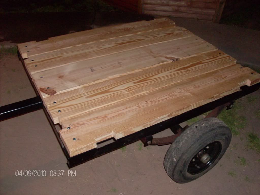

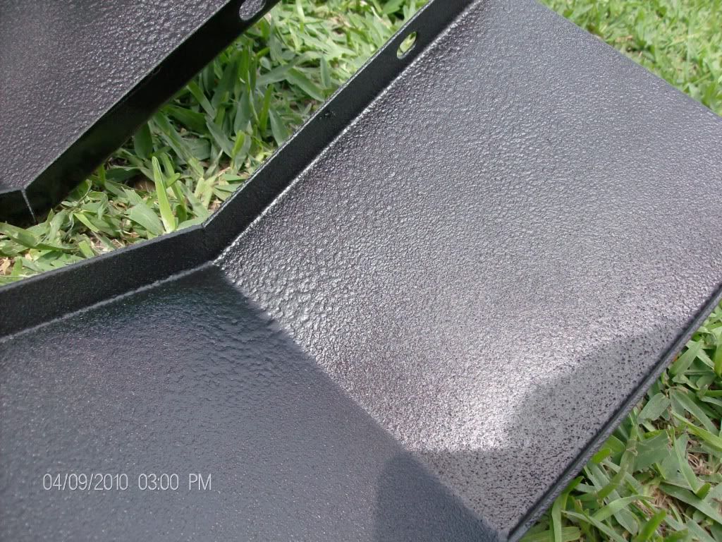

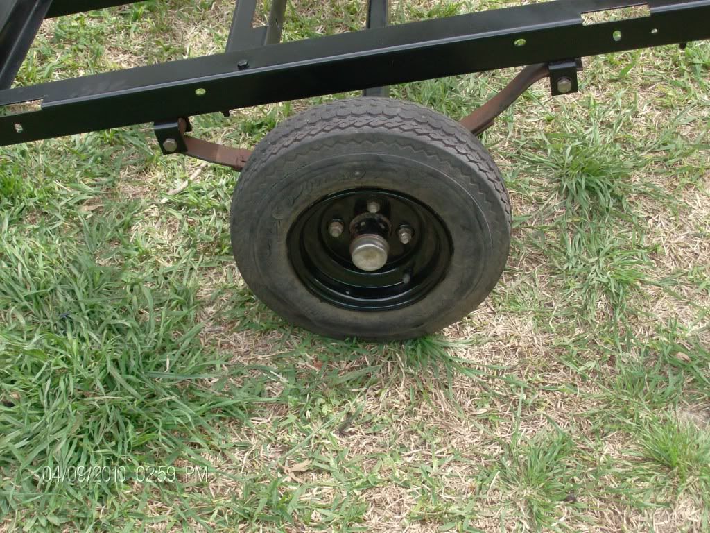

Well I can't make it out to my Uncle's place this weekend to do the welding, but I will have it done another weekend. This weekend I went ahead and did all the painting and will complete it this weekend as well, except for welding all joints. Got it painted and I also painted the wheels gloss black, and the underside of fenders with undercoating to protect from rocks and other debris, and just finished installing deck. I am going to be installing a bumper on the rear of the trailer, along with an 'A' frame tongue as well.
Here it is painted:
Here is how it sits:
(sorry for the big pictures)

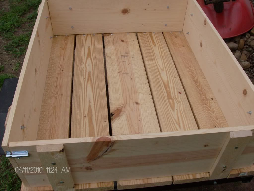

Alright I got the removable sides finished yesterday, it's coming out really nice. Most of the wood building on the trailer is finished, now just to add a rear bumper, lights, mud flaps, and maybe a few other things I can't think of right now.

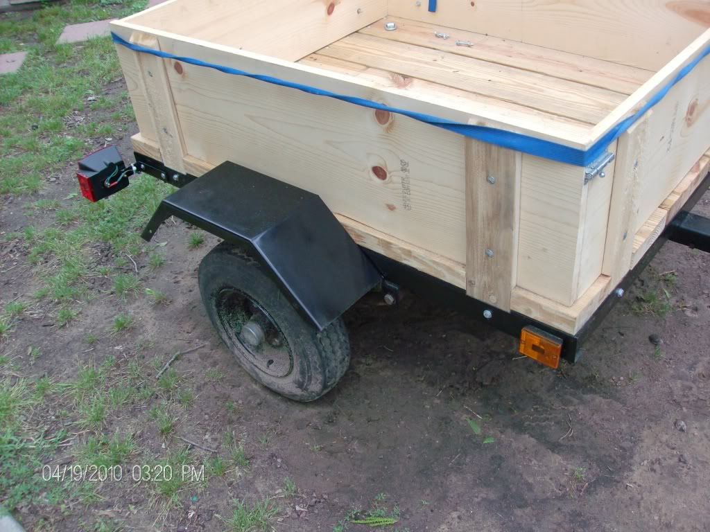

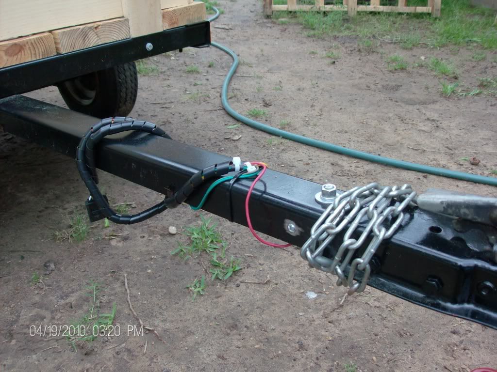

Alrighty, well this weekend I got my taillights and side markers installed along with the wiring for them, the license plate bracket, and I installed my safety chains.
(my wheels are dirty)
I accidentally left the trailer uncovered in the rain, and it being non-pressure treated wood, I need to let it dry out before I can seal it. I have a tie down strap around it so the wood doesn't warp while drying. So next weekend I am going to seal it with some stuff I bought.

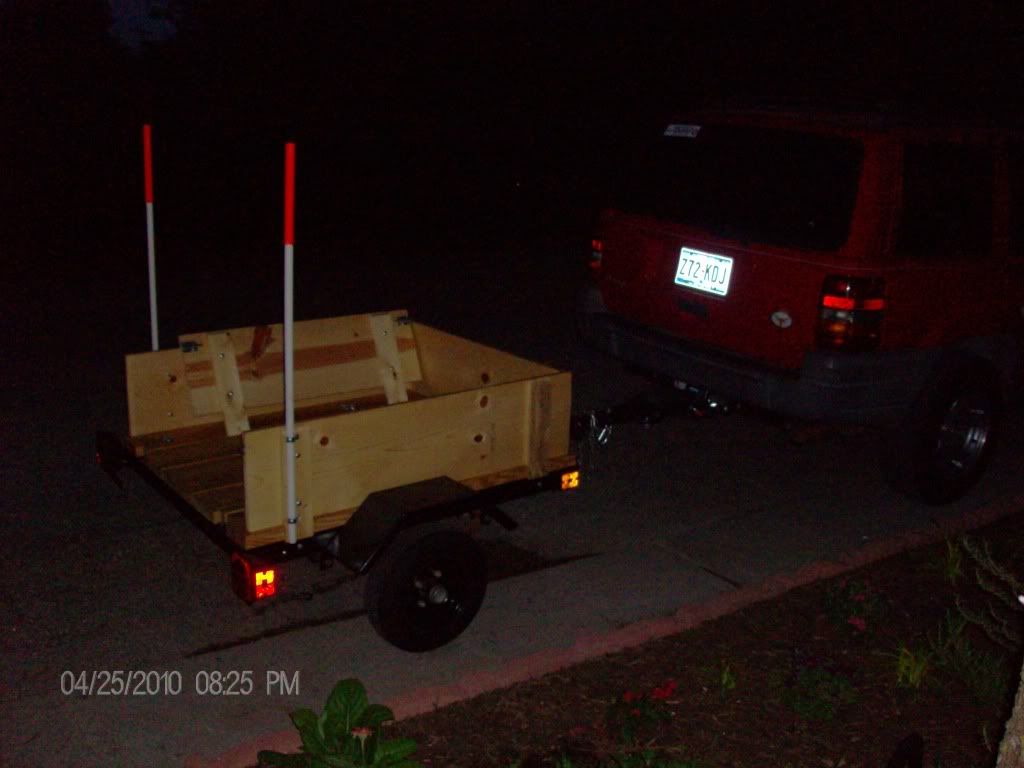

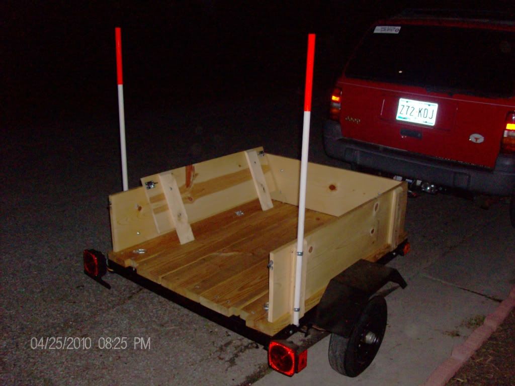

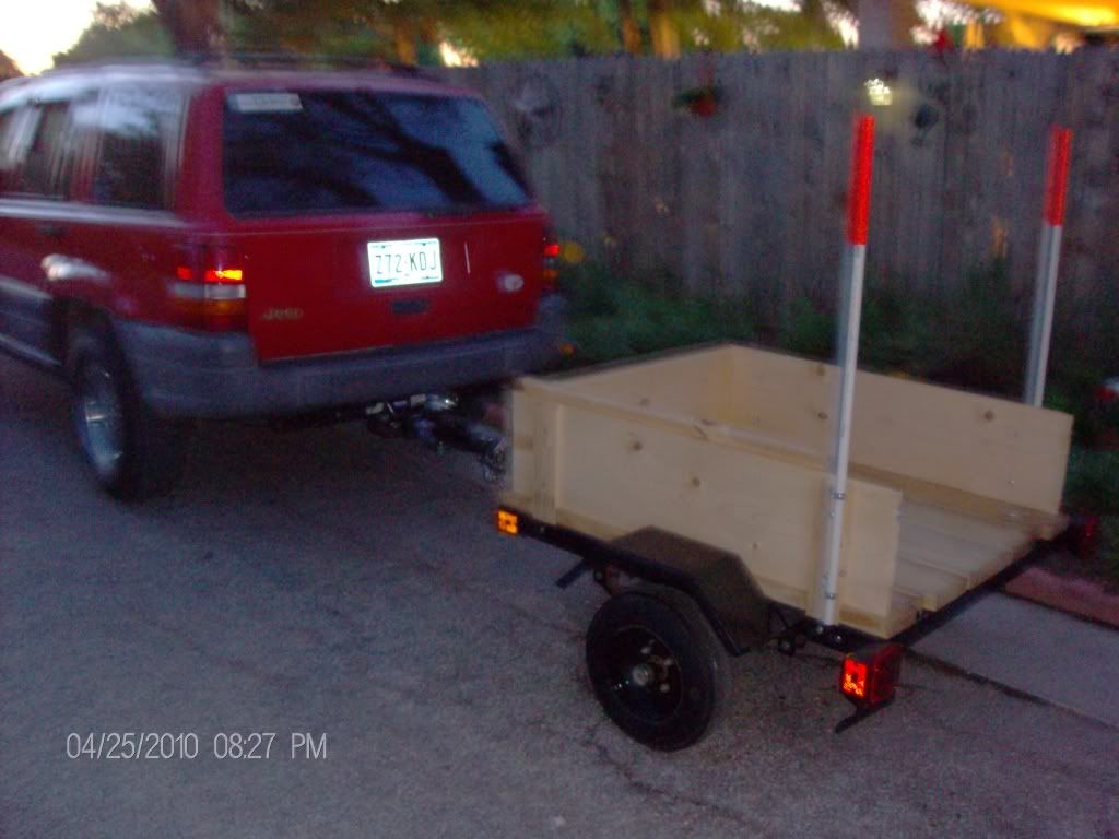

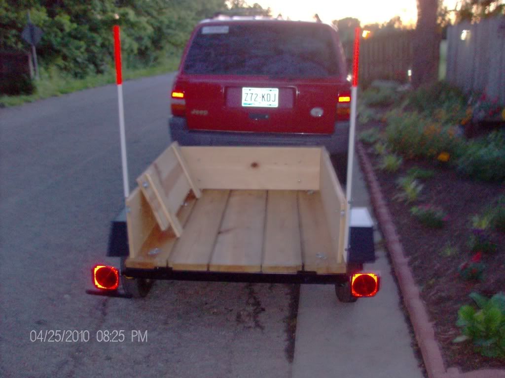

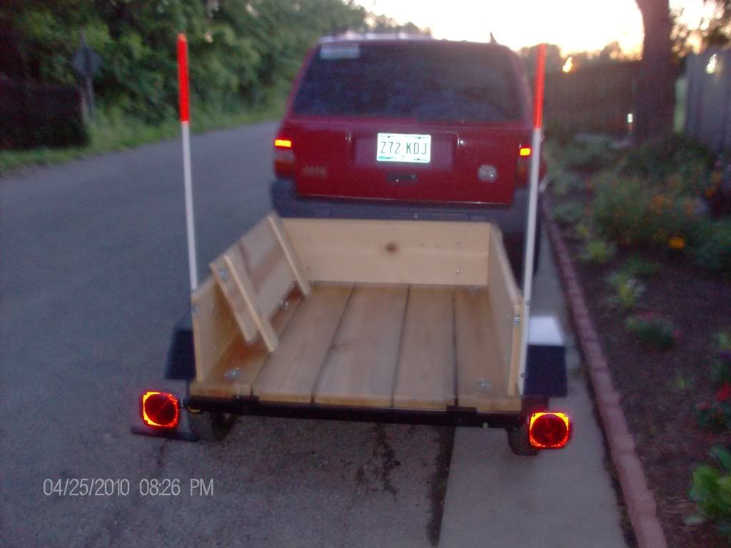

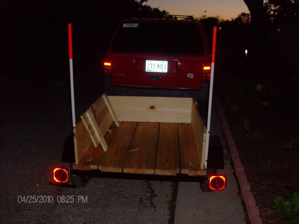

Over the weekend I coated the wood on the trailer with a sealer. I could not see my trailer behind me at all, so I had to make some marker poles. Now I can see it! I am going to mount a light on top of each pole so that I can see where my trailer is at night. Then I will just run the wiring down the pvc and connect the lights to running lights! I also shined the tires. (sorry for some blurry pictures, I was taking the pictures in the dark!)
