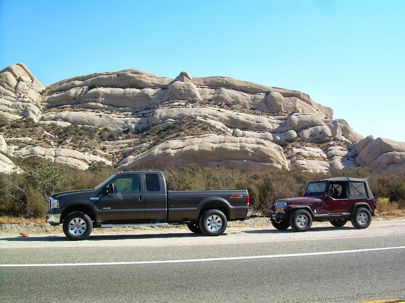

I guess I will close the loop on this thread. I have used the tow bar a couple of times now, and the Jeep tows beautifully behind my Superduty.
I used the Harbor Freight tow bar. It works just fine. No frills, but it is built solidly. You need to be on reasonably flat level ground to hitch up/off, because the bar has no slide adjustment. But I can do it by myself with minimal fuss.
As for swinging the bar upward, which was my original question, I've settled on simply using a couple of bungee cords. A couple, so if one breaks, I should find it before the thing falls. I needed something to prevent the bar from swinging up and banging on my hood, since I don't currently have a pushbar or winch plate. I drilled and installed a couple of bolts in the bar, put tennis balls over the bolt heads, and then filled the tennis balls with expanding foam. That all works great.
