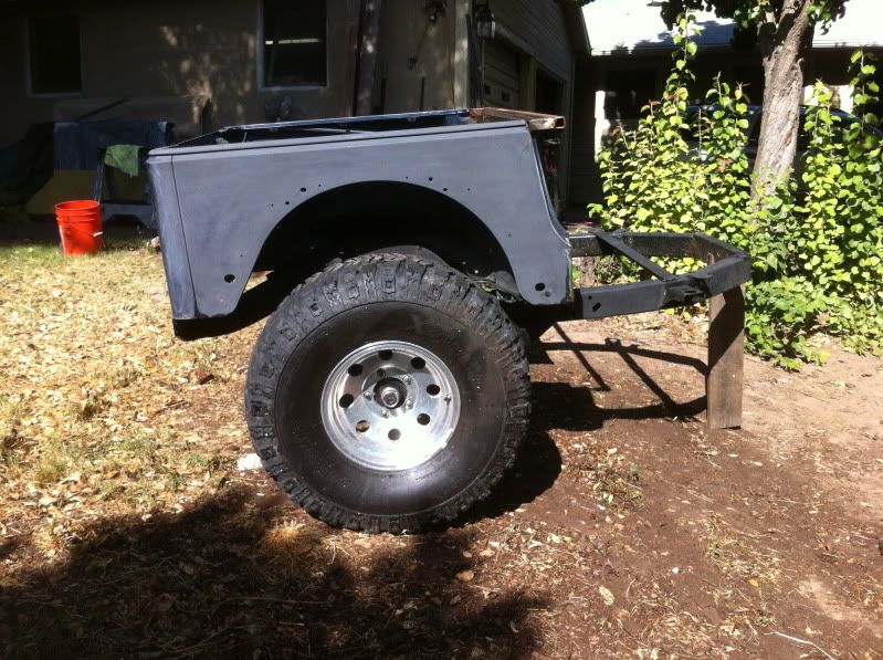

Well almost 8 months later, its time to revive this thread. The trailer had taken a back seat in my back yard since last year as I prepared for a Hemi swap in my LJ. Well the Hemi is done and now back to the trailer build. So today, I dusted off the axle, the brackets, and some other parts and started work.
I decided to use the brackets from the D-35 for the trailer axle. I couldn't see spending $200ish for brackets that were not really gonna take much load. No torque from a motor, no braking, no steering, just some bouncing and maybe 1,500 lbs.
Now no safety speeches about the shorts!
The old brackets went on fairly well with a bit of grinding due to a poor cut job with the torch when I removed them from the old axle.
Got the tires mounted on some matching wheels to what are on the jeep. I went with 15x8's to tuck them in a bit and to keep them seated, no beadlocks for the trailer.
Well after almost 8 months sitting on the ground, its back on its feet with new shoes.
So now the next step, I'm not sure what springs to run. My jeep sits on RE 5.5"ers and had thought about using the 4.5" ones I have laying around. But after setting it back down today with the tires on it, I'm not sure if I really need that much lift. I figure it's not going to articulate too much and I don't really want that much weight that high. I may try the stockers until I get the tub put back on and see if I run into clearance issues with the tires. Maybe just a 1" body lift would be enough.

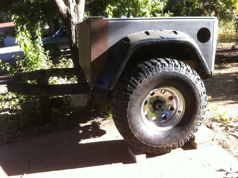

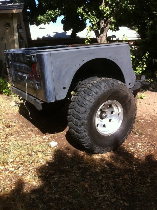

Well I got a little bit done today, test fit the tub with the 35's and stock suspension. So far I'm not sure I need to lift it at all. Guess I'll know more when I start adding weight.
I then test fit the new front cap and some old BW flairs. I'm thinking its gonna work. Still trying to locate a cheap used pair of rear corner guards and then It'll be time to finish the hitch and look for a front box.
I'm still not too sure how I want to run the fuel line off the pump yet. I'm going to use the factory filler, but where to hide 10' of hose for refueling my ride is another issue. I may end up having to use a quick disconnect and store the hose.

Looks great, I love the how good the TJ tubs match ! Just finished my trailer build a few weeks ago can't wait to get it off the pavement

Looking really good. I like the idea of the fuel storage. Tractor supply sells a good selection of fuel transfer related items. Maybe a fuel nozzle on a hose reel? They also have the quick disconnects I think.
Edit: I forgot to ask why you needed 10' of hose for the fuel transfer? You can jackknife the trailer to close the distance to a few feet. This will save some money (and space in storage) on the hose.
