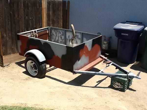

After researching on the net and talking to lots of others. I started looking on craigslist for a basic start trailer. Looking doesn’t cost anything. There were trailers that were awesome, but out of my price range, and others that were just crap or more work than it was worth. Until one day by chance, there was a guy who started building a trailer for his motor bike and then stopped. It needs work, a new 3500# axle, hubs 5X4.5”, new leaf springs, the floor is missing, wires/lights, and redesign the trailer tongue. The trailer is 4’X6’ with 21” walls. I really wanted a (4’x5’), but this will work. The frame was made out of 2X2X1/8th” square tubing, and the walls were sheet metal with 1X1 square tubing for wall frame. Made a deal and picked up the project for $150.00. This was cheaper and easier than I could have built it, to this point.

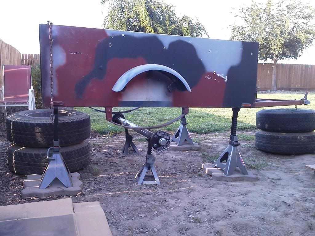

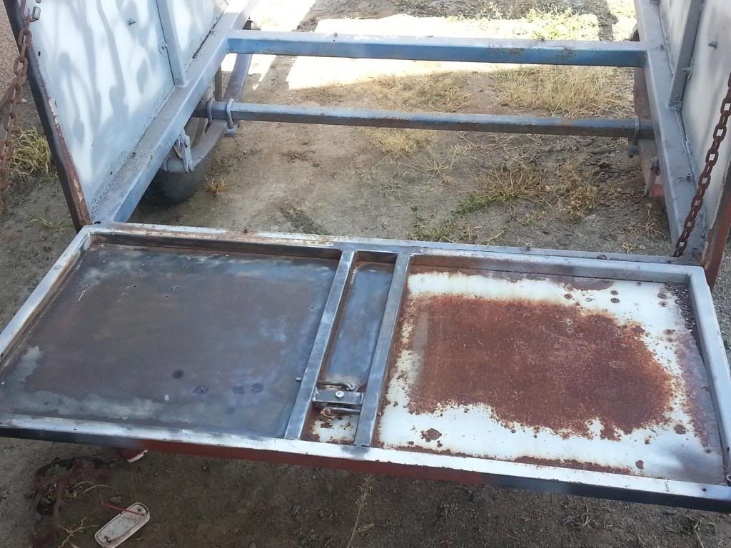

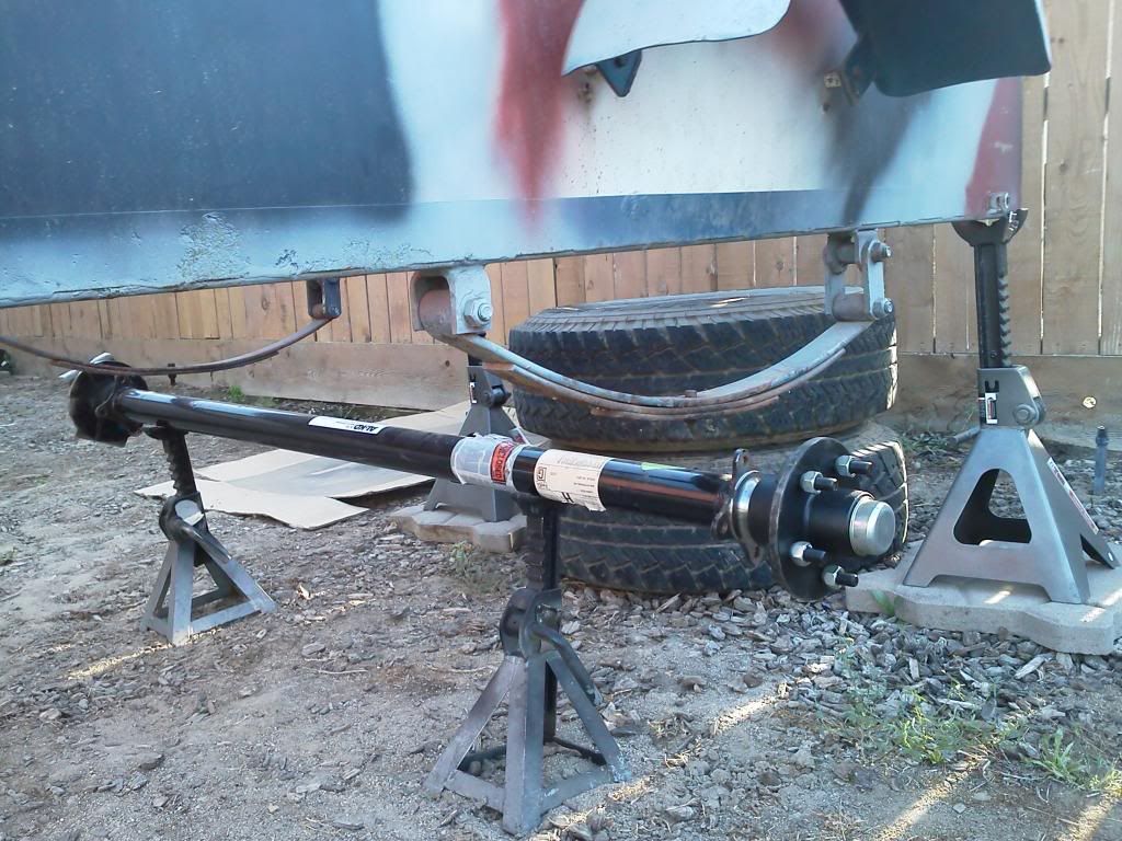

Since the purchase of this trailer, I replaced the old axle, with a 3500# axle, 61” face to face, and hubs to match the jeeps wheel pattern, 5 on 4.5". Also, it had surface rust from sitting outside, and a wire wheel took quick care of that. New 27” 4 leaf springs, U-bolts, and hangers, have been ordered to mount it all together. The trailer tongue will be changed from an A frame style to a stinger style. This way I can turn a 90, when needed. Also, the original tongue design is welded directly to the outside front of the frame. I want to have the new stinger (3x3x3/16th”) tie into the trailer frame in 2 places. All of this will take some time to get all the pieces together. As the parts come in and money allows, more will happen. I’m hoping to have the trailer finished and painted for under $800.00. So far I’m at $375.00, and doing as much myself as I can to save funds.

As far as tires, this trailer will start off with hand me downs (31x10.5’s). As my 33’s wear down and I get 35’s then the trailer will get the old 33’s, although that is way down the road. Wheels will get the same as the Jeep has 15x8 with 3.75 off set, this way they will all match.
I’ll keep posting as things are completed. Also, I’m open to ideas and can make adjustments for better ideas, as needed.

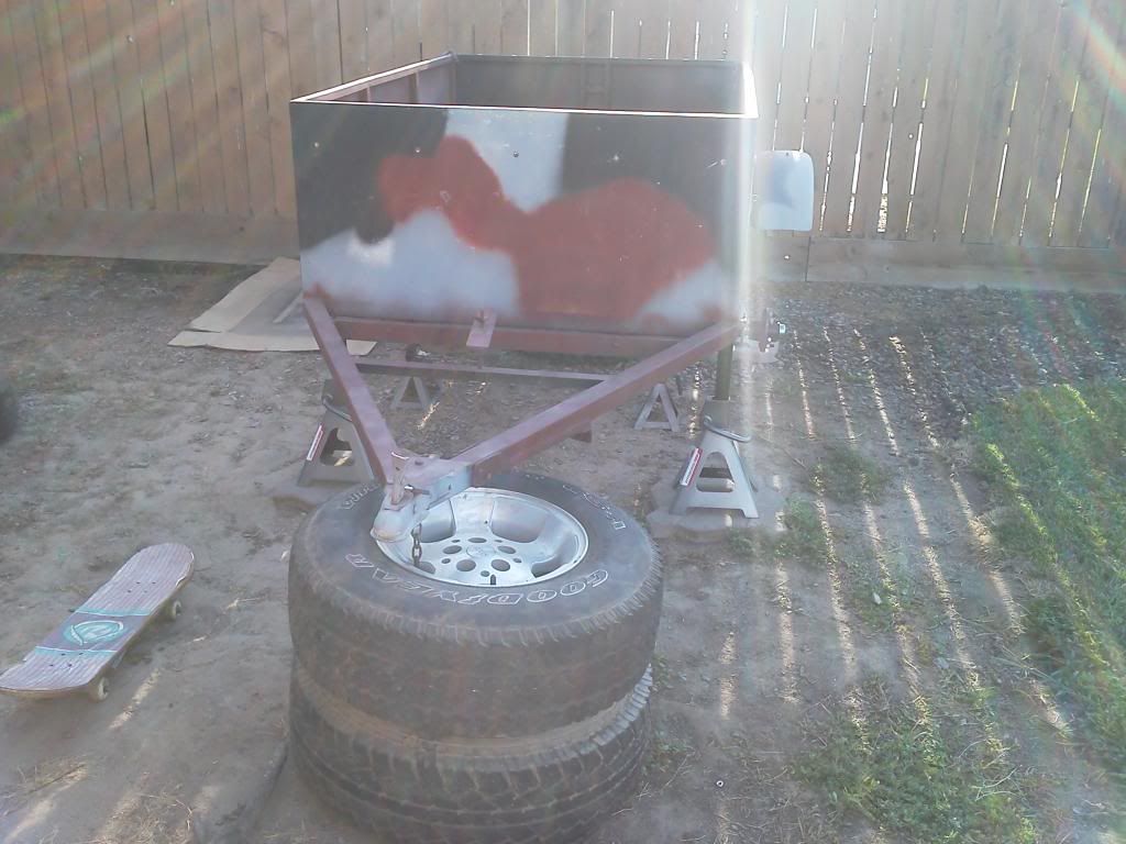

The only reason for rebuilding the trailer tongue is to make it safer and a better turning radius.

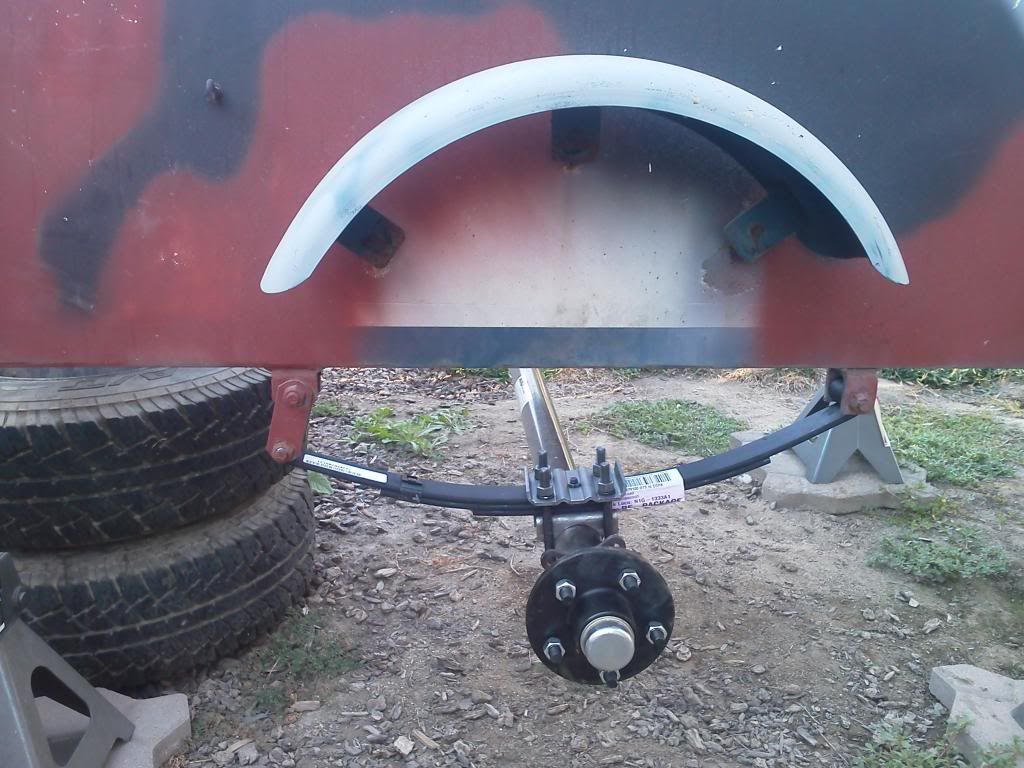

Got in the springs and mounting kit in last week and did a rough bolt in tonight to see how it will look.
Would have done it sooner but took the family camping this last weekend. A buddy of mine let me barrow his military trailer. Using his trailer for dimensions. The jeep pulled it great. The new gears are paying off. Woo hoo!!!!!

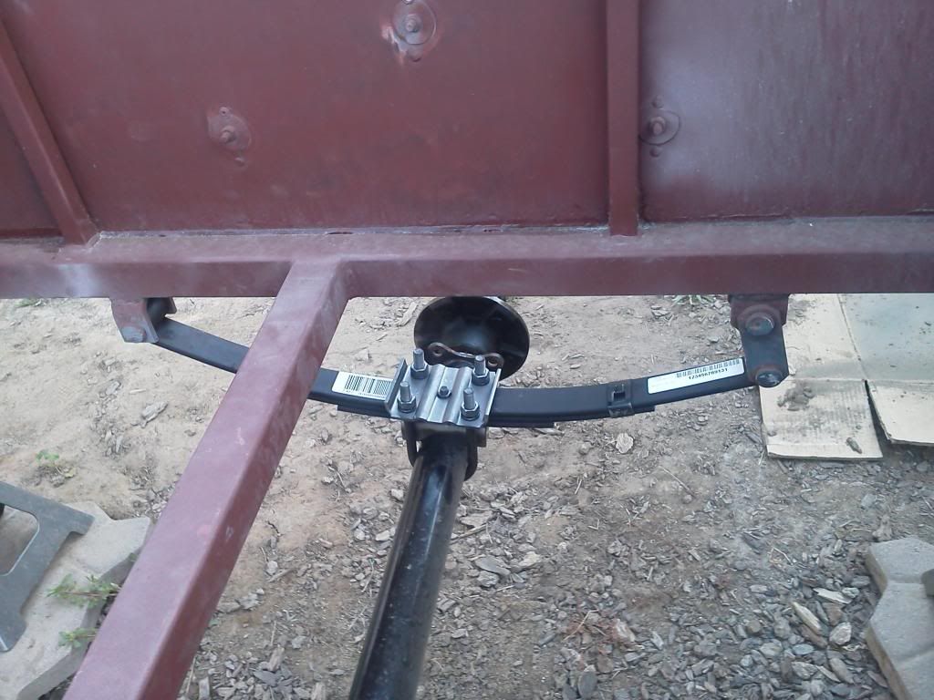

Was able to take the time to mock up with the springs and axle.
I have made up my mind that I will be getting some new spring hangers. Using the Military trail as a guide for dimensions, I want to move the axle forward about 2". This way it will trail approx. the same way the other trailer did. My buddies trailer was violated with a tape measure for about an hour, so I could take as many notes as possible.

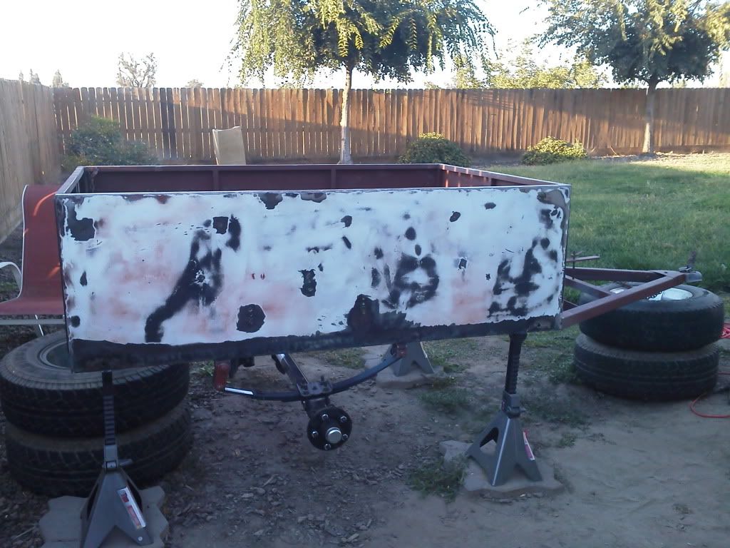

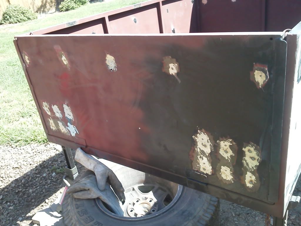

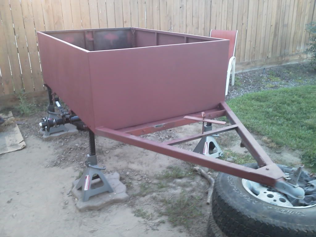

Well today was awesome, my buddy was generous enough to let me barrow a small welder. It is great for sheet metal work.
Yesterday was able to sand the trailer down so i could look for surface rust. In the areas I found it I sanded down to metal cleaned it up. Other parts of the trailer I made it through the 3 layers of paint until the last layer was transparent enough to see what I was dealing with. Surprisingly, not a lot of surface rust. So went on to welding up all the lil holes that was drilled into the sides for what ever reason.
So after filling almost 60 small holes and setting a couple of things on fire. I found pin holes in about 15 of welds. So I went back and welded over those again. Not bad for a rookie, at least thats what i thought.
Did some basic body work, and then covered the spotted cow look with one solid color. Here are some pics with where I am at now.
