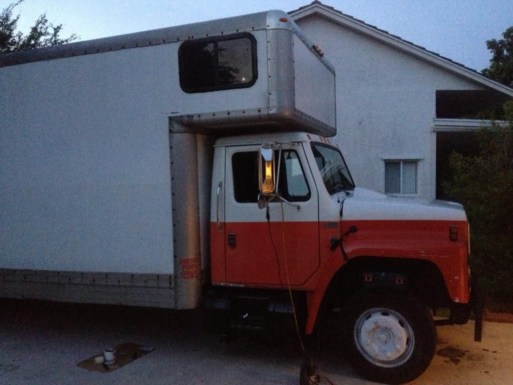

A little more progress this weekend... bunk window installed and ramps on the wheel wells...
ramps to assist on getting up over the wheel wells... threshold ramp cut in half from lowes...

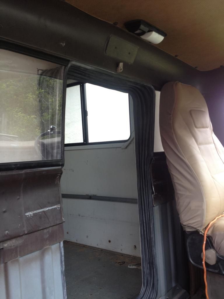

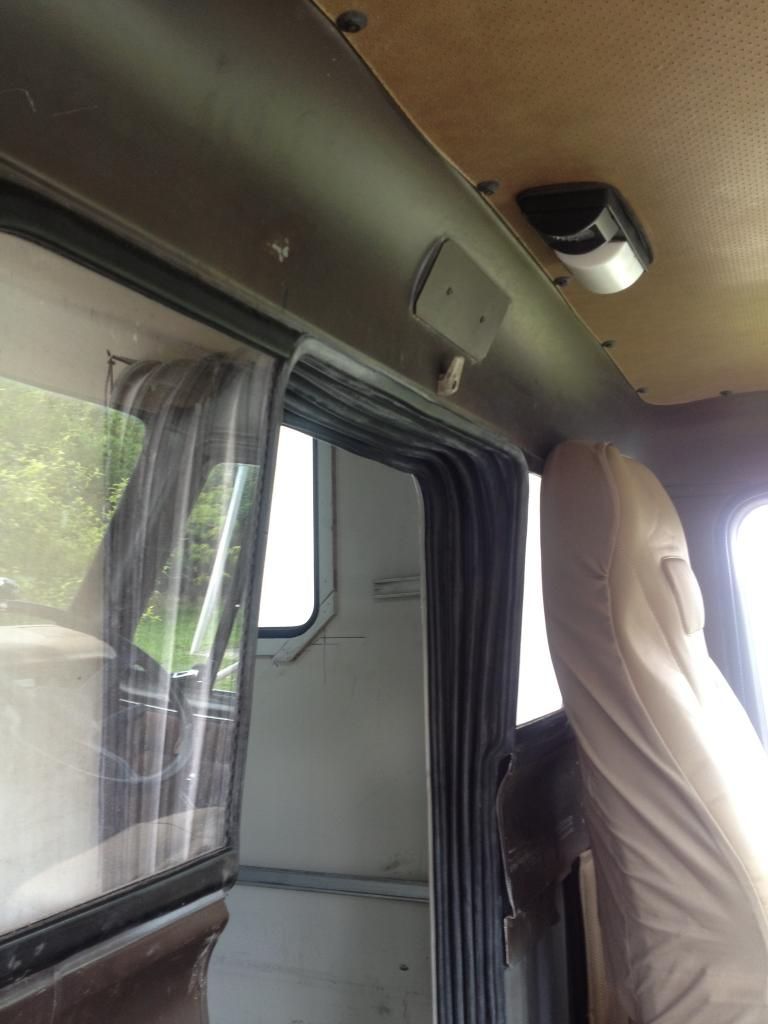

Got the last two windows in the front half of the toter... also chased down one of those intermittent issues with the rough start... turns out the pos lead from the starter to the Glow plug controler (relay) was poor. New fitting and she starts right up! Also here are some close up s of the passageway betwteen the cab and the box... forgat but someone asked to see it?
note the ripped 1" by so I panel up to the window...
and the second widow up in the loft...
and after a hot day... cooling off with my best helper... Helen!

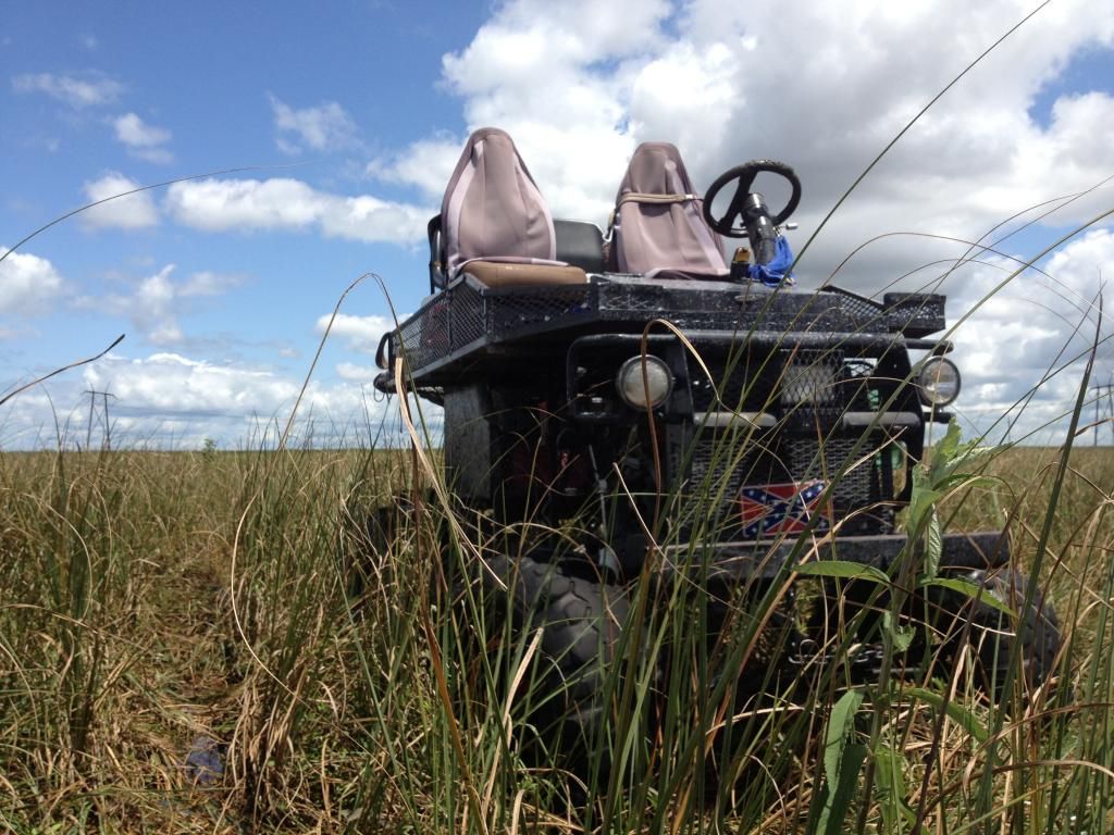

not much else this weekend... went out to the everglades on the buggy!

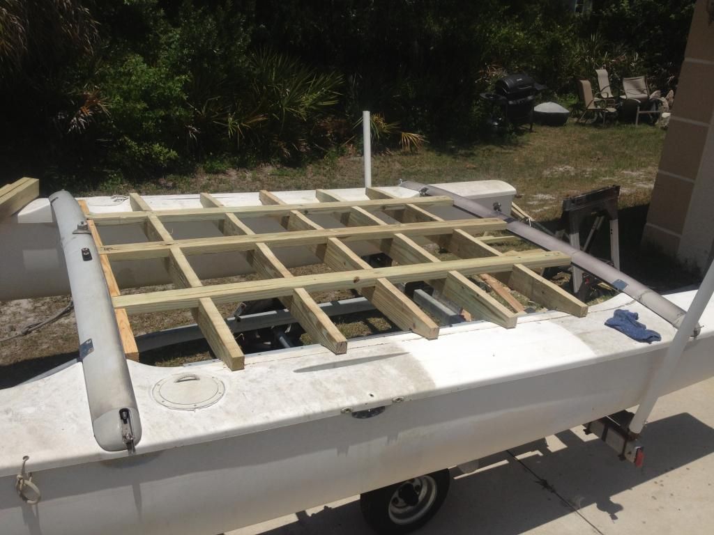

Crazy weekend with my brother over on the gulfcoast... redneck engineering / recycling an 18' hobie we picked up for $150 with a trailer
after a good bath we decked her over with PT stringers and decked her with PC corragate hurrincaine shutters... snagged a leaning post that came of a neighbors trashed boat... and a 1980 Johnson 15 HP on loan...
Wet Kitty is born... 9" draft 25 MPH and the ultimate sandbar cruiser...
