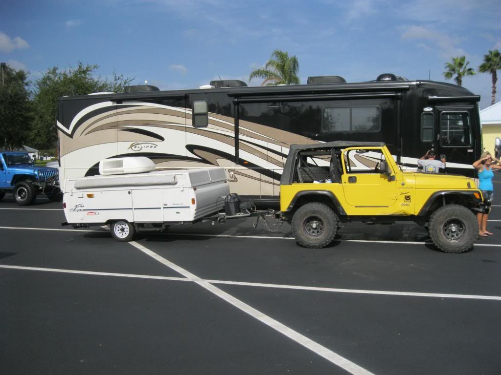

I tow my fleetwood popup around behind my TJ.. its about 2300lb dry. Now that I am regeared its fine, before it was a little rough in the hills with 3.73s. I have no issue with sway or anything like that though and have towed it thousands of miles. I still haven't gotten around to doing a brake controller though, it is definitely necessary IMO, I just haven't done it.
