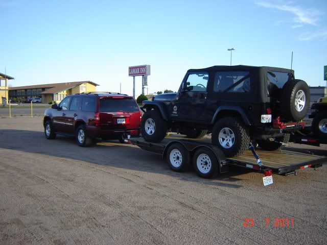

My PJ trailer came with D-rings in the front, and nothing in the rear. So, I use the stake pockets with a chain in the rear, and ratchet straps up front. They are sturdy stake pockets, and have held up just fine. I have since switched to tieing at the axles. (for the axle vs. chassis debate crowd.)
