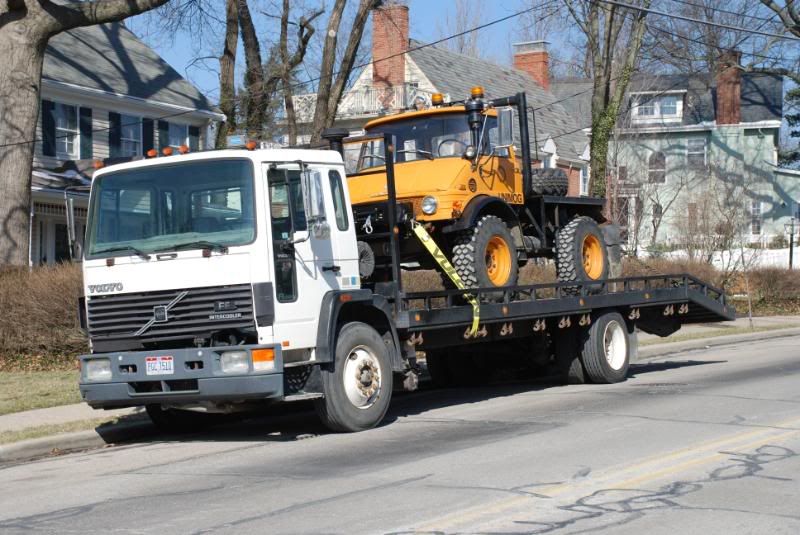

Don't be concerned about the sway. That is a function of load balancing. My F250's always swayed if the load was a bit rearward. Of course, the heavier rigs like my current K2500 Burb or an Excursion, or certainly a DRW rig will usually not sway much even with a somewhat poorly balanced load. Frankly, that is why many contractors buy DWR, not for the total load as much as being able to put a Bobcat or equivalent on the back end of a trailer or generally be unbalanced.
I think that route from your place to Attica was not much of a test since it is all level or nearly level. And, you may not need a dedicated tow rig, but if you do decide to go for a dedicated tow rig, please consider a real truck as opposed to a pickup and trailer. I trailed my rigs for decades before I built my Volvo FE. With full air brakes, DRW and Cat motor, it is a whole different experience. And you won't need a 33,000 GVWR rig like I chose, you can get a nice Isuzu NPR flatbed or equivalent which you will find is 100 times better than a HD pick up and trailer. And for half the price. And, better mileage. You just need to make some ramps. Trust me on this.
Here is a photo of my rig which I bought for $3500 before modifications:
03 Rubicon; 99 xj with too much stuff to list; Unimog 406 (gone)

I get 12 mpg loaded. Never checked it unloaded. My 454 Burb gets 5-7 loaded. But the Volvo will run down the road at 70mph as quiet as a sedan because the engine is in the rear. Its a big rig, way beyond what is needed for a Jeep or even two. If you do get a big one, be sure to register it as 25,999 GVWR so you don't need a CDL.

No, not really. Its complicated, but the Volvo weighs around 12,000 pounds, so I can load 14,000 of cargo on it. My Unimog weighs about 9200 as configured and my Jeep XJ around 4500, so even with some extra gear I am under the 26,000 pounds. The deck is 32' so I can't really get three (3) Wranglers on it, but with two on it, I can put a bunch of quads and stuff. Nothing has to be balanced. It rides great no matter what is where.
I added an 8000lb winch to the headboard of the Volvo to drag dead rigs up on the bed. Tool chest, spare battery. Flood lights on the bed. And a line of 4" strap winches on each side for tie downs. A 36" winch handle makes tie downs secure. There is an air bag rear axle with dash control to drop the rear a bit when loading less capable rigs that have trouble with the ramps. A nice stereo, CB and ice cold a/c makes the whole process a dream.
wilson1010 is offline
