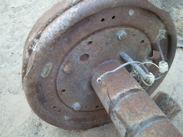

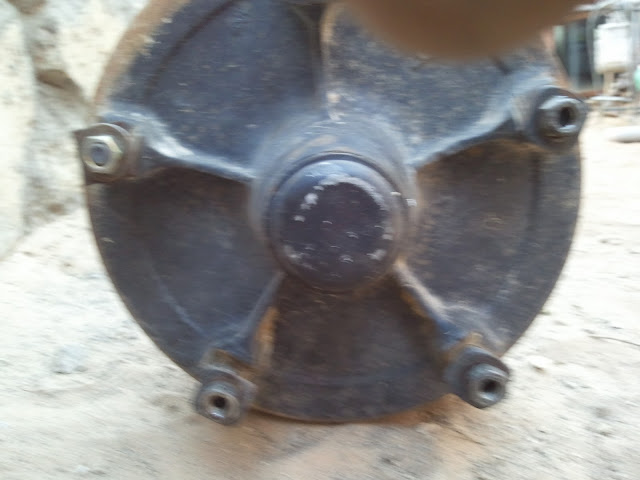

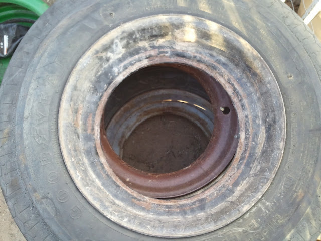

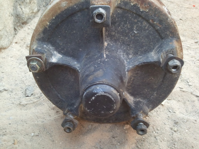

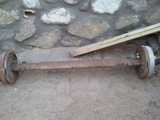

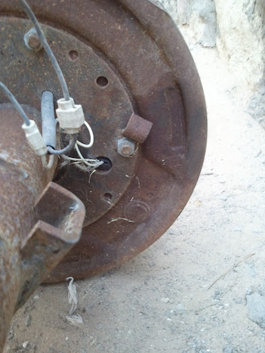

Well someone from the local offroaders was giving away a heavy duty trailer axle and I was the first one to reply to his thread so I came home with this today.
I can't find any tags or any markings on the axle. As you can see the wheels are a little odd with an even odder 14.5" diameter.
The PO said when he took it to a trailer shop the shop owner said it was rated at about 5700 lbs.
If anyone has any insight on this axle let me know!

I could be wrong, but I think that came from a trailer home or pre-manufactured home. Typically not the best axle. Getting 14.5" tires is only one issue with them. Good thing you got it for free.

It is a mobile home axle, that MH after the tire size stands for mobil home. In my opinion it would be best to pass on using this axle and get a different one. Reason is, getting parts may be a pain if something should go wrong while your on a trip. A newer axle will give you better tire options and parts availability also. Check with these guys for trailer axle and suspension parts Redneck Trailer Supplies

that is the only size of tire available though... so for an expedition style trailer it's going to be hard to get it up off the ground... they work great for car trailers or other low riding trailers though...

It might be possible to use this axle if you could change the hub/drum to one that would work with a different wheel? You'd just have to see if someone sells a different style hub/drum that will fit that spindle. Redneck trailer parts may be able to tell you if a drum is available to do that? Good Luck

Ditto. that's a mobile home axle.
I think the MH after the tire size means "mobile home"
Looks like the axle has been shortened too.

Yup. Mobile home axle. We run them on one of our trailers. Parts aren't that hard to find. Be biggest drawback is the lack of tires. 14.5" is the only rim/tire made for them. They're not as cheap as other tires, but they work fine.
